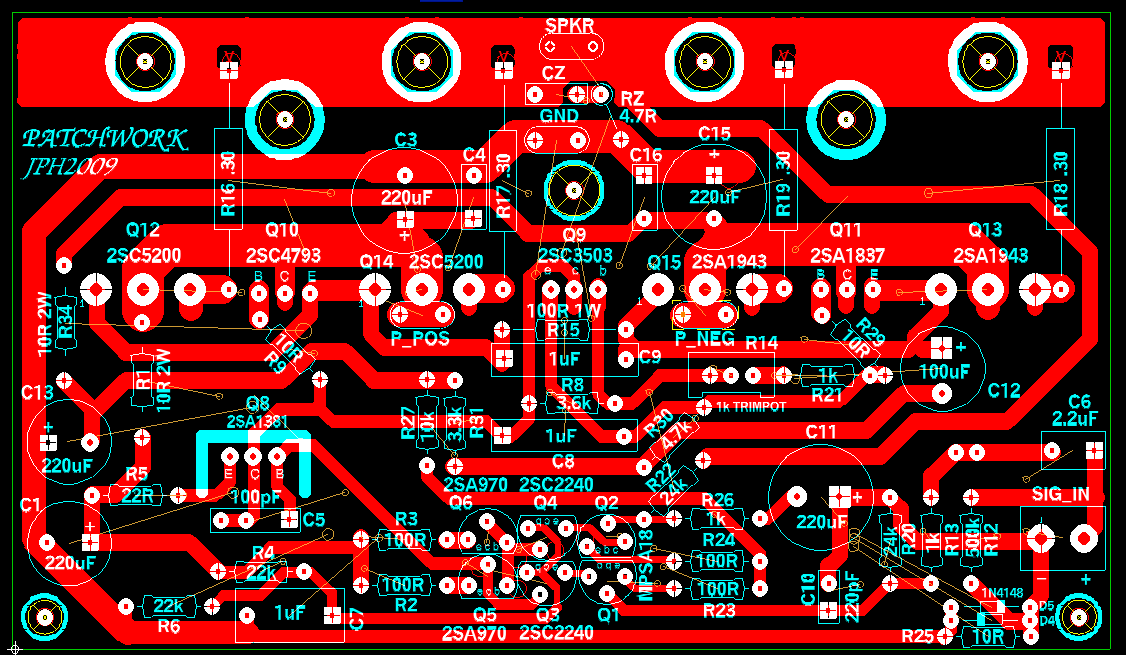

C10 doesn't look at all like 5mm.
What's the specification for C5? It isn't on the BOM.

C10 is a 220pF ceramic. Leads are long - no problem getting them into the holes.

multi pin pitch
Even a choice of two pitches for each cap location widens the choice of supplier, and cap type. This can usually be done without any extra PCB space.
Do not try to layout for every conceivable cap size
even allowing for MJL's comment, I still recommend multi pin pitch.Not really needed, these are common sizes and really wouldn't be a problem sourcing them. Laying out a board is hard enough without allowing for every conceivable cap size.

A couple things: Use THIS for C10 - higher voltage rating.
R1 and R34 should be 2 watt, like these.
C7 should be a higher voltage - this one.
A heatsink for Q8 here.

C10 is a 220pF, while you picked out a 100pF? Do I need more than 100V?Excellent 454!
Oops! Sorry, I meant C5. I thought the one you selected was 100V.

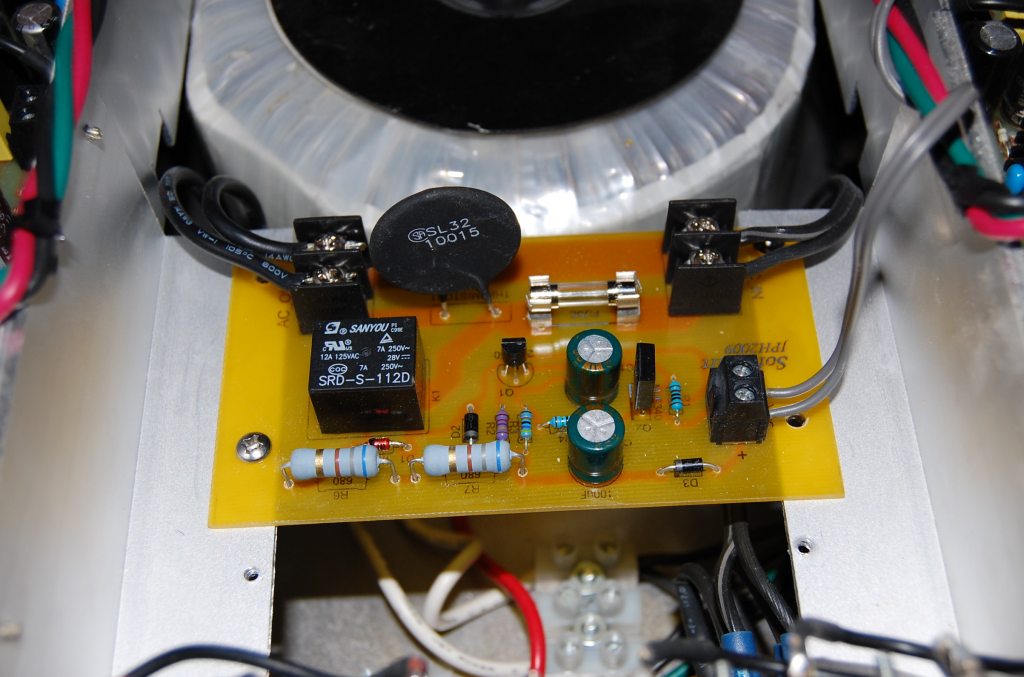

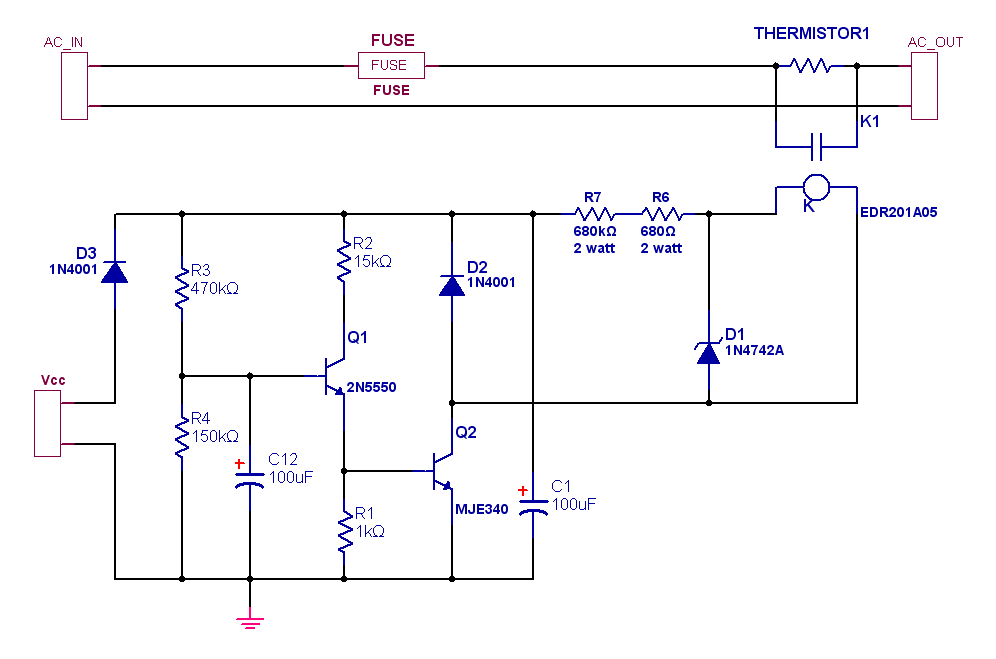

Sexy new soft start.
This replaces the previous one that was on 2 boards. It is basically the same but more streamlined:
It is simple, complete and self contained - runs from the main power supply (so no auxiliary transformer) and has a ~one second delay before the relay shorts the thermistor. Quite neat actually, I very proud of it!
100V for C10 is OK?
Yes, plenty good.
