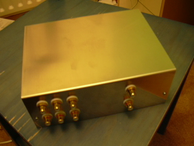

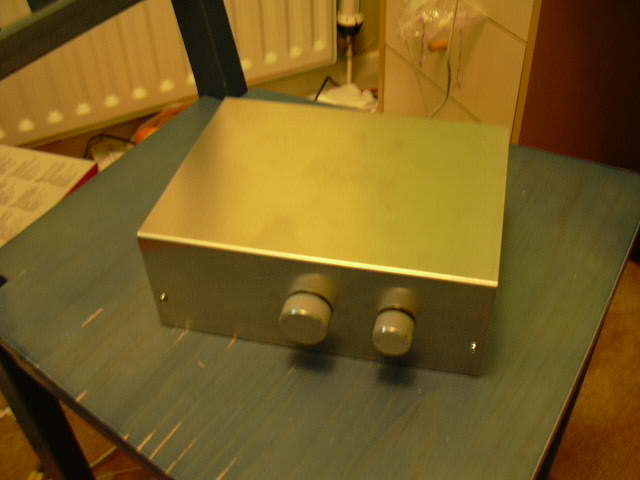

Here are some pics of my new preamp. I know it doesn't have a short signal path - but I love it! The case is a common aluminium case with bushed aluminium knobs.

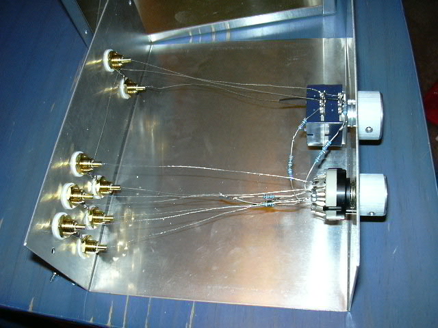

Final one. Here are the guts. An Alps 100k dual gang pot and rotary switch. The resistors are 1% metal films. The wires are...wait for it...home made:
I got IDE flat cables and took off one wire from the ribbon. I took off the insulation and seperated it into its 7 seperate wires. I then braided three at a time. Don't know why - but it sure as hell impressed my friends! 😉
