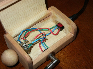

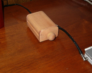

So here's mine - sort of a badly needed panic volume control between my DAW and monitors. Parts are RS 100K stereo pot, 2 14.75K resistors (closest I had), 2 RS Mini-Jack connectors and courtesy of Hobby Lobby, a 50 cent box & a 99 cent knob. No silver wiring so I don't think I broke $10 on this project.

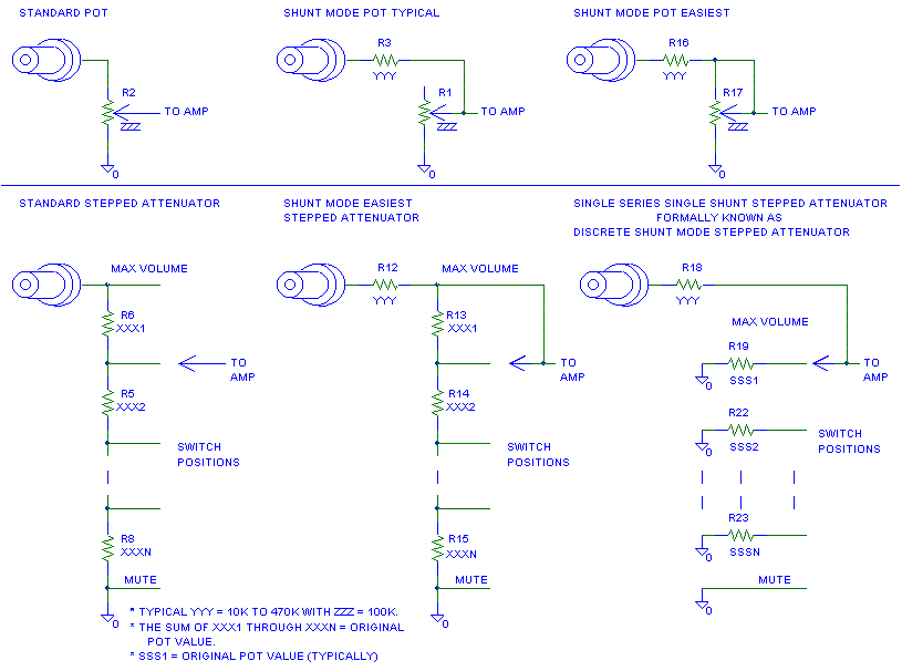

Output impedance of my source is 75ohm, input impedance of my power amps is 100K. What Alps pot, 10K, 50K, 100K and wich resistor should i use? Thanks a lot!
Today i tried a 10k log alps with 10k resistor (shunt mode) sound is realy nice but almost no bass🙁
Next experiment was a 10k linear alps in normal mode, no series resistor, know i have realy nice bass.
I am confused now what i should do. Come on guys lead me in the right direction.
