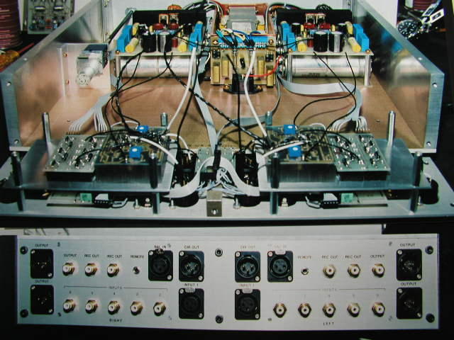

More pictures for your apetite
Thats the preamp I'm using. The mid, high section is passive; subwwofer part is active. Active section is based on A75 input stage. It's potted and each channel has 10 relays which change the feedback resistor to set gain. The volume control is shunt type with 24K series Holco resistor and remotely contolled Alps 100K potentiometer. I have more inputs that I'm actually using.
