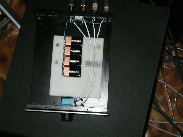

Much to your surprise I bet, I agree. I use RC filters on the input almost all audio circuits. I also like ferite clamps on power cables and audio cables. I highly disagree with designers that build very high bandwidth amplifiers and preamps. RF frequencies get demodulated by audio circuits and can form distortion products down to DC. I also believe that FET circuits suffer less from this than bipolar. The passive has very short signal path and I have not noticed any effects from RF or 60Hz in my setup. I feel it is much less likely to pick up noise than a pair of unshielded interconnects. It is a bit of cosmic justice getting nailed on this since I did EMI and signal integrity in my last Telecom gig. In self defense I submit this picture of my reference preamp with input RC input filter, battery biased shielded wire, and a steel chassis ... Good advice and input.

Of course that circuit could be improved as well. I didn't mention that on the previous preamp because it supposed to be cheap and easy to do. But when I see a reference unit I can't sit quiet. Why not to mount potentiometer at the back of the unit and connect it to input/output jacks directly with very short wires. Then install on the potentiometer's shaft 10" extension to the front plate. That way you eliminate the wires and no matter how good they are they still have influence on the sound. You might even get rid of the batteries. I didn't quite understand what they do. Would you elaborate more on that subject. And what about those blue dots in corners. Did you put them "just in case" or you actually made comparison with and without. I wonder what was the actual difference.

Yep I could have put a shaft extension but the enclosure was home to an active preamp at one point might be again. The blue dots are chassis damping with EAR material. Actually at this point the chassis uses constrained mode damping and the white portion is rigid polyethelyne with EAR material between it and the chassis. The wires are also clamped with EAR material to this polyethelyne block. The battery bias is between the wire shields and the ground and signal wires. The shields carry no audio currents and are tied together at only one end and connected to the RCA jacks ground via a 0.1uF MIT cap that also carries the bias voltage. Jacks are Cardas rhodium. The attenuater is a series shunt cofiguration With Caddock TF 20 resistors and a 100K Alps Black Beauty pot which is also damped with EAR material. The inputs have Holco resistor/Seimens polystyrene caps input filters to terminate input interconnects resistively at RF frequencies. This makes sure that the source is not driving a reactive load at RF. The input filters also bandwith limit RF signals the could get through to the power amp. All the wire is stranded silver clad OFC copper with teflon dielectric. Solder is 4% silver 96% tin. Even the with 15" signal path it sounds pretty cool. The are several battery biased cables on the market. It even sounds better to bias digital cables! I have bulit dozens like that.....

So if I understand it correctly you apply battery voltage between ground and the shields with capacitor across battery terminals. How important is the value of the voltage. I'm using Kimber Illuminations D-60 interconnect with BNC on my digital rig. Can I apply that technique and how should I do that? BTW if you disonnect the battery how the sound changes?

I will have to draw a schematic and I will try to get around to it this week. I use 100V ERO polypro caps since they are small. I AC couple the center conductor of the digital cable. Connect a 1 Meg resistor to the center conductor and bias with a nine volt battery. You have to let the wire settle for a few days since the biased wire has to go through break in with the voltage across the dielectric of the cable. I have not biased the D-60 before. I will have to find it around here somewhere. I used to talk to Chris Sommevigo all the time and he traded me a D-60 for some equipement I was selling. I have played with bias from 5 volts to 40 Volts to high a voltage will screw up the sound. I am not going to tell you what I hear but you can try it and tell me what you hear.... The theory is the wire becomes more rigid from the electrostaitic force and that the polar molecules become aligned from the polarization voltage. I am not a material scientist but this sound like reasonable factors. I might have some caps left, Email me and let me know how you plan to do this mod.

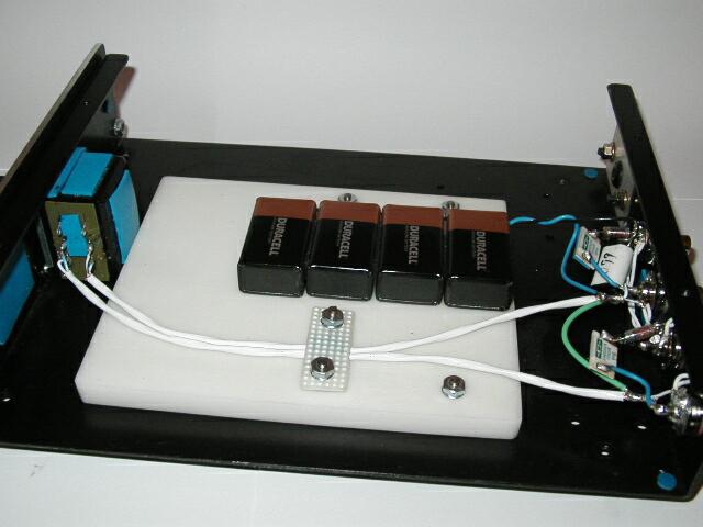

I present the Nimbus 2002 Reference passive attenuator to help passify (whoops.... a pun, I promise not to do it again) HPotter's concern over wiring length. I also unsoldered the leads from the Caddocks and soldered wires and input RC filter parts directly to the pads on the resistor substrates. That's half the wire length and 10 less solder joints! Now for a week of break in.......
