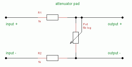

doing a passive "preamp" for balanced lines is easier than you may think.
You will need two resistors and one (log) pot for one balanced pair. You can also use a linear pot with a law faking resistor of course.
Try (not tested in this configuration) following values with a good low impedance balanced output:
+ ---1k--------------- +
in 10k pot out
- ----1k---------------- -
Klaus

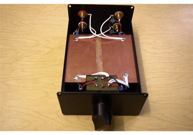

This is a picture of a Harry Haller inspired passive preamp. Simple construction, Vampire input/output connectors, DH Labs interconnect wire (with shield wire), ALPS 100K black beauty pot, and two 12.1k caddock resistors in the Law Faking design.
I connected this passive preamp in the traditional style with wires connected from input/output connectors to pot. And the sound was amazing clear with panio and vocals had a pristine characteristic. Bass was good and accurate with soundstaging and imaging presented superbly.
Well I couldn't leave well enough alone and I wanted to try something else. The picture is the way I'm listening to the preamp. The double sided PCB I got from Communcation Hud (Radio Shack) which I cut as showed (nearly cut myself many times). The shields of both wires at both ends are solder to the bottom of the board. And as for the sound, I like this way better. The preamp doesn't have that overall pristine sound anymore but a more mellow sound. All instruments are still well defined but softer. The soundstaging and imaging did not change. I encourage everyone to build a passive preamp the sound quality to price ratio is one of the best bargains in high end audio.
