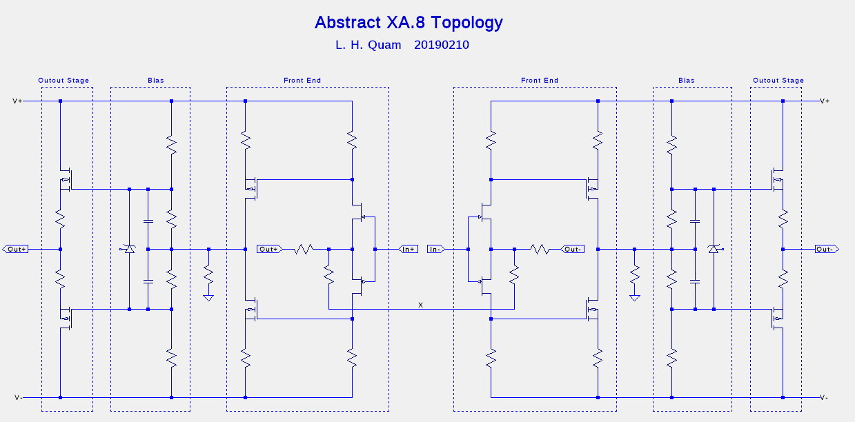

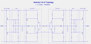

You are omitting that the XA.8 is a balanced circuit.
Correct, I forgot to mention that. The open loop gain calculation is the same for each half.
For completeness, here is the balanced XA.8 topology.
