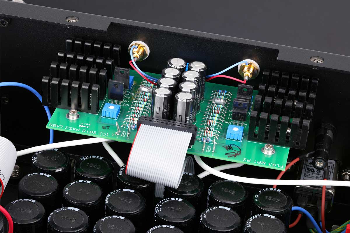

I have a multimeter, but I'm asking for a friend that owns the XA25. He wanted to use a 1/4" headphone jack adapter with the amp for very low efficiency planar headphones. I assumed the negatives were connected since it's single ended input only. Thank you!
I mean the picture of the front end pcb.

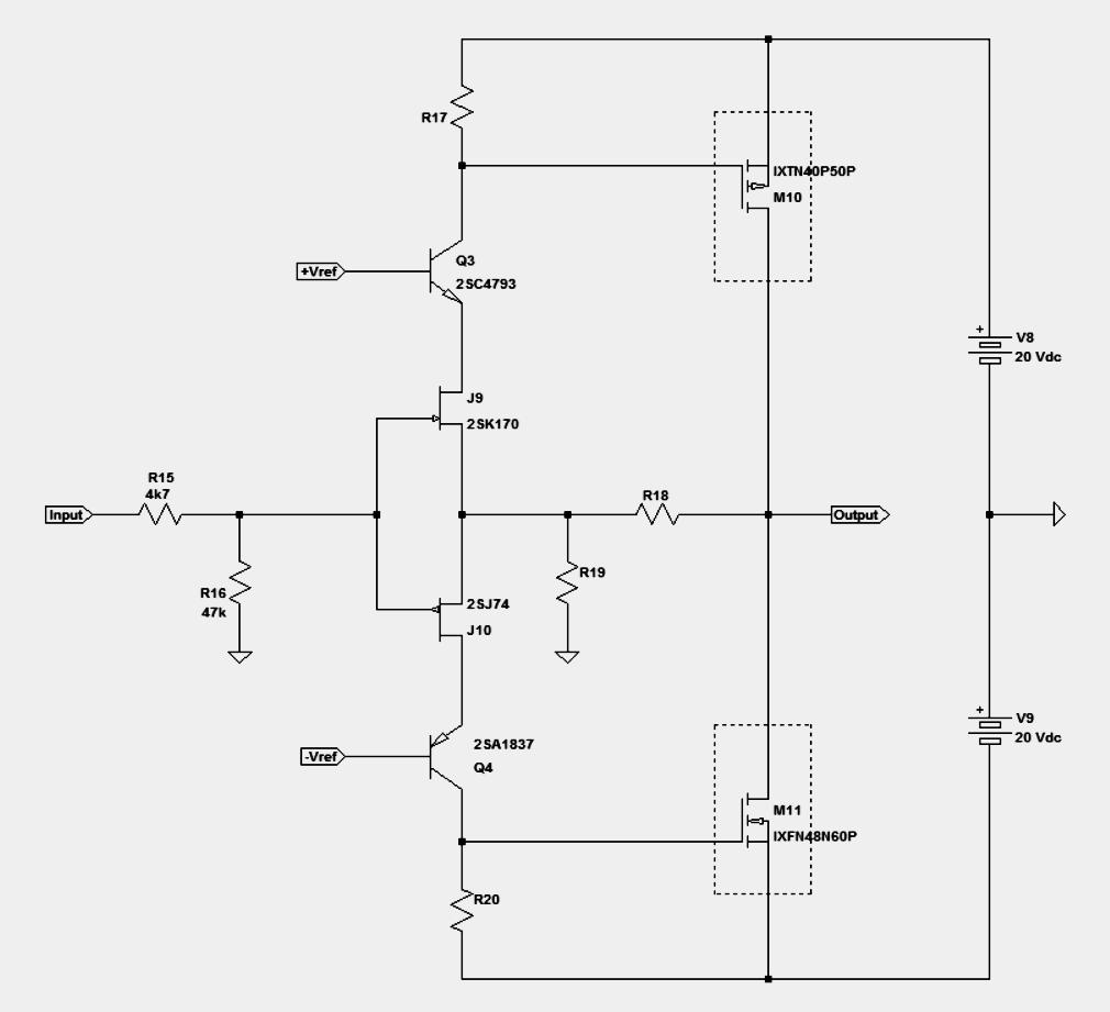

After reading some of the threads on First Watt and Pass Labs designs, as well as the square law paper, this is my guess of the XA-25 front end, maybe it could be close… ? I have no clued how could be the output stage, optocoupler biased with runaway control, and DC coupled!
I'm gradually coming back to audio electronics, which I haven't worked on it for maybe 10 years, Since the Blowtorch threads and Charles Hansen designs. I lost a lot of electronics knowledge in the meantime, knowing that my job was more artistic as a sound engineer. When I retired I rather did amateur music as bass player with friends.
What are your thoughts, let’s go ;-)
