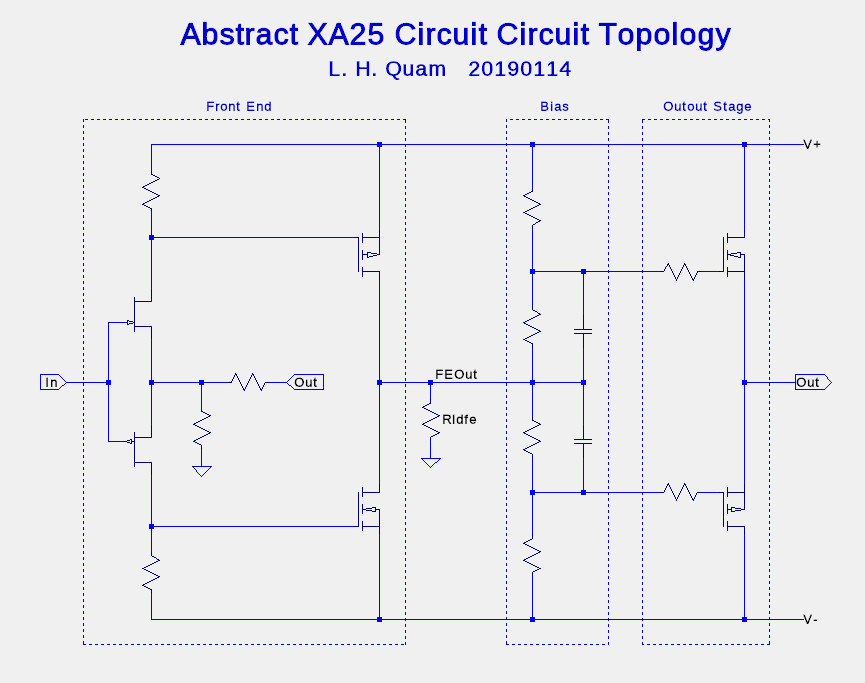

I forgot to mention that the AC load on the front end is the parallel resistance of Rldfe and the bias network. Ignoring the capacitance of the output FETS, the bias network presents an AC load of RbP || RbN. For my amplifier RbP || RbN = 16.5K Ohms.
I imagine that each of these stages is exemplified by builds discussed on Pass DIYAudio? Might you suggest active device pairings if I wanted to play with a 1-5W output version of this circuit?
It appears that the ouput stage of your amplifier (https://www.diyaudio.com/forums/attachments/pass-labs/729072d1547517850-pass-xa25-abstract-1-asc-jpg) exemplifies Zen V5 (https://www.passdiy.com/download.php?download_file=/images/uploads/project/zen-v5-hires.pdf)?
From the XA25 manual; "The XA25 is "a simple 3 stage circuit with total of three pair of push-pull gain transistors." Your circuit follows this description, two pairs for the front end and one pair for the output? Further, the manual states; "In their ideal state, matched push-pull FETs give perfect 'square law' cancellation of distortion, an effect somewhat spoiled by degenerative Source resistance used to constrain the 'personality' of the devices." As I look at the ZV5 circuit, there is no degenerative source resistance for ZV5 simplified circuit; correct? For the build, R9-12 are sources of degenerative feedback? Is there a PassDIY project that uses two push/pull pairs for front end? I have not found one. Thank you for commenting.
Thank you for providing the related projects. As I was reading reviews for the XA25, one of the reviewers made the comment that the HPA-1 might have been designed with the XA25 in mind. Knowing that I would be running long single-ended interconnects, I chose the HPA-1 over the XP10/12. I don't even own a pair of headphones. I find it interesting that Jam is a main contributor to the the ZV5 thread. Am I wrong or has the ZV5 build been relatively ignored. I don't see where anyone literally built one. Might I be missing a DIYAudio thread?
I realize that the following question should be asked on the ZV5 thread but, the distortion for the ZV5 appears to increase at less then 1.5A. In my naivety, if I want to build a 1 Watt amplifier based on ZV5, can I find a different complementary pair with low distortion at maybe 1A or less?
So I am perhaps wrong about ZV5 being the basis for the XA25 output stage? The ZV5 requires gain by the complementary pair and, thus, is common source. And inverting. The XA25, having two complementary pairs in the front end is apt to be common drain (voltage follower) on the output?
Based on Nelson Pass's original post about XA25 characteristics, is it simply obvious whether the XA25 output is a complementary follower stage or a complementary gain stage? The LH Quam circuit is a common drain and, thus, has gain? Argh! Perhaps if I read the entire BA series and the F5 I will get ahead.
Ignorance is bliss. I simply connect the BA3 front end to a low wattage ZV5 back end and the angels may sing on battery power at my off the grid cabin?

ZV5 is F5
download all articles from Papasite and read .......
you asked several questions which lead me to conclusion that , even if I reply on them you'll not understand answer , given even in most simple way , while going simpler than possible is without point
some things can be mixed , some not
you can make new picture with puzzles from different pictures , but tearing puzzles in pieces is counterproductive
for instance - ZV5 (F5) is one whole - input JFets are not just having gain (and being gain stage) but also serve as biasing apparatus fro output stage ..... so tearing them apart is leaving you with two pretty much incomplete parts of construction
so , again , one can mix'n'match different function blocks , while disassemble of function block is ..... demanding higher level of recombination
