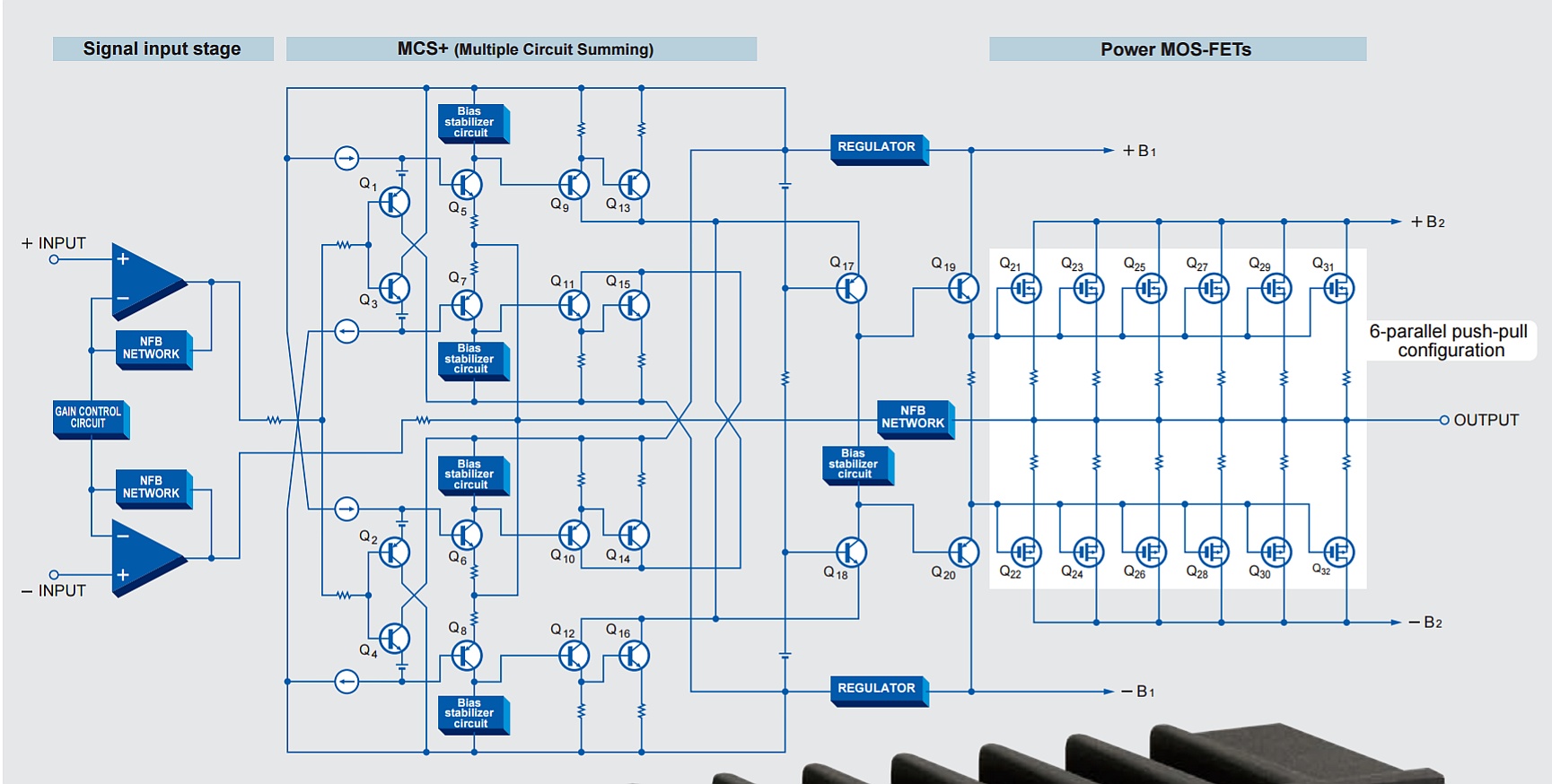

IC manufacturers often disclose "conceptual" designs of their products (AD797).
That is the case even in audio. For example, Accuphase always discloses their conceptual
design schematics of their products (see attached pic below)
Any unique design, may be protected through international patents (super-symmetry, aleph and so on).
Even then it may be openly discussed since it is public knowledge.

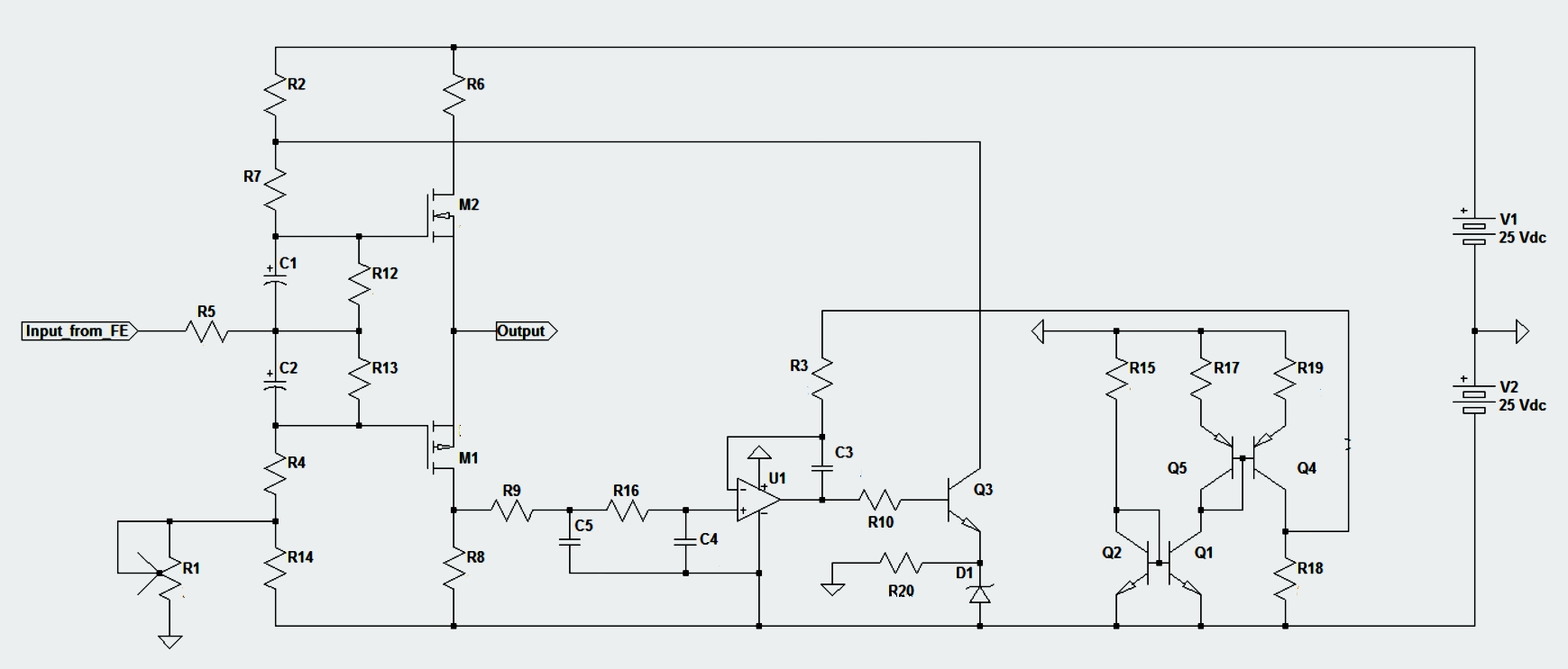

Yep. I feel like many of us have had fairly close (maybe even very close) conceptual schematics since maybe a week after the XA25 announcement. But, the real trick is biasing the hockey pucks and preventing thermal runaway. Being a non EE, I solved the problem in my first version of a similar amp in a terribly naive way. It works and sounds great, but is definitely not the most elegant solution and will likely not allow for class AB operation without thermal drift.
Back End - Possible Solutions
There is a lot of discussion about the possibility of regulating the bias current through the back end of the amplifier.
I have seen some really nice solutions in some of the threads here, and the biggest problem seem to be the temp drift.
The attached solution might work fairly well, as the reference is temp compensated, and the Offset voltage is hence regulated, since it is a function of the bias current.
It is my solution and a very simple one, and I would like to share it with the rest of you.

Greetings Mr Colburn.
Thank u for the vote of confidence.
Well, you are one of those selected few able to make that comparison.
I will try to simulate the circuit once I get my ltSpice running. (I installed
the newest version and it crashed).
Nothing exciting... possibly the temp-compensated reference (although not tested yet).
The remaining circuit is an appropriately slow comparator, with low
offset error, to track any low-f, Id-change due to drift.
The comparator might be incorporated into the amp....I'll have to take
a closer look.
Another interesting side-effect of the double mirrored reference is that the sense resistor may be kept
low, < 0.1, and unipolar, to avoid any subsequent headroom loss.
As mentioned, I could not test it yet, I'll get back to you once I get the SW running on my PC.

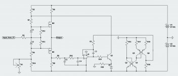

Back End - Possible Solutions - Simulations
Well....I have run some simulations on it and the presented circuit above works as advertised.
Very nicely regulating the bias current of the output Follower Stage.
I am having some major problems with the ltspice...I think it might be my PC and not
the SW itself.
I ran two simple simulations: one at 20 deg, and one at 80 degrees.
The current changed from 1.502 A till 1.508 A.
I would call this a VERY tight regulation of operating current.

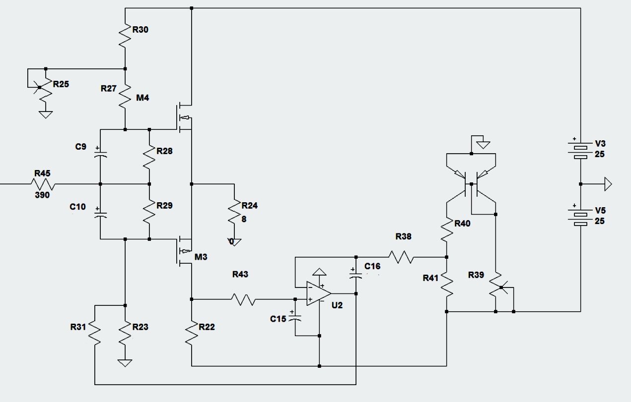

Back End - Possible Solutions III
As mentioned yesterday, it would be possible to simplify the circuit a little.
So here it goes.
Once again:
These are my own solutions mine.
These are not copies or clones of anything or anyone elses design.
In the spirit of sharing, I would like to share these solutions with the rest of you.

Back End - Possible Solutions III - Simulations
The simulation results are equal to the first circuit - as they should be.
Two simple simulations were performed:
at 20 deg: Idq = 1.501 Adc, Vdc_out = +6.43 mVdc
at 80 deg: Idq = 1.508 Adc, Vdc_out = -20.1 mVdc
I am not 100% certain about the simulation results, as I am having major issues with ltSpice.
But these are very simple circuits and the simulated results are fairly indicative of what to expect in implemented circuits.
Surprisingly quite a few people have emailed me, stating that they are really worried about the use of OP in the circuit.
Does it affect the sound quality? It might, as any parallel-servo circuit may.
Before I get more mails:
Yes, it would be possible to use transistors instead of the OP. Maybe it would be preferred.
No, I do not know how to further simplify the circuit without sacrificing performance.
Cheers
