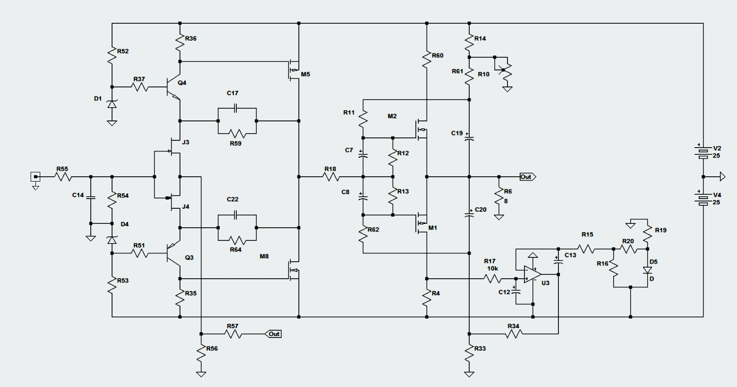

Well, I put together the conceptual FE and BE of the previous posts - to produce a possible iteration of the whole circuit.
I have simulated the whole circuit. Although I have not had the time to search
for the correct pspice-models of the semiconductors, it measures very well indeed with the IRFP240/9240 and the dubious models of the rest of the semiconductors.
Please take a look.

Comments
R30, C4, C5 are not a necessity, they bootstrap the power-feed resistors
for a slightly better PSSR and a litter higher Open-Loop Gain. They may be left out.
The circuit features very low distortion. The Square-Law characteristics of each half of the circuit
produces lower order harmonics that readily cancels out in the complementary arrangement.
The bias regulator-circuit keeps the Idc VERY stable regardless of temperature variations.
It is possible to just use a silicon-diode and a voltage divider to create the required
reference voltage.
It is not necessary to use the temp-compensated voltage reference as shown.

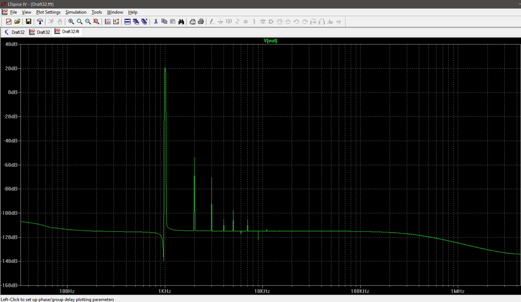

fft of output 20W in 8 ohms.
Bias is = 2.5 Adc
Voffset out = 1.5 mVdc

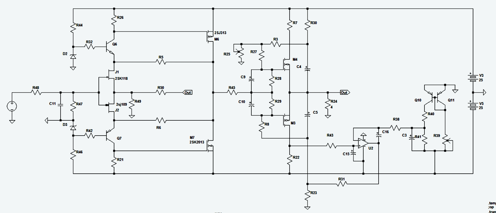

Conceptual Schematics XXIII - simplified
A few fellow diy:ers have expressed concerns about the complexity of the conceptual schematics and the number of OP amps and servos used.
Remember that this is not the original XA25 circuit, it is only a possible solution.
I am sure Pass Labs has a much better and more optimized circuit.
It is possible to slightly simplify the circuit though.
That would be to remove the DC offset servo and replace the reference voltage source with a simpler one.
But remember that it will exhibit thermal drift in "simple" simulations, but in real life it will work very nicely indeed (as long as the diode and the heatsinks
are not thermally coupled).
Please have a look:
