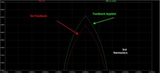

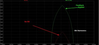

Pass XA25?
Simulations II

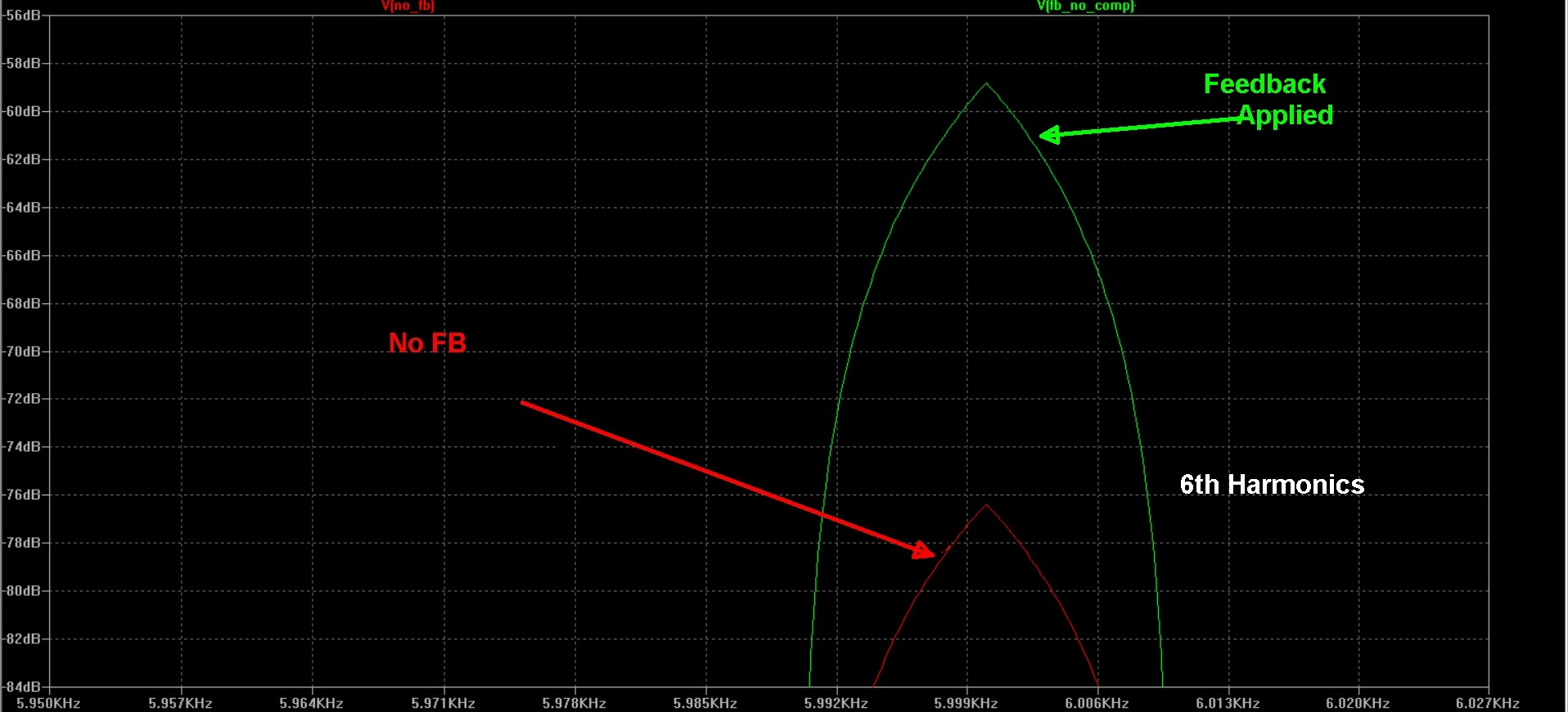

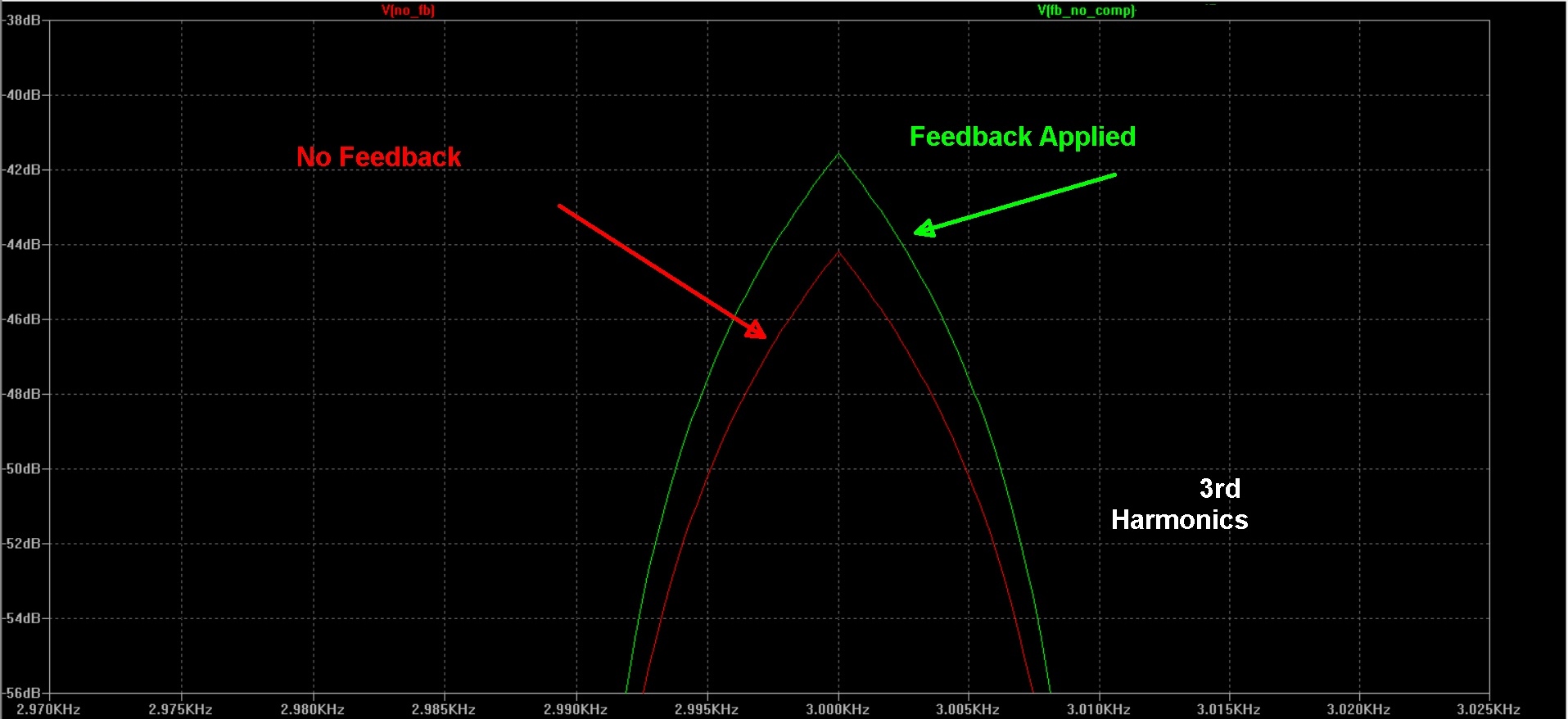

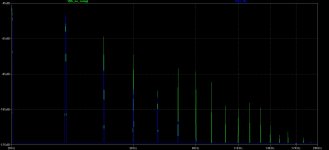

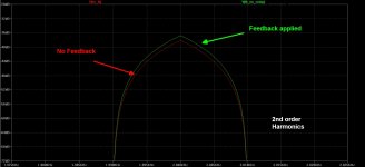

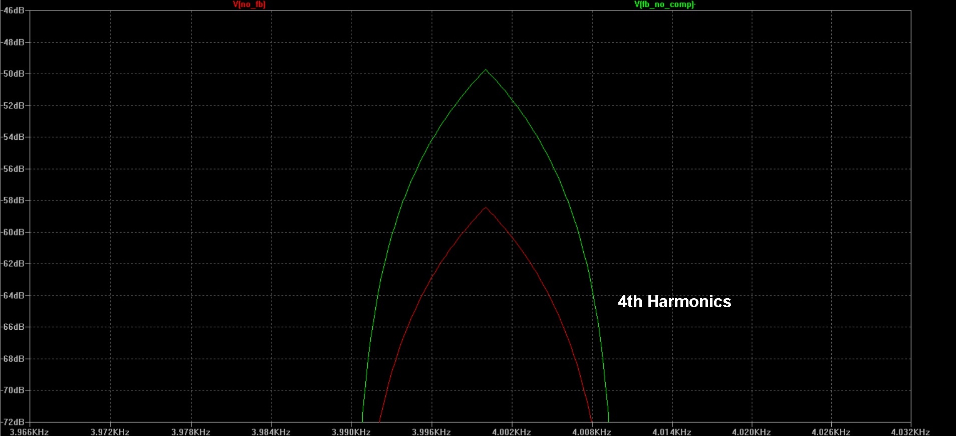

As can be seen on the zoomed-in graphs, the amplitude of the
overtones are all higher!
As we go towards the higher numbered harmonics, the more profound the difference
between the No-Feedback and fedback-Amplifier becomes.
The amplifier that features 15 dB of feedback now show clear signs of much higher
amplitudes on higher order harmonics!
2nd, 3rd, 4th, 6th, 8th, and so on:

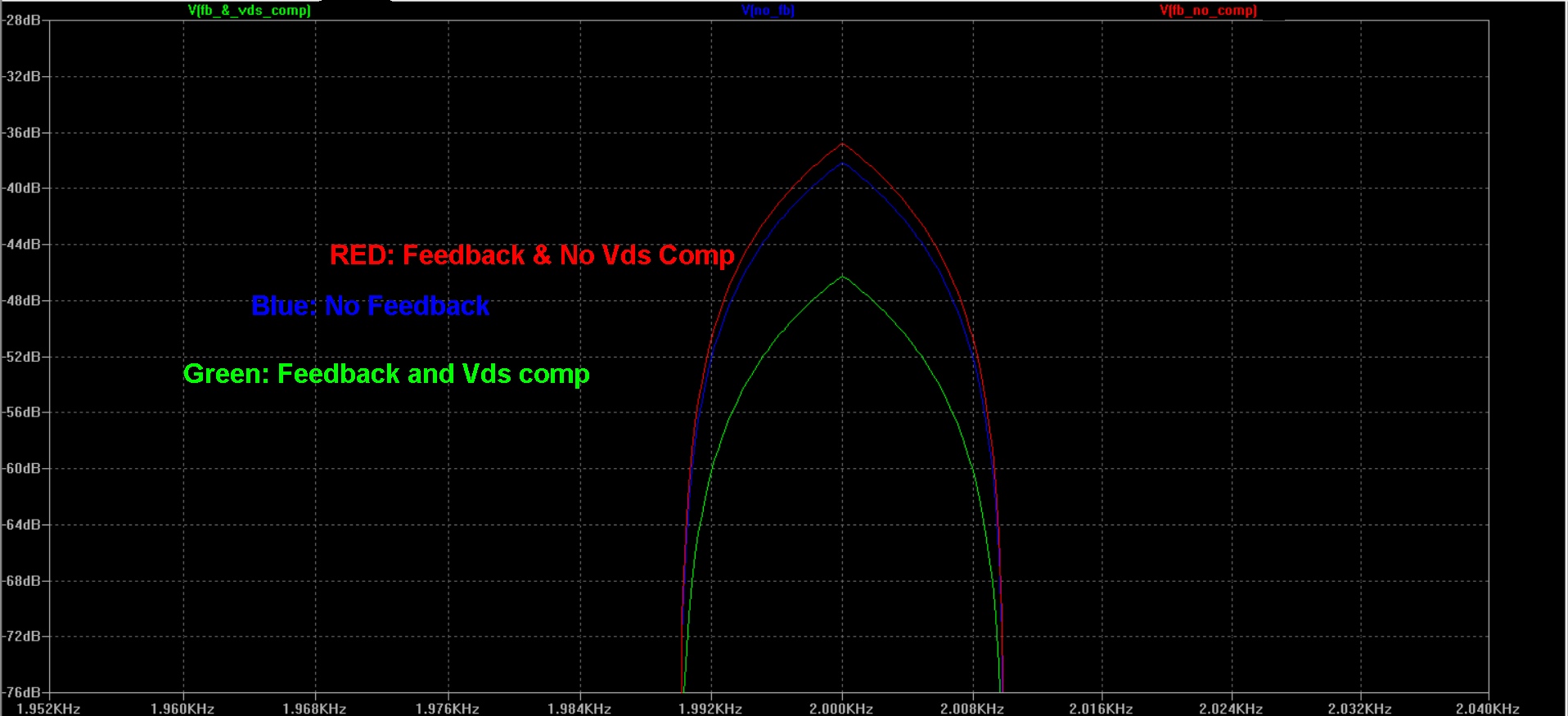

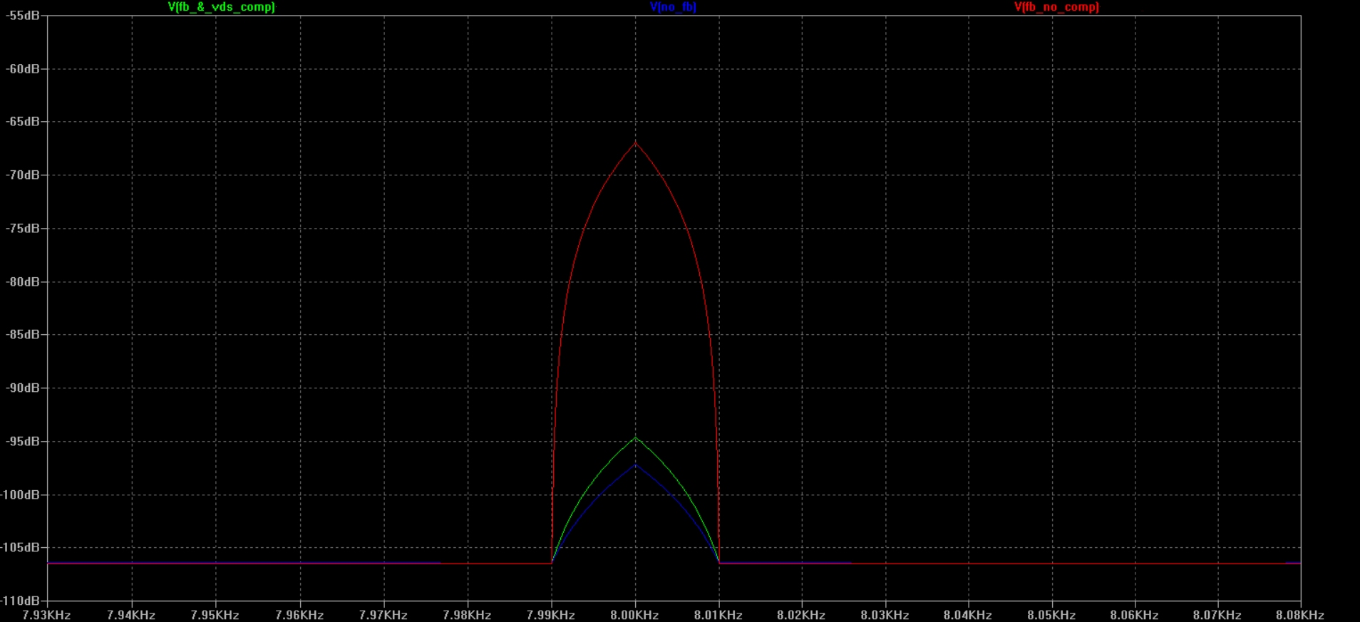

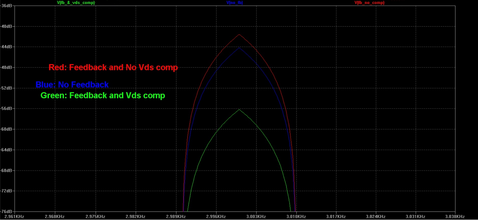

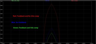

Simulations V
Let's create another version of the test signal, where the loss of headroom due to
the degenerative feedback element has been compensated for.
And lets put all these graphs together and compare:
Blue = No Degenerative Feedback
Red = Degenerative Feedback applied
Green = Degenerative FB and Vds compensation applied
Lets see:
2nd, 3rd, 6th, 8th and so on...
Interesting... how is this Vds compensation done? Do show your Sim so that we can understand 😉
It is exactly according to the circuit description in the Pass Labs documentation "Distortion & Feedback".
That is:
- Single SE MosFet stage
- Biased at 2 A.
- 8 ohm resistive load.
- 11 V across the Q.
- one circuit (cir. 1) with no degenerative feedback
- the other one (cir. 2) with 15 dB degenerative feedback applied.
As described in the Pass Labs paper, the circuit with 15 dB feedback clearly showed significantly higher amplitude on higher order harmonics.
This was verified to be correct by performing Transient Analysis simulations.
In order to examine why this was the case, an additional circuit (cir. 3) was created in which appr 3V of voltage loss
due to 15dB degenerative feedback has been compensated for - simply by increasing the Vds by an equal amount.
As depicted in the SIMPLE simulation results, this circuit does not suffer from the higher order harmonics as the test circuit proposed by Mr. Pass.
In actuality, cir. 3 has LESS distortion than the No Feedback circuit.
This result contradicts the claims in the Pass Labs document.
This led me to suspect that the higher-ordered harmonics created in cir. 2 might be due to some other mechanism than feedback alone.
Feedback in such linear, LOW FREQUENCY circuits will not create higher ordered spuriae.
PLEASE NOTE:
No body is claiming right or wrong, and no body is trying to insult anyone.
We are merely examining the presented data a little more carefully. That's all.
That is what engineers do, it is not an insult or disrespect towards anyone.
Sugar-coating or serving everything with cream and honey is not part of the engineering doctrine.
If this stuff bothers you, go read something else for a while and then come back.
cheers

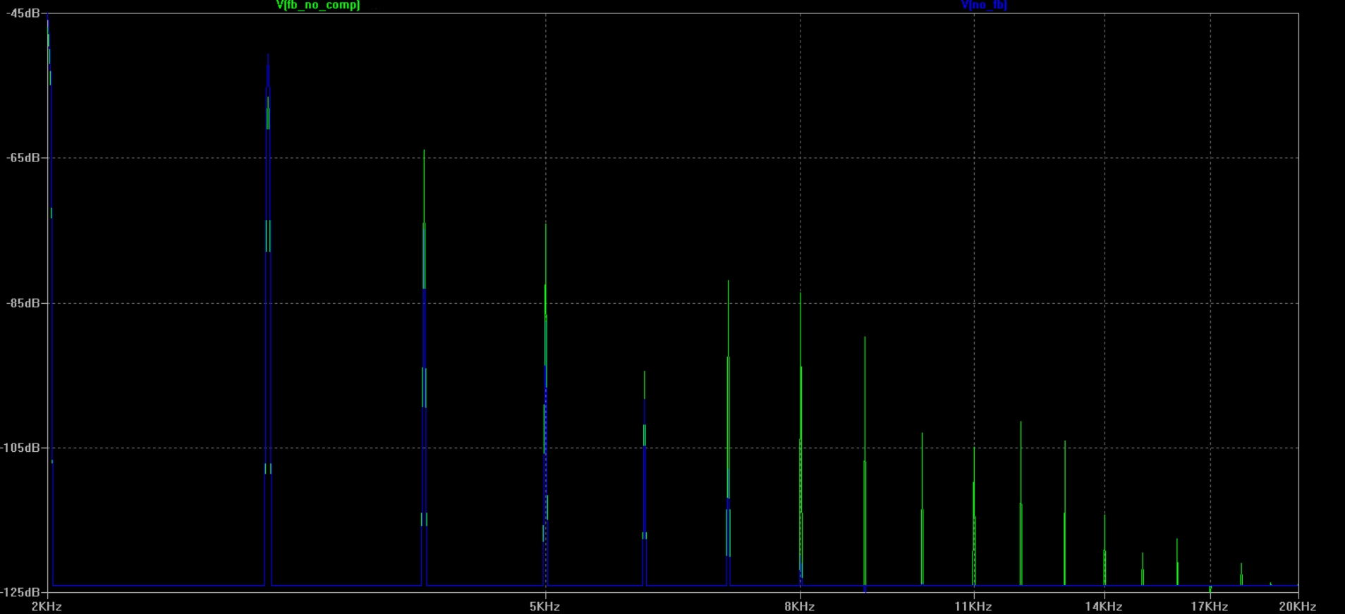

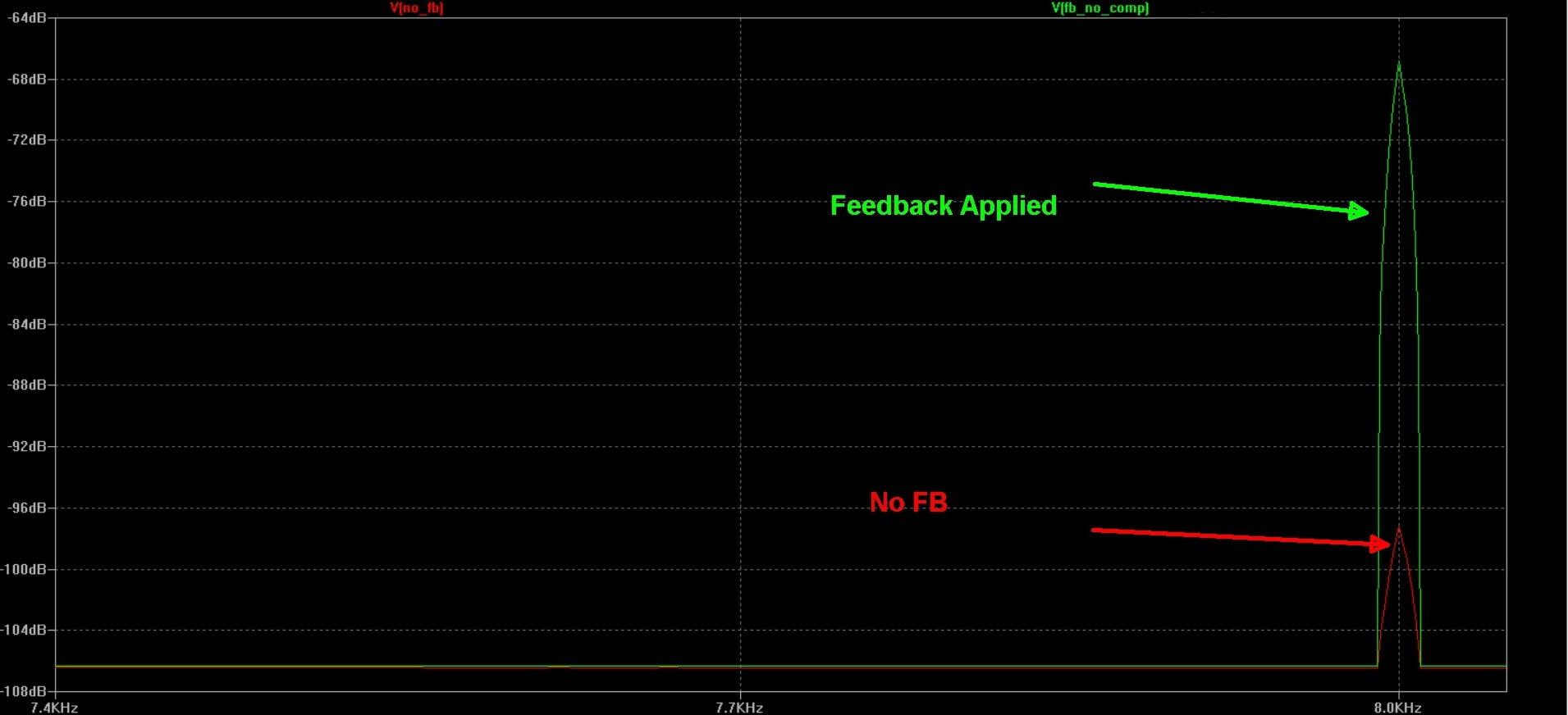

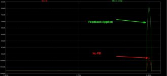

Simulations VI
Please take a look at the picture below:
Blue graph is the output signal at 1W into an 8 ohms load,
exactly according to the circuit example in the Pass Labs document.
Green is the output signal of the amplifier with 15 dB degenerative feedback.
As can clearly be seen, there is substantial amount of higher order harmonics being created in the 2nd amplifier that features 15 dB of degenerative feedback.
