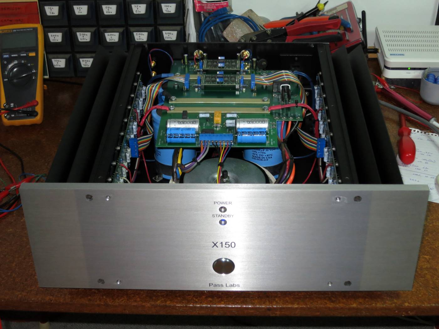

Pass X150 Where does it sit in the overall line up ??
1 : O&C said it was sold in Hong Kong '03.
2 : HK is 220Vac.
3 : O&C measures higher rails than to be expected.
4 : Silly fck messed around with this amp.
1+2+3+4 => amp transformer still wired at 220Vac setting.

just swapped the primaries around...
with current mains of 235, filters are sitting at 36, and the hum has dropped by ??? 1/2 maybe if not more.
still possible to hear it in a quiet room, but you have to listen for it now.
much better 😀 - not perfect, but better. i can live with it now, for the moment..
