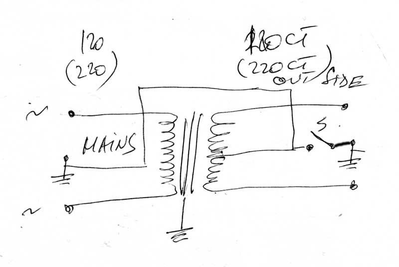

IF the 'buzzing' transformer IS due to 'dc on the mains',
would not a 1:1 mains isolation transformer be a far better and safer 'cure' than the 'two caps four diode' methods seen around..
I am Not at all comfortable with the idea of diodes and caps directly in the mains path...
I know it would be more expensive, but dammit, i'd rather spend the money and know it wont kill someone...........
twocapsanddiodes will not kill anyone , if you pack them wisely ;
use your imagination :rofl:
isolation xformer will kill DC ( but also humming in the process :rofl:) , you can also have some nice benefits of making balanced/symmetric mains feed , but be sure to use EI xformer type , because they're less sensitive to DC in primary .
in any case - you need to find culprit of buzz of your toroid ; killing DC is easiest and cheapest way to do it ; probably best and most effective way to have a fun is to build both DC (caps&diodes type) blocker and isolation/symmetrizing xformer in one common case , connected in series .
that way you can kill both possible hum and noises from mains
conclusion is - DC blocker with caps and diodes is completely legit way of doing it - you just need to take normal precautions in housing it .
Hmmmmmmm, what i might do then, is build a quick and dirty cap/diode blocker, just as a test.
if that works, then ill go for a xformer + ??? solution.
Im aware that iso trans may very well buzz, which is why id be looking for vacumm impregnated or 'baked' versions. and as a seperate device, i can rubber mount it, and stick it in a solid noise insulated case..
would i have to go the full 800w for this to match the x150's 800w max draw ?
Begs the question though...
If 300w+ toriods are known for being vunerable to 'mains dc', and its so 'easy' to throw a few $$ of parts at it can cure it.
Why do some makers not do it from factory ?
I say 'some', because im seeing some that do actually use the cap/diode built into there amps......
Oh, and does anyone have any diagrams of their prefered method for mains filtering and blocking ??
Thanks to all...................
isolation xformer principle
you need power at least 2 times of your max load power - meaning ~1,2KW , even if I have some doubts that you'll use 600W for your amp
but - that's your last concern in this stage ; it's more like icing on the cake , and it is really a question did your system will like it or not

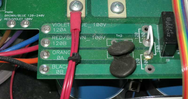

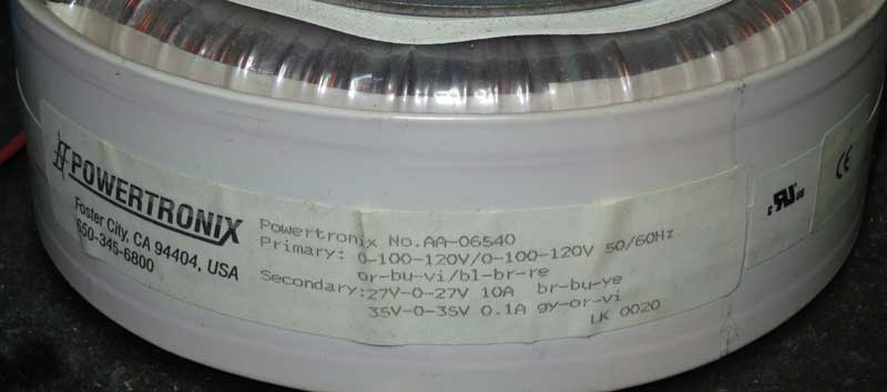

IF the 'buzzing' transformer IS due to 'dc on the mains', would not a 1:1 mains isolation transformer be a far better and safer 'cure' than the 'two caps four diode' methods seen around..
As a rule transformer noise with Plitrons/Powertronics is due to dirty AC,
but it's not as though I've never seen a transformer go noisy.
Diodes and caps are OK as long as you do your wiring carefully. In addition
to that and the isolation transformer you can try a couple of thermistors
in series with the AC line. Two CL60 from GE Sensing would probably tell
the tale.
Many thanks Mr Pass.
It's still on the bench, but going back together.
Daym it looks so much better now.
I hope to make you proud 😉
Hope to have it running and reset on the weekend.
Then I can get back to the buzz.
I notice the main board already has a pair of CL60's in the primarys.
So I'm assuming that a second pair would be beneficial ?
Thanks all....

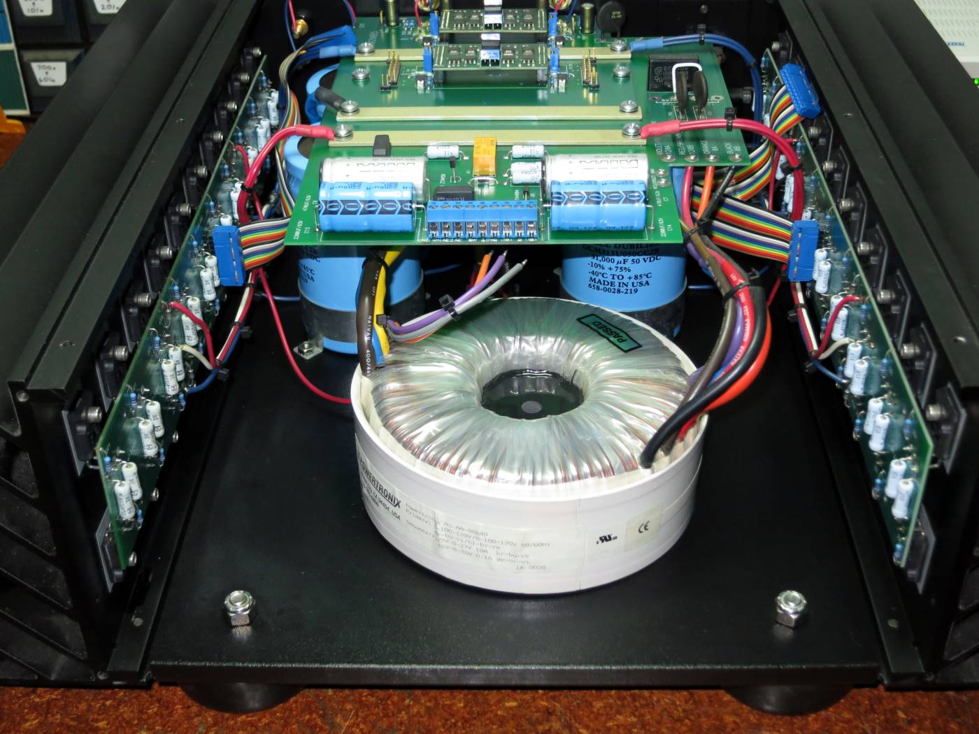

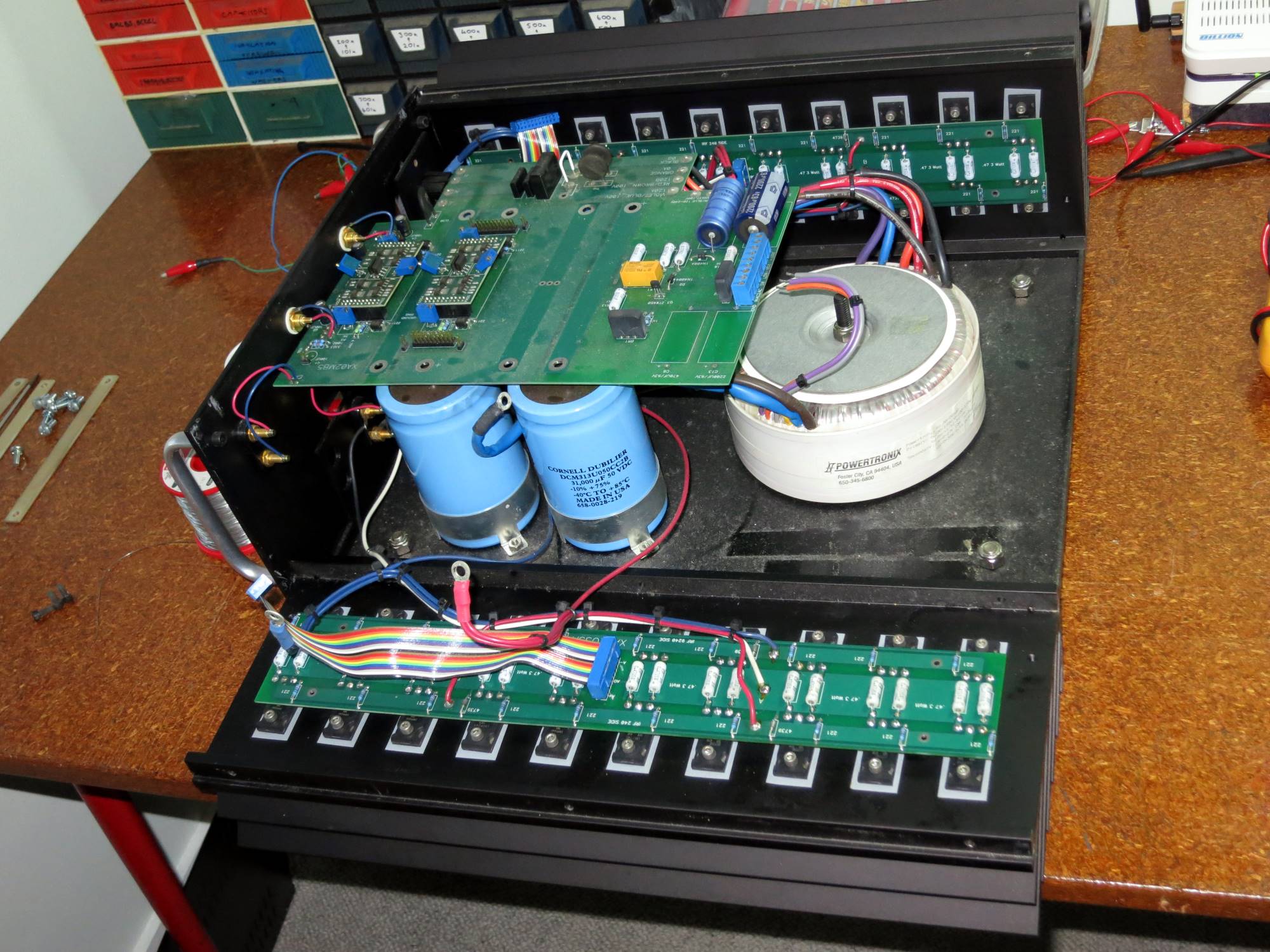

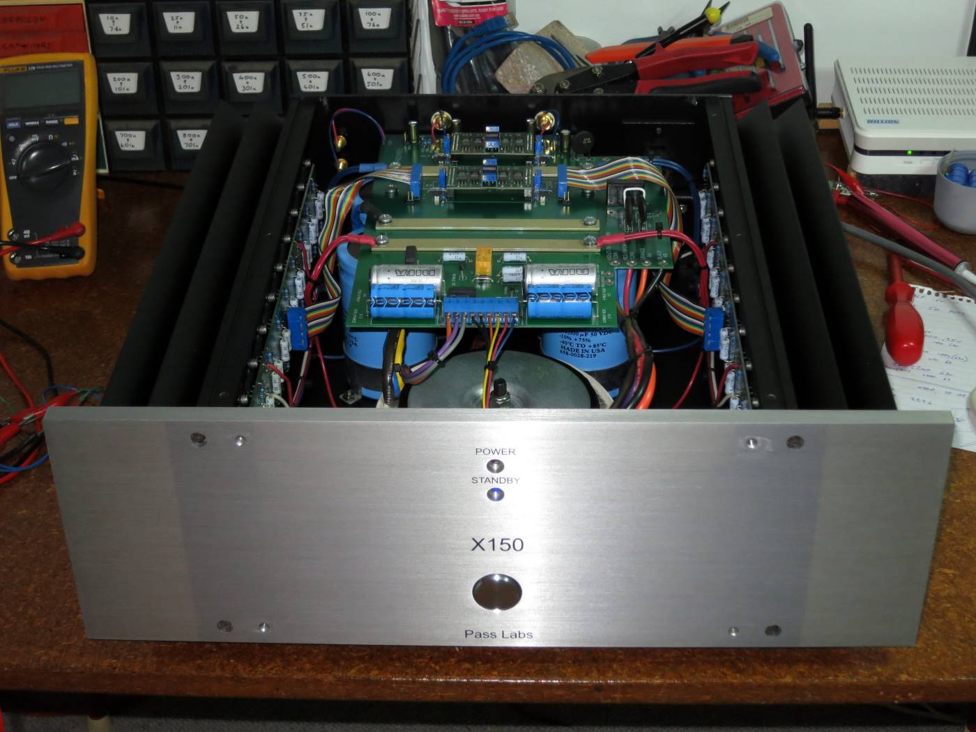

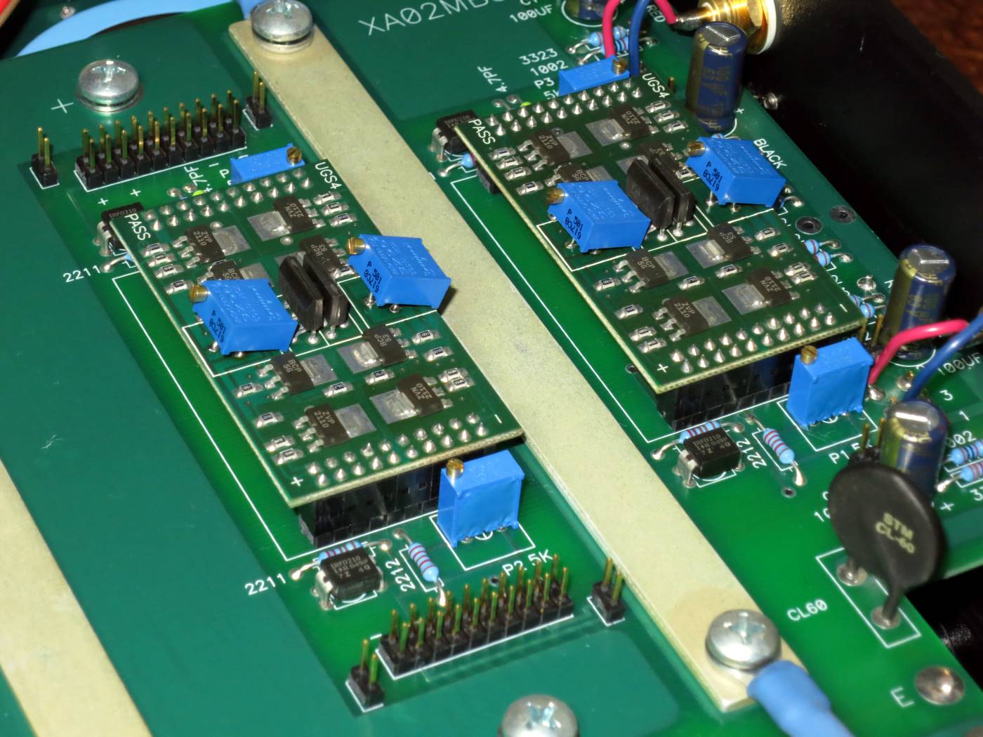

IT LIVES !!!!!!!!!!
Yes, it lives .............
got it together and just powered it up to make sure it works..
will do the adjustments over the next few days.
decided to unbolt and check the transformer washers.
ewwwwwwwwww.
previous IDIOT had done the bolt up that tight, theres a HOLE from the windings in the top rubber washer...
didnt short out, still the 'wrapping' insulating it, but come on people.
the bolt is to stop the transformer from moving. not to crush it...
so i cut some new washers out of 4mm thick rubber, and installed those either side before bolting the whole lot back in.
transformer still buzzes. doh.
that'll be next weeks project, try a 'dc blocker'...
mains voltage of 244 vac (wow, never seen it that high here before, ever).
filter caps measure 40.7 vdc.
other bias and offsets are basically as previously stated, due to presetting the trimmers while swapping them out.
Oh, and someone somewhere, decided to replace the fuse.
spossed to be 2.5 amp. this brainiac stuck in an 8 amp fuse........
other than that. nothing to report.....
im tired, and work just sacked 4 other staff today, not me thank ffff.
so i need a rest, and a serious drink before i do more.
but home stretch here i come 😀 Yayyyyyyyyyyyyyyyyyyyyyyyyy...

clean is good 😉
if i remember right, you were going to try and work out what bias i should be running based on filter cap voltages (40.7vdc).
well, the starting point before i do the temperature based final setting at any rate...
i should be ok with the info here.
but feel free to add whatever you think is needed 😉
