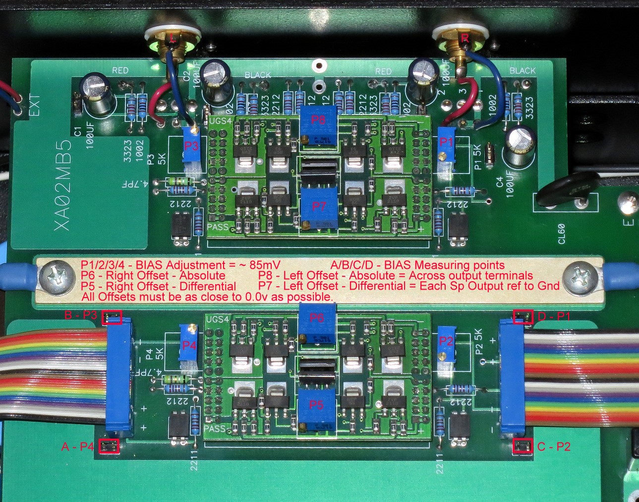

My x150...
Is running.
its sitting there stabilising after the first and second round of adjustments.
Looks promising though..
bias was ~ 0.06, now 0.090, boy has the temp gone up (will check actuall temp later)
diff offset on 'bad' channel has gone from ~10v to 0.18v
on 'good' channel has gone from ~1v to 0.004v
and for both channels the absolute offset is now 0.000 - thats the lowest i can measure before going into 'manual range select' on the f179.
The channel with the higher diff offset, i cant get any lower, im at the limit of the trimpot for that one
still, 0.2 is wayyyyy better than 10 volts. its something i can live with..
Just a major difference of settings.....
absolutely DYING to see what it sounds like now.
but being patient, letting it stabilise before going over the settings again..
then let it stabilise, and recheck them yet again.....
someone said something here about 50 degrees maximum ??

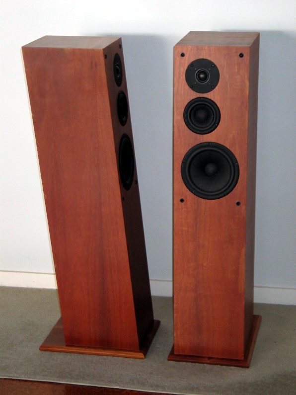

its 25 watts of fury are feeding speakers dad made many years ago.
I recently redid the cabinets (mahogany. real, solid mahogany, not veneer).
added some bracing. new crossovers..

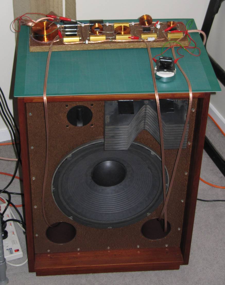

heres a pic of them being tested.
I finished them some time ago..
do you think they look, familiar
16 ohms, makes them 4333's

Alrighty.
final adjustments made.....
bias set to 0.084v + heatsinks 25 degrees above ambient. room is 28.5, heatsinks 52.5 and 52.3
diff offset 0.15 and 0.01
tot offset 0.000 and 0.000 - both flitering between + and - values
I cannot get the settings any better, their at the edge of swinging away from 'ideal' at those settings.
letting it cool down, then I'll swap it into my system for a good test tomorrow.
tot offset 0.000 and 0.000 .....
clarify ;
you mean offset between outputs (diff) is 00000 ?
I know that X amps are much firmer keeping diff offset than absolute/relative one ...... ...... which one !??!
anyway - I notoriously cannot remember that nomenclature - which offset is relative , absolute , but I'm always thinking of these values directly - offset between (hots ) outputs and offset between any (hot) output vs. gnd
so - it seems that you too mixed these two terms
what's absolutely important is to have 0 between hots - where speaker is connected
few hundreds of mV between any hot vs. gnd is not critical at all

the offset that references to ground, thats the one that on one channel is 0.15v
the offset across the output terminals is 0.000 on both channels..
as you say, the important one is zero...........

there ya go. this should make it easier for those to come
Theres four more jumpers at the back of the board.
I didnt play with those, but I imagine they will be 'test headers' for the offset adjustments.

these 4 jumpers (each one near one correspondent cap ) are for input caps shorting , having that way DC coupled inputs - as possibility
probably is best to leave them as is
I'm still not sure about absolute-diff-relative offset terminology , but you wrote real meaning for offsets ( between hots and hots vs. gnd ) so that's OK
