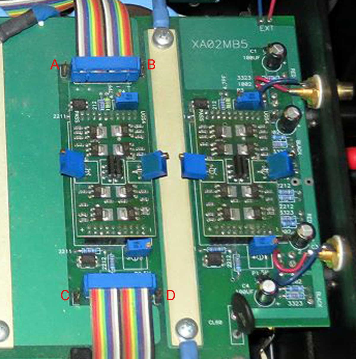

checkin' bias :

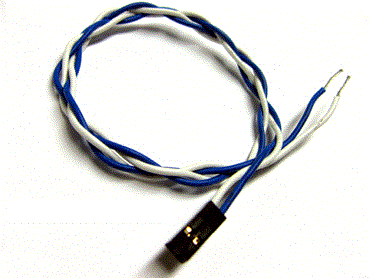

most convenient way is to have 2pin connector ( as on picture ) , so you can route wires out from case , with lid on ;
having lid on while checking is not exactly crucial , but handy ..... because you're not disturbing temp. equilibrium .
for channel 1 - connect 2pin connector either on header A or B ( no need for checking both positions , at least as long amp is operational and output offset is near zero) , connect voltmeter between wires ; goal is to have 0V94 +/-10% there when amp is on working temperature ..... as Papa sez :clown:
repeat procedure for channel 2 , using either header C or D
while you are there - with DVM in hands - check voltage (offset ) between outputs ......... and between any output and gnd ; so regarding output offset - you have 2 measurements per channel - one for absolute , and one for relative offset , because both (channel's) outputs are hot - floating ......

Now, measurements.
amp has been on for several hours in use to warm it up and let it stabilise.
no load or input connected.
All done with a fluke 179.
measuring those jumpers (prev labeled a/b/c/d)
gives 0v071 and 0v069
nothing like the 0v94 ZM suggested..
total dc offset - - - - - - - - - - - - - offset ref chassis gnd.
good side, 0v05 - - - - - - - - - - - - 1v9 - both 'pos/neg' outputs so close.
repaired side, 0v001 - - - - - - - - -- 10v67 - both 'pos/neg' outputs so close.
yes, thats right, one side is 1.9 v other side is 10.67 v.
just a wee tiny difference. NOT.
so, I reallllllly do think it needs a damn good reset....

just for a giggle
turn it off , wait 5 mins ( to be sure that caps are bled down) and measure resistance between pins on each header A, B , C ,D
while you're there - inspect visually values of those 3W Pana source resistors ;you can check them with DMM if you can't see the value
something is highly illogical - amp is hot , even if DVM says it's seriously underbiased
edit : just in case - I hope you measure voltage at headers when amp was fully ON , not in stand by :rofl:
:rofl: wall of text :rofl: :
at UGS pcbs :
P1 is for absolute offset ( offset between each/any output and gnd) ; must be 0V
P2 is for differential offset (offset between outputs) ; must be 0V
fiddling any of these will influence operation of previous one ; so - setting is iterative - in small increments - alternative fiddles of P1 and P2
at Motherboard :
P1 and P3 are pots for biasing adjacent output sides of one channel
P2 and P4 are pots for biasing adjacent output sides of second channel
reference measuring points are nearby 2pin headers ;
I need to confirm which pot is connected with which 2 pin header -will edit post later
OK - that's sort of explanation ;
do you need exact procedure written down ?
edit :
P4 - header A
P3 - header B
P2 - header C
P1 - header D
