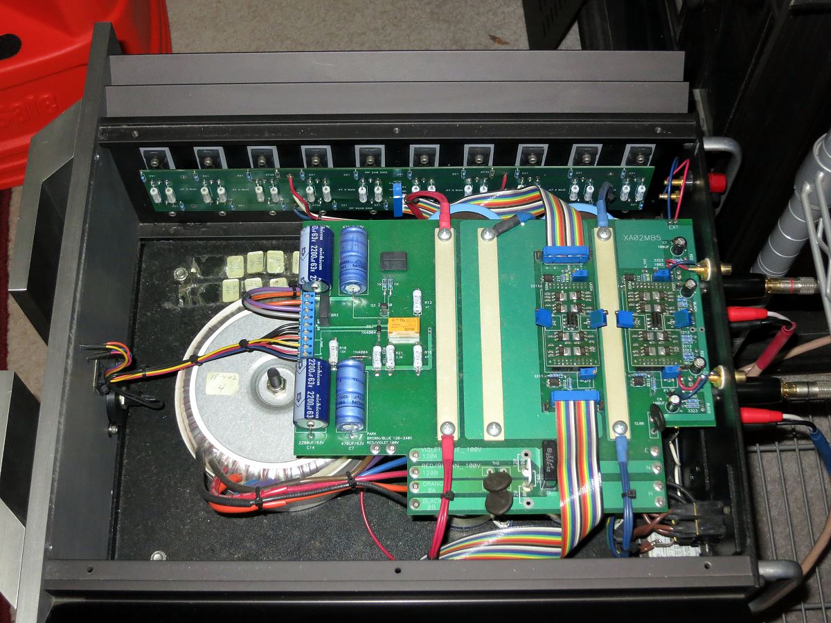

Its been a hot day at work, and im tired, so heres a few really qick pics for you...
Its dusty, really dusty, so what looks like scratches, arent, its just dust.
any way of telling age/version from the serial number ???

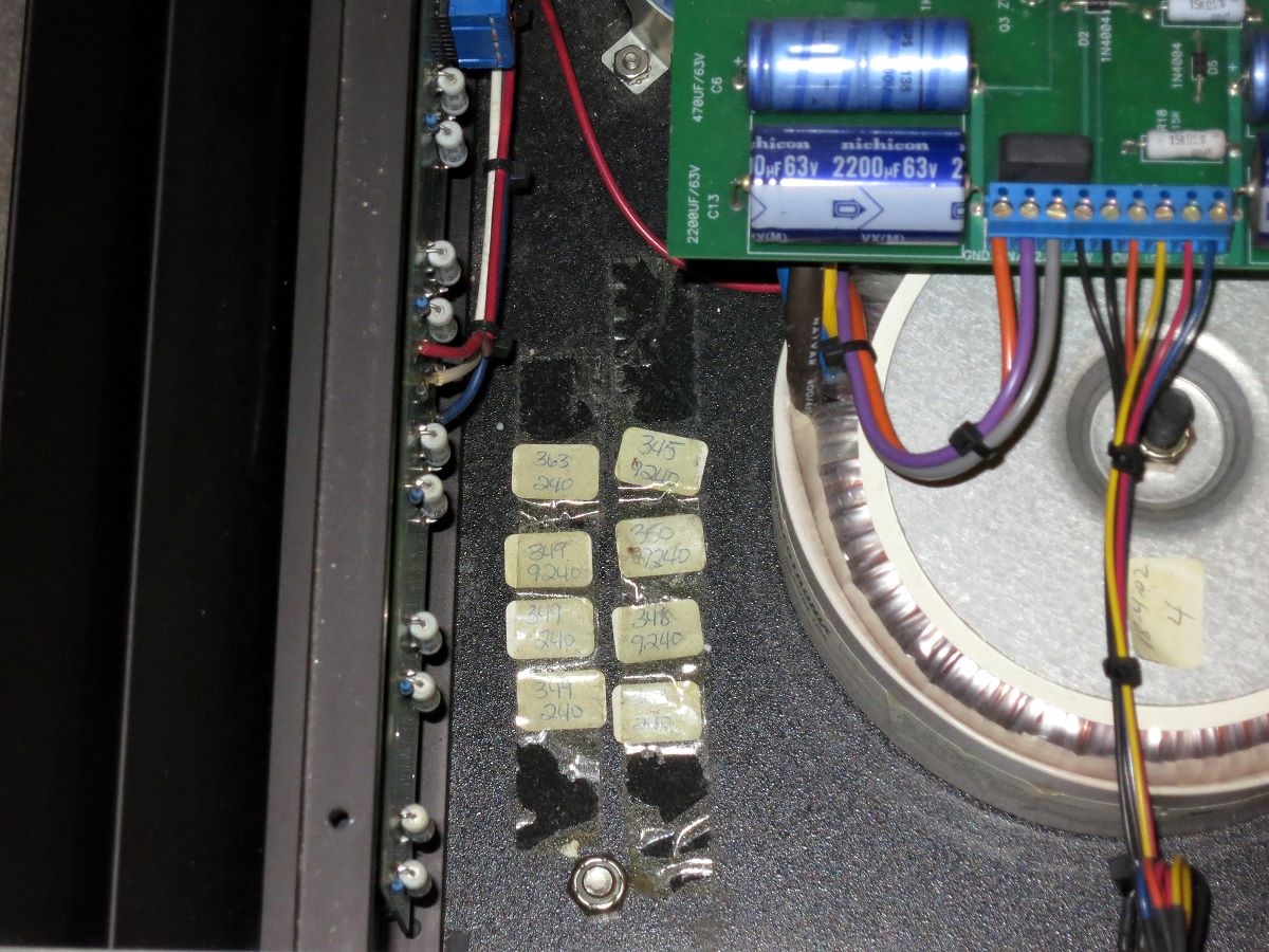

Well, I now know it's birth date... Little sticker on the transformer - 18-4-02.
Interesting 'notes' about the outputs specs..
Obviously its never been opened before today.

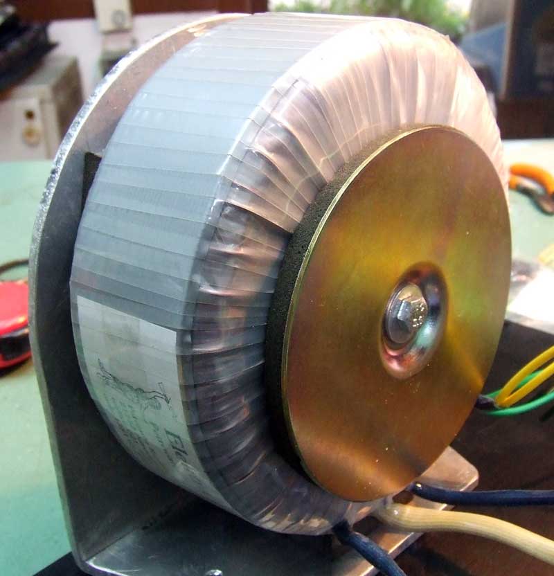

I have but one question now.
Is it normal to be able to hear the transformer buzzing from 10+ meters away ???
If not (and even if it is) I'm going to need to replace the transformer.. doh..

Yes. I've never heard a noisy one yet though..
My current (old) amp has 3 of them. 2 x 300w, 1 x 50w, and their all silent.
oh well.
I did try pushing down on the mounting washer, made the noise worse.
will try loosening it tomorrow, see if turning it and reseating it has any effect.

some xformers are more prone than others to buzz if you have slightest amount of DC in mains
unfortunately - there is no other way to test that , than to make DC blocker , even just as test gadget
considering that you're well aware of mains voltage lethality , that's piece of cake
just search for DC Block at forum
but! , try to loosen that screw first ; in your boots I would place ring made of some soft rubber (spongy rubber - dunno exact name in English ..... it's Schaum Gumme
in Deutsch) both between xformer and case , and xformer and round plate
something as attached
there is big possibility that xformer is squeezed during transport , and just loosing that screw will cure that buzz
edit: later tonight I'll write you what's role of these 2-pin headers on both sides of flat cables
in short -(for start) just check are you in ballpark of 0V94 between two pins , when amp is fully warmed up ; while you're there - check output DC offset , too
Looks like it has to me, for repair.

the supply wiring from the bridge to the filter caps looks a little 'thinner' than i would've expected.

Ooooooo ok.
i must admit, i was, suprised, at the trimmers appearance..
there high quality ones, but the way there sitting doesnt seem, in keeping with the rest of the magnificent build quality...
the soldering seems, pretty decent, looks like they did a good cleanup afterwards.
theres a uniform layer of dust through out, so id suspect the 'repair' was quite some time ago.
what were the original trimmers ?? single turn carbon open frames ???
JV, why do i get the idea that you've worked on these before
mmmmm, ok.
looks like they've all been replaced with bournes 3286.
a 12 turn .25w trimmer..
original was a single turn .5w
wonder why ??

just leave everything as is ;
check what I said
stickers/notes look genuine to me (but I can't be sure 100%) , at least according to few lines in SM I had opportunity to read .
dunno for trimpots but - hey - moi anyway more like convenience of multiturn .
for schematic - there is only one gray beard around , to be asked
before
Me no repair guy, very non-competitive hour rate
Not the labels per se, see those in several (older) X models, but number. Easy to check for tampered output boards.
Repair can be service, even enclosed trimpots can go walkabout if a pound of dust is thrown in.
Minus the trimpots, very decent looking amplifier, imo.
