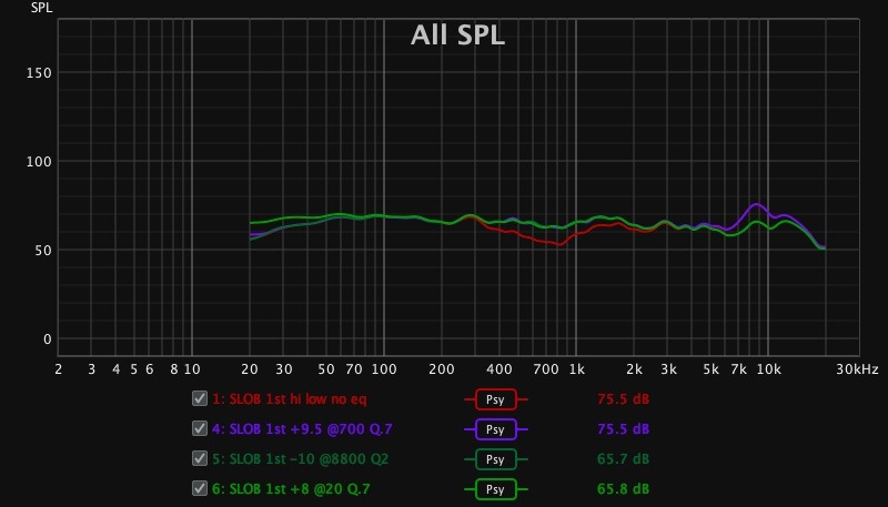

I have not tried any other woofer in the SLOB to compare, but the Bianco plays really clean, really low. Could not be happier. The below bright green line is the Bianco with the Lii fast 8, and minimal boost and correction. The Bianco played really well without any correction right out of the box. These measurement were taken a 1 meter at the height of the Lii driver, in room.I've been intrigued by the SB Audience Bianco-15OB350. Perhaps I'll finally spring for a pair one of these days.

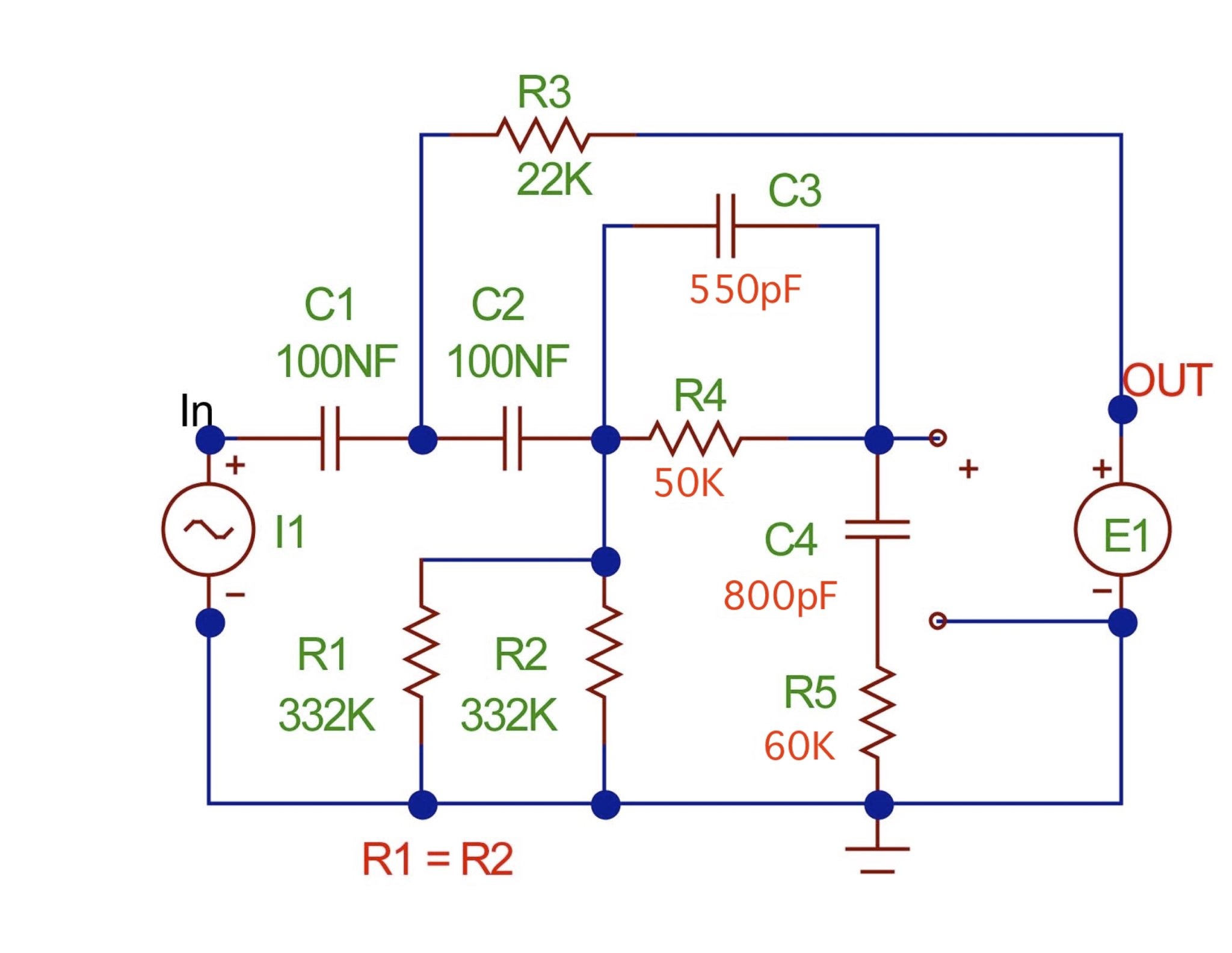

Dear fellow SLOB-builders,
has anyone of you using a Lii Fast-8 managed to tame the whizzer?
Some music drives me to tears for its liveliness but some other (most rock) music with lots of cymbals
and fuzz-gits makes me wanna puke. Distorted high mids drilling in my ears.
I've tried different c-values for the FR-EQ and endet up with C4 2n2, C3 47p and P1 on minimum R.
Have you found better values or do I have to swap the fullrange?
I've even tried my old maggies(SMGA) as Slob-top but they sound dull and muffled in comparison.
Help!
Attila

Thanks Nelson and WBS,
you might just have overread this. but ->
"...tried different c-values for the FR-EQ and endet up with C4 2n2, C3 47p and P1 on minimum R."
With larger caps I leave the desired area of damping. Maybe if I reduce the resisor further to (what's its minimum?).
See pics in post 514

Here is what I was told...Not sure if this is true physics: "Every fullrange suffers breakup modes, where membrane no longer moves in unison, but parts flap up and down. This is cause of uneven frequency response and delayed resonances. Every fullrange suffers from this. The bigger the cone, sooner the breakup starts. If you select small fullrange, highs may be nice with little breakups. But no bass. If you select big fullrange, you can achieve bass, but highs will suffer. Its all compromises."

I repeat, it is perfectly normal for fullranges to have a strident upper midrange. That is a good part of the reason Nelson made the F1 and F2, and also the full range crossover now listed in the store. Check out its curve, you’ll see. In essence: transistor amps and full ranges often work badly together, due to the low Zout in part. So, I support your plan to test series resistance.I've tried a few different sources, CD's, two different turntables with MM cartridges.

There it is, with a quote perhaps pertaining to your experiences:
«By comparison, the “best” solid-state state amplifiers make them sound more like transistor radios – less bottom and a, occasionally strident upper midrange. If you are a solid-state kind of guy (like me) you start wondering how that could be, and if you are a tube aficionado, you smirk and say, “I told you so.” The solid-state guy probably starts fixing the response with a parametric equalizer, and the tube guy enjoys his music with a nice glass of wine.»
And this, the el cheapo fast possible solution:
«Most of the examples we will examine do not require true current source amplifiers, only amplifiers of quite high output impedances. Most of these cases will be happy with an output impedance of approximately 47 ohms or so and prefer 47 ohms loaded in parallel with the output of a current source. That being the case, you can build a Thevenin Equivalent of such a current source by placing a large resistor (here later referred to as R0) in series with the output of a high wattage voltage source amplifier and get similar results.»
Note: midrange stridiness may or may not be solved, but you will most likely hear a differense, and possibly it will be for the better in some aspects.
