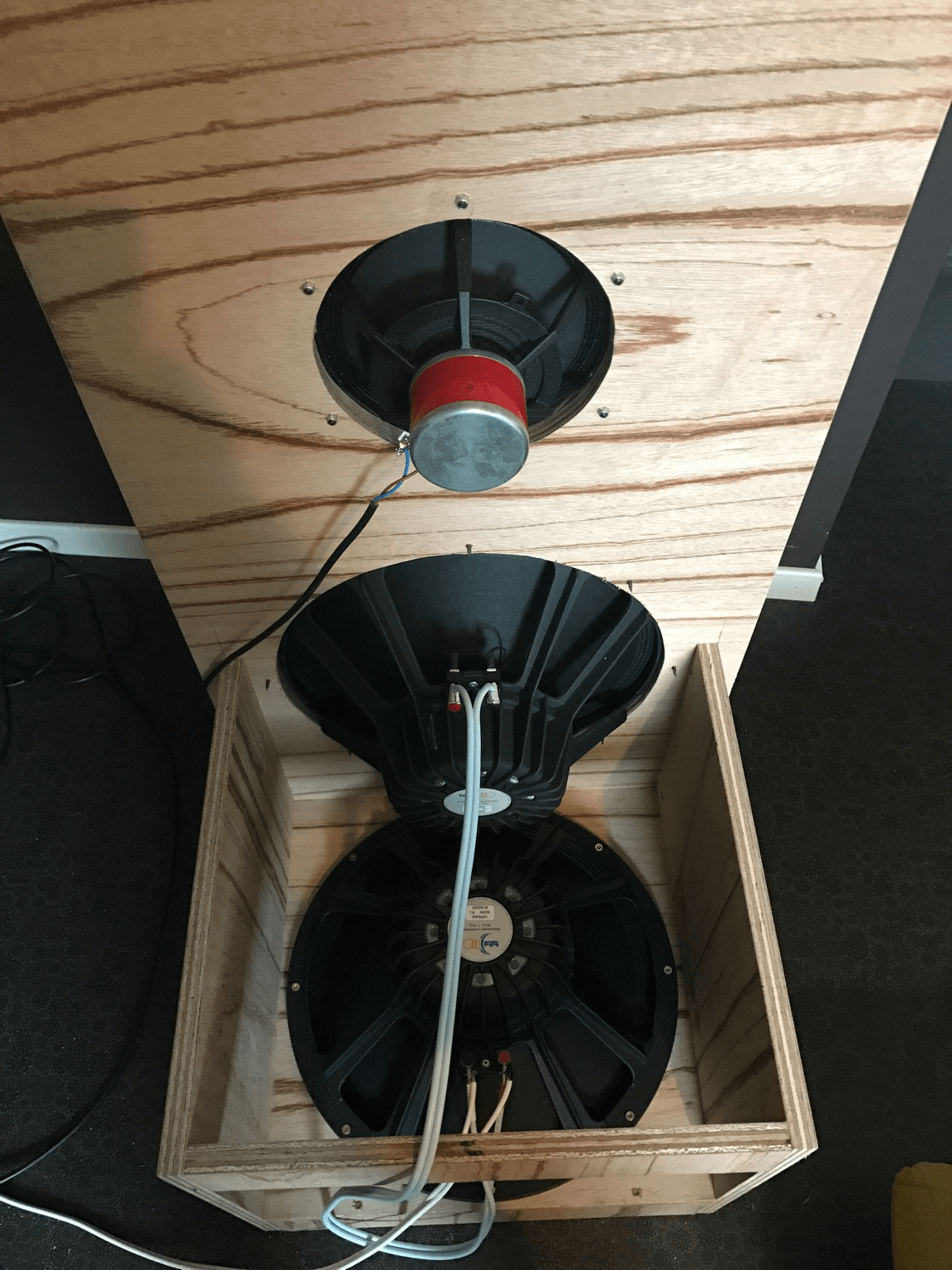

It doesn’t address the question of two woofers being at nearly 90d angles on their backwave to each other though.
I found very early in this thread this example built with both woofers. Measurements with each individual woofer and both look to all make sense, with no obvious cancellation issues. So I'm not really sure what to think from a cancellation point of view.

The wings make sure that some cancelation is eliminated. The slot have another purpose. Using both a front woofer and slot woofer could be done, but I don't think it's that easy. The cross over should be changed. It's the wavelength of the woofer output that that determines the cancelation, and not the angle of the two woofers.The point of having that slot is to make sure the front and rear waves don’t cancel out. How are you ensuring that for the front-facing woofer?
Going for two woofers I think better options exist. W frame, Ripole, slot loading with woofers opposite etc

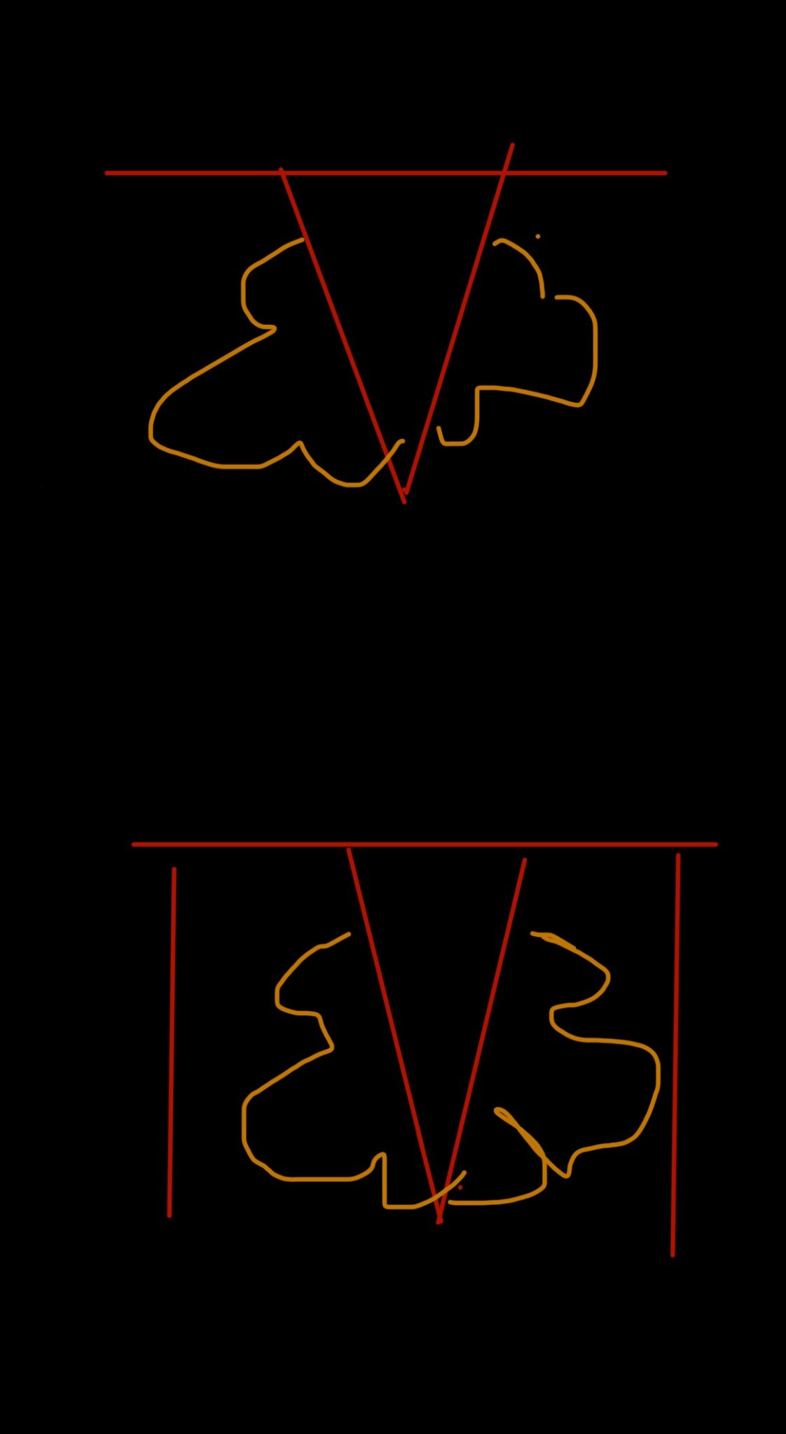

How about doubling the slot area, in a "V" configuration. and turning it vertically, mounting the two drivers on each side?

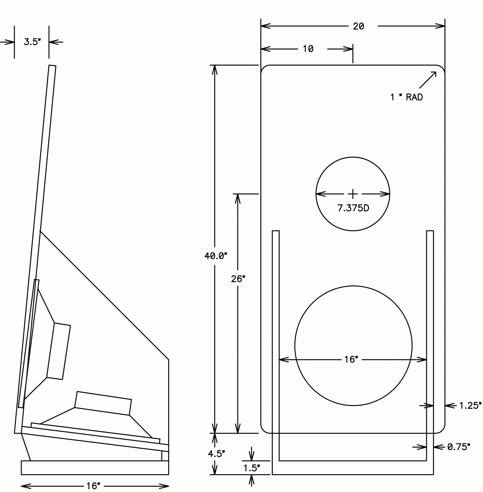

Nelson's idea of opposing slot loaded woofers was an upgrade to his AMT-3 prototype while working at ESS back in the 1970s. You can find the details in his 2011 article published at enjoythemusic.com. I believe this is the original inspiration for the SLOB project that the OP first inquired about.
Keep in mind, "When you build a slot loaded cavity like this, you will run into a cancellation frequency that occurs when the wavelength is twice the depth, where the pressure from the part of the woofer which is deepest in the slot is one half the wavelength and cancels out the pressure from the portion of the woofer near the slot opening. Here the cancellation occurs at 500 Hz."

Would you use a wing behind the woofer still or leave them open?How about doubling the slot area, in a "V" configuration. and turning it vertically, mounting the two drivers on each side?
If you were using an outer wing, you'd be getting closer to a ripole alignment?
You’d end up with 4 sides of a cube, rather than 3 as per the normal slob or a version without the outer wings.
Forgive my crude sketch:

On my present design, I'm hoping to just use small 1x6 wings on the baffles on the sides, similar to the Manzanita OB speaker. Another thought would be "Besty" style baffles, on piano hinges, that can be pulled apart.Would you use a wing behind the woofer still or leave them open?

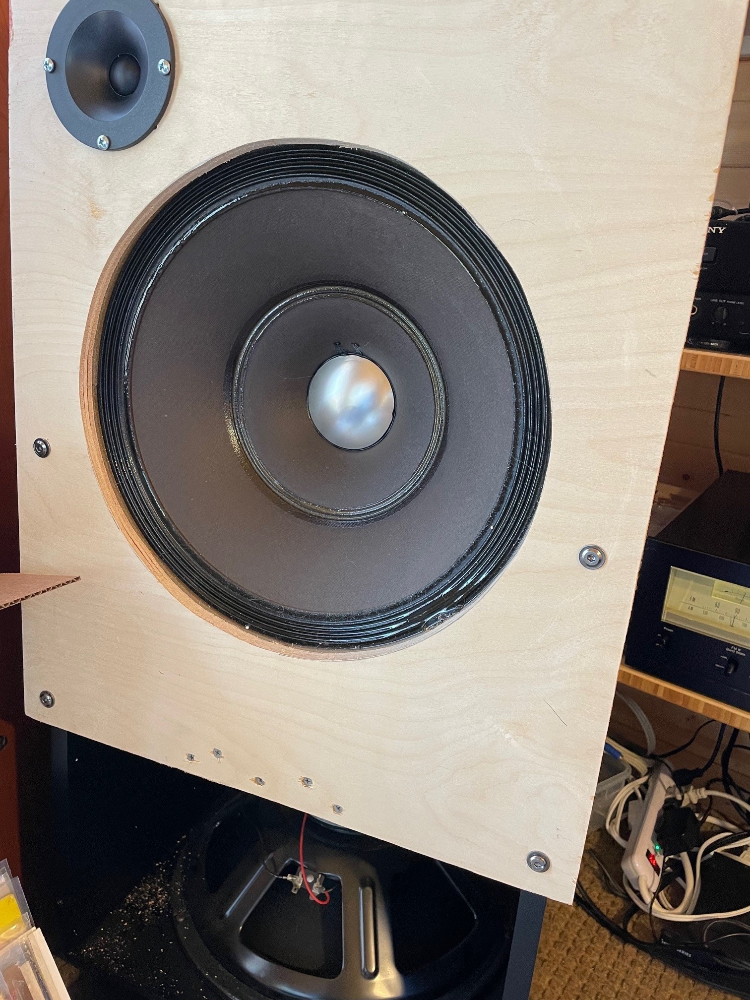

To ZM's point from another thread, did a tweeter upgrade. SLOBs from bottom to top are Eminence Beta 15 in the bass slot, Altec 420a and the first iteration were cone tweeters that were pulls from the old school console that housed the Altecs. Upgraded the tweeters to ScanSpeak soft domes, with just a first order Solen cap, that's how it was done in that old console. 6-24 crossover and biamped. New domes add clarity and specificity; I can really hear the drummer's brushes on a Bill Evans track.
