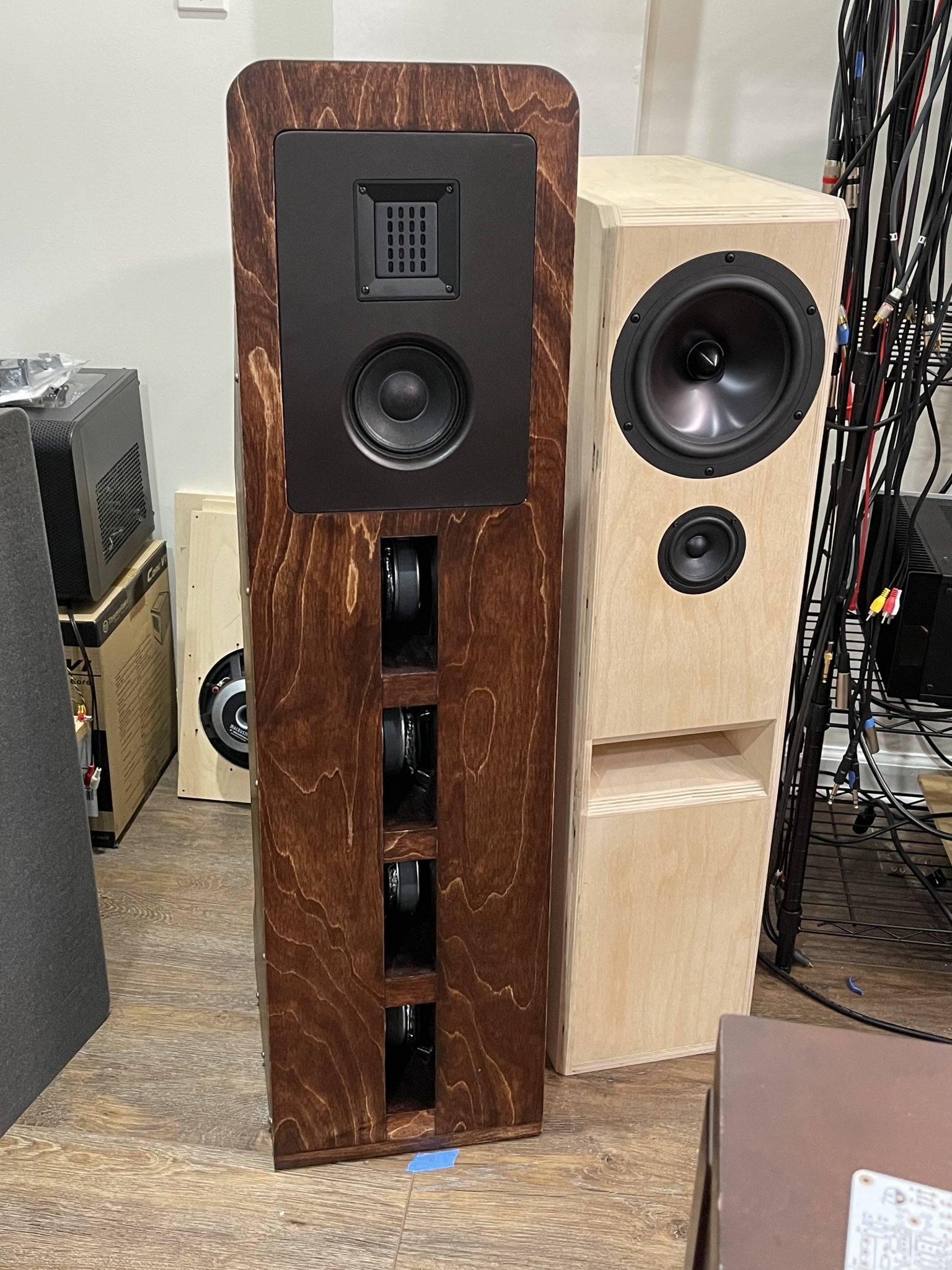

SLOB can go higher than 200 hz, but not with a 15 inch. Some use many 6 inch in order to have both a lot of cone area, and a cavity that is not very deep.

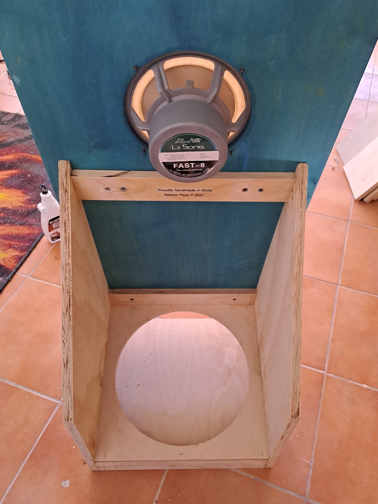

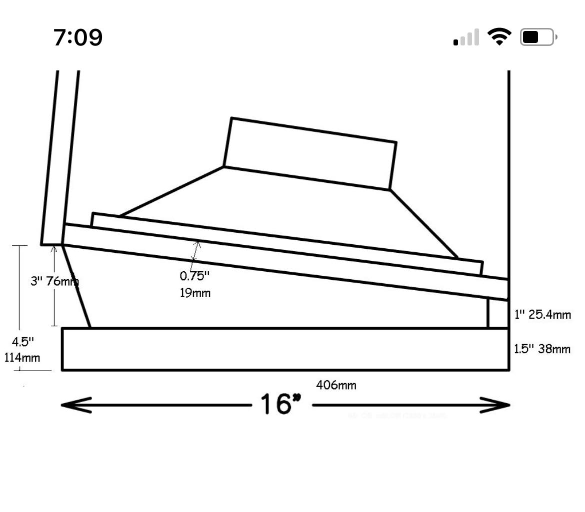

Hey folks. I have 2 questions regarding this design. First is there a more complete plan available then the diagram shown above? There are some measurements missing. For sale maybe?
Second one is, can this basic baffle with bottom woofer be applied to other larger drivers, if one was to do a dsp / biamp setup? I have a Lii Audio (Xizi) Fast 15 arriving in a few days. Plan on throwing together a smaller test baffle at first, then will determine the next step forward.
John, I did find this picture somewhere on diy audio, but I can't remember where (there are several threads). Get a few blank pieces of paper and draw each part that your are going to cut with the dimensions. Then make sure that the parts are going to fit with each other. It should just take a little math to figure it out.
Thanks, I guess there is enough info to come up with a good idea on measurements. I will search around for more on the site.John, I did find this picture somewhere on diy audio, but I can't remember where (there are several threads). Get a few blank pieces of paper and draw each part that your are going to cut with the dimensions. Then make sure that the parts are going to fit with each other. It should just take a little math to figure it out.View attachment 1257426

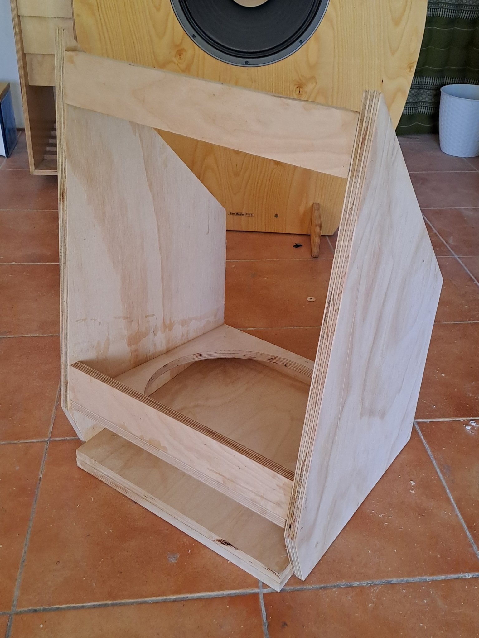

I haven't bought my helper bass driver(s), so I will entertain that style.
Very slow build for me... 🐌
Here's the whole process:
https://www.flickr.com/gp/194234898@N02/ED1s5XpmrJ
