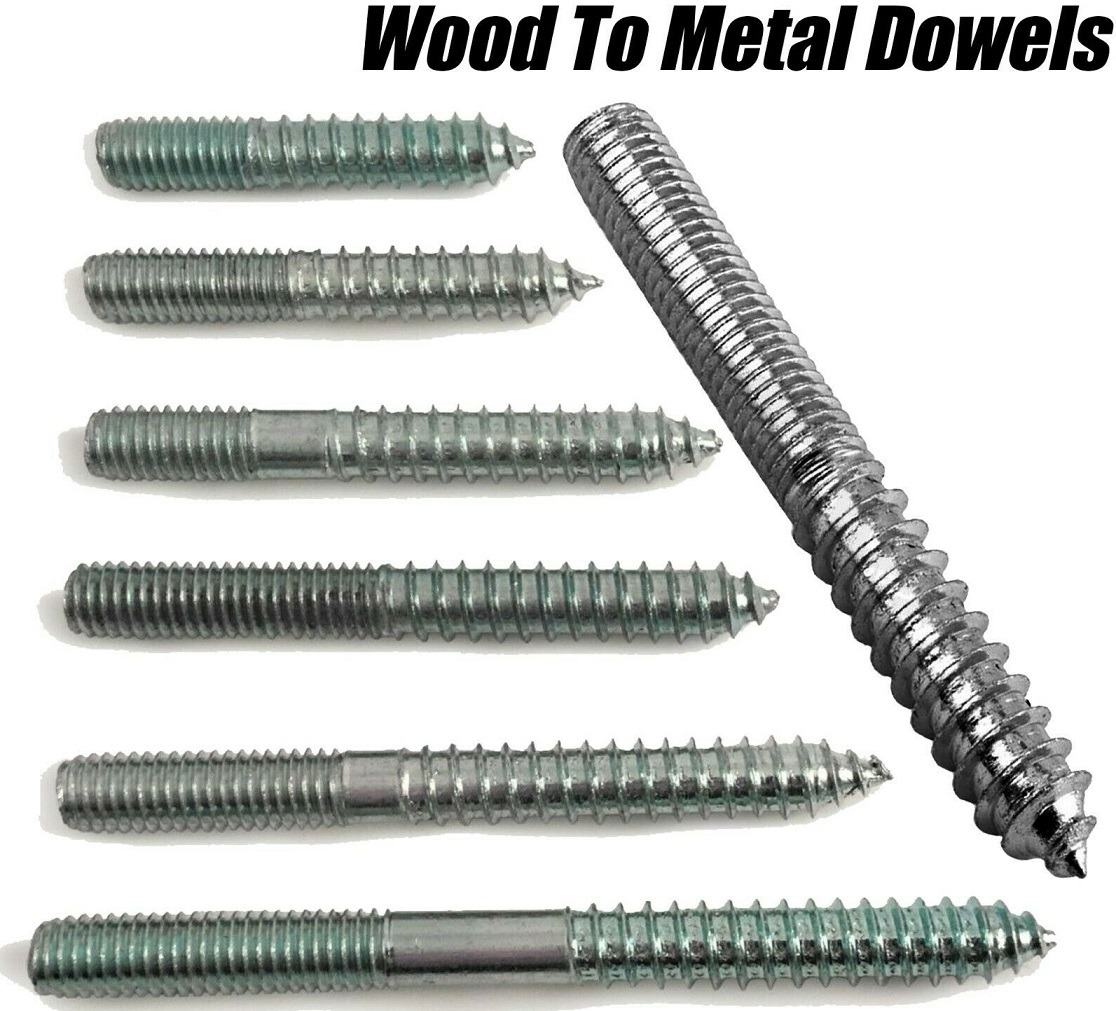

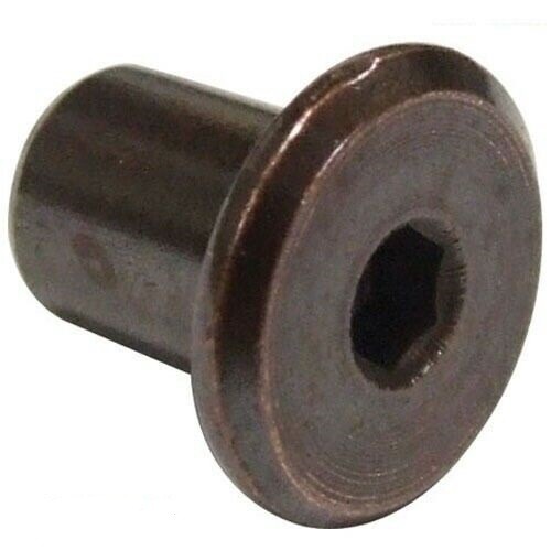

Nice work. Are the baffle studs tapped into the wood or do they have some kind of insert?
The studs are double ended 'wood to metal' dowels. I glued hardwood blocks into the side panels to give them more purchase and also used epoxy glue to secure them. The baffles use blind furniture nuts to bolt them onto the studs.
