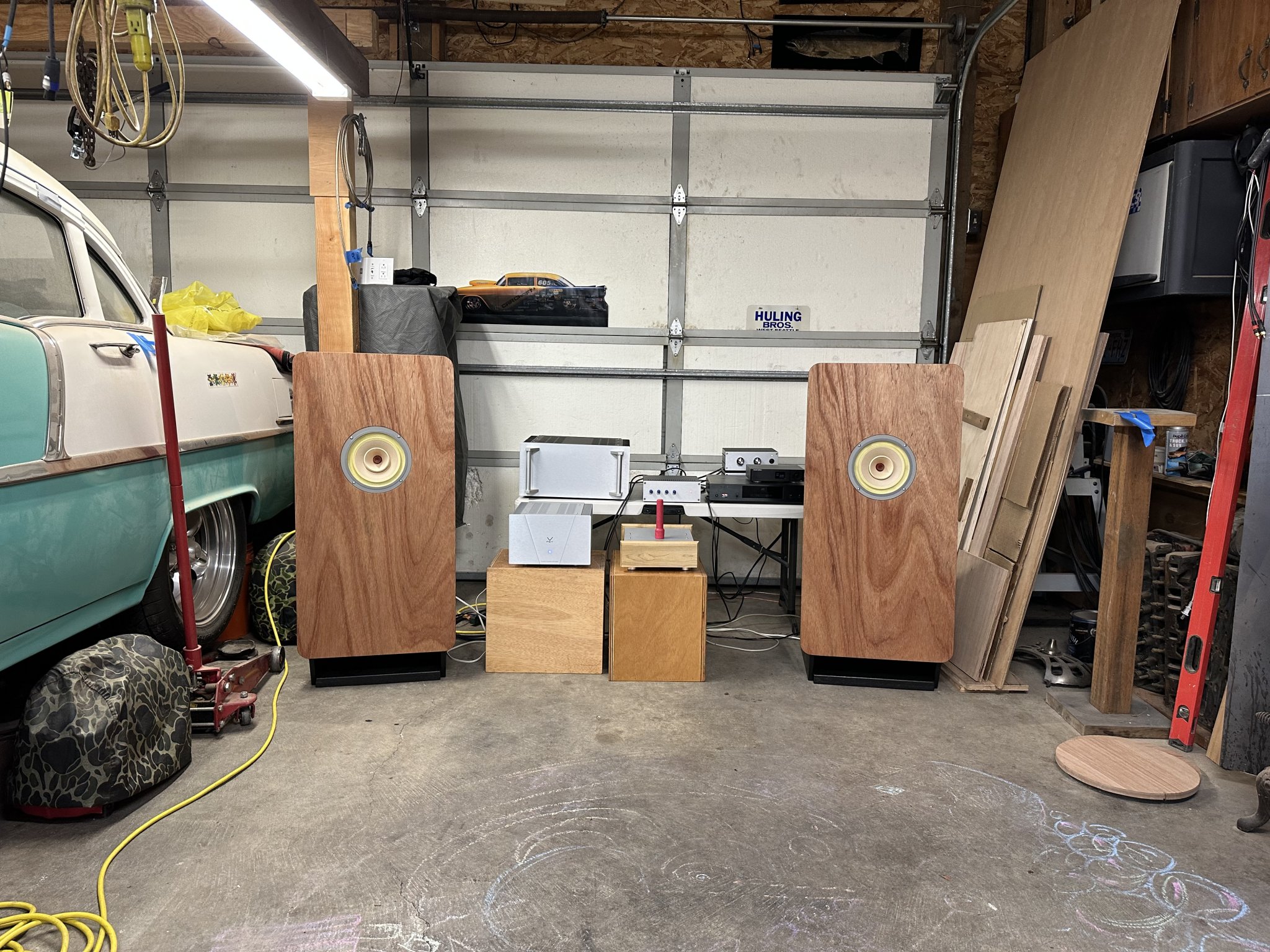

Congratulations….the speakers are like Pass amps…..detailed sound flows effortlessly from dead silence with lovely tone. I’m using ACAs at the moment but we’re on the same wavelength: I have the VFET modules for the wide range SAL driver and F-6 boards and transformers for the bass amp….
Not for long sucka! Remember there are 2 more amp channels you can’t see. All soon to be in big boxes with big manly heatsinks!that's Proper Papafollower, Iguana Style! Xover stage is bigger and weightier than 2 monoblocks!
