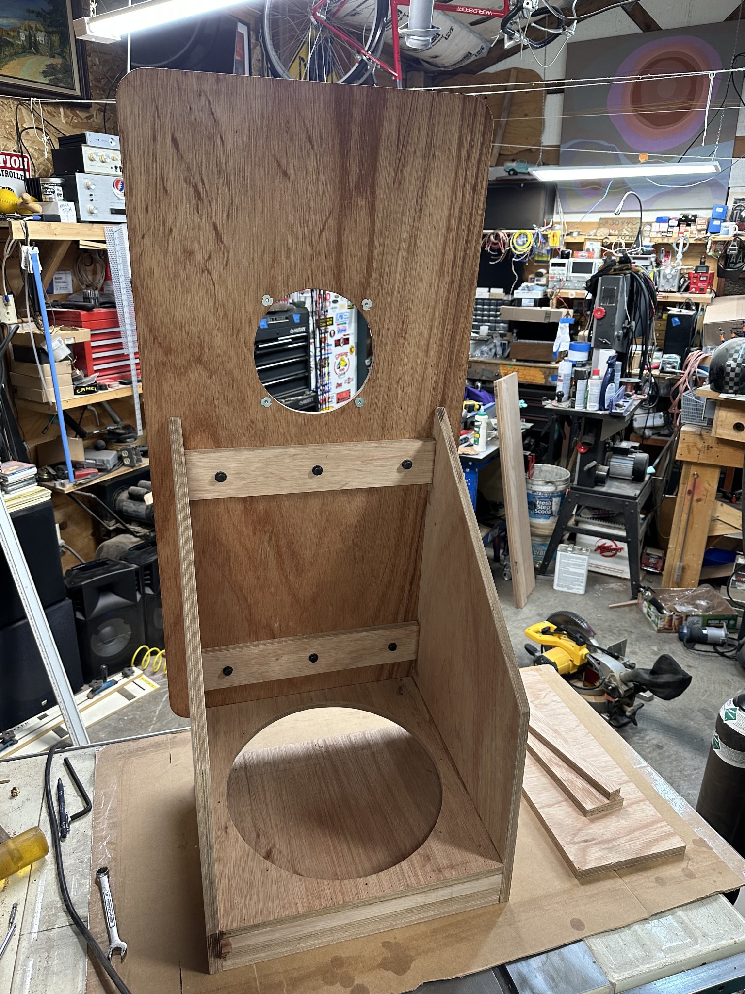

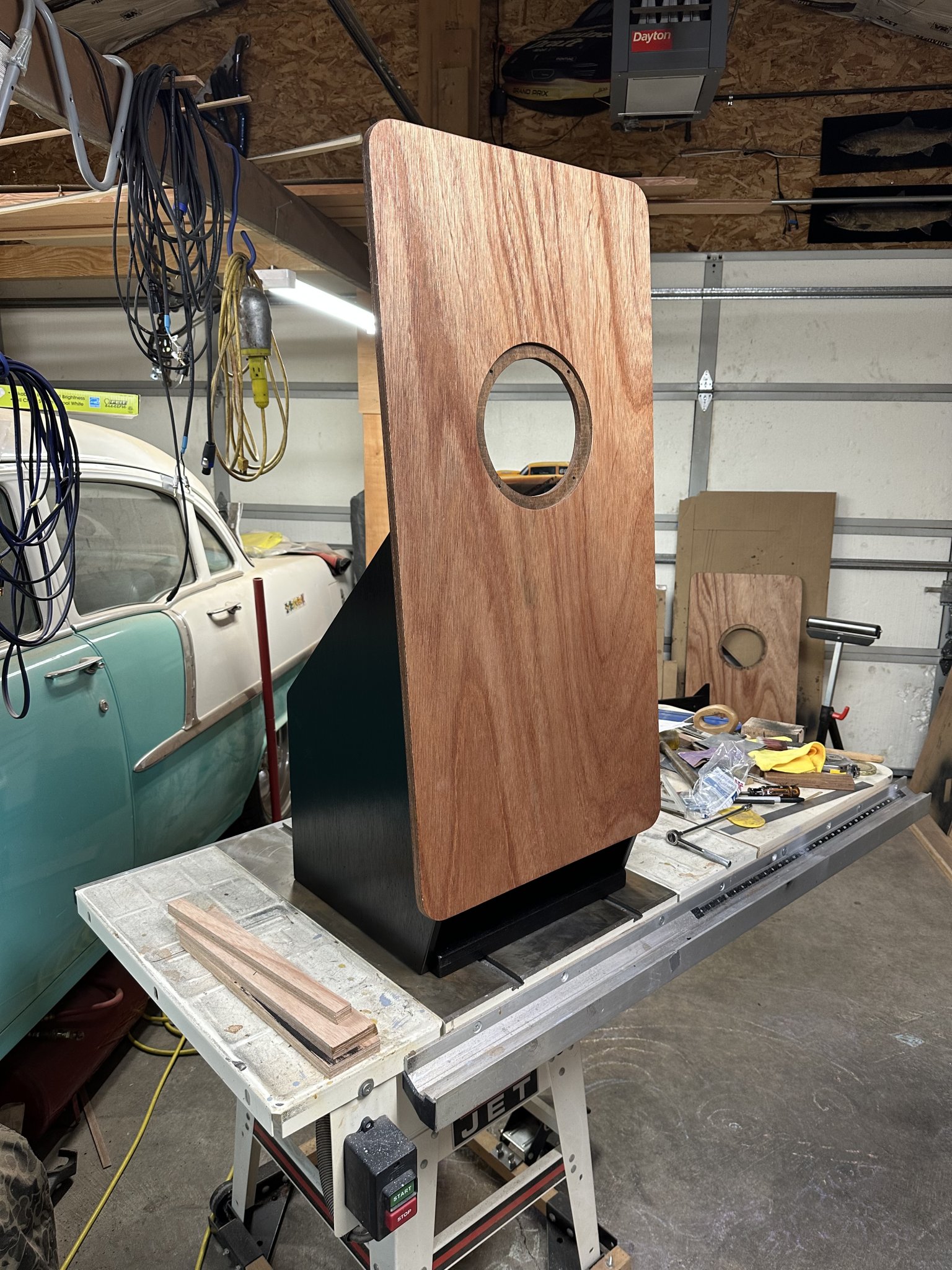

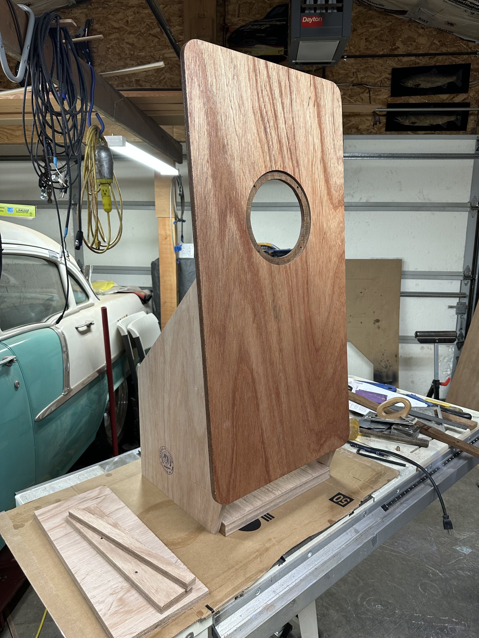

Tung oil over mahogany marine plywood.Great work
[EDIT] What kind of finish did you use for the front baffle? It seems an oil...

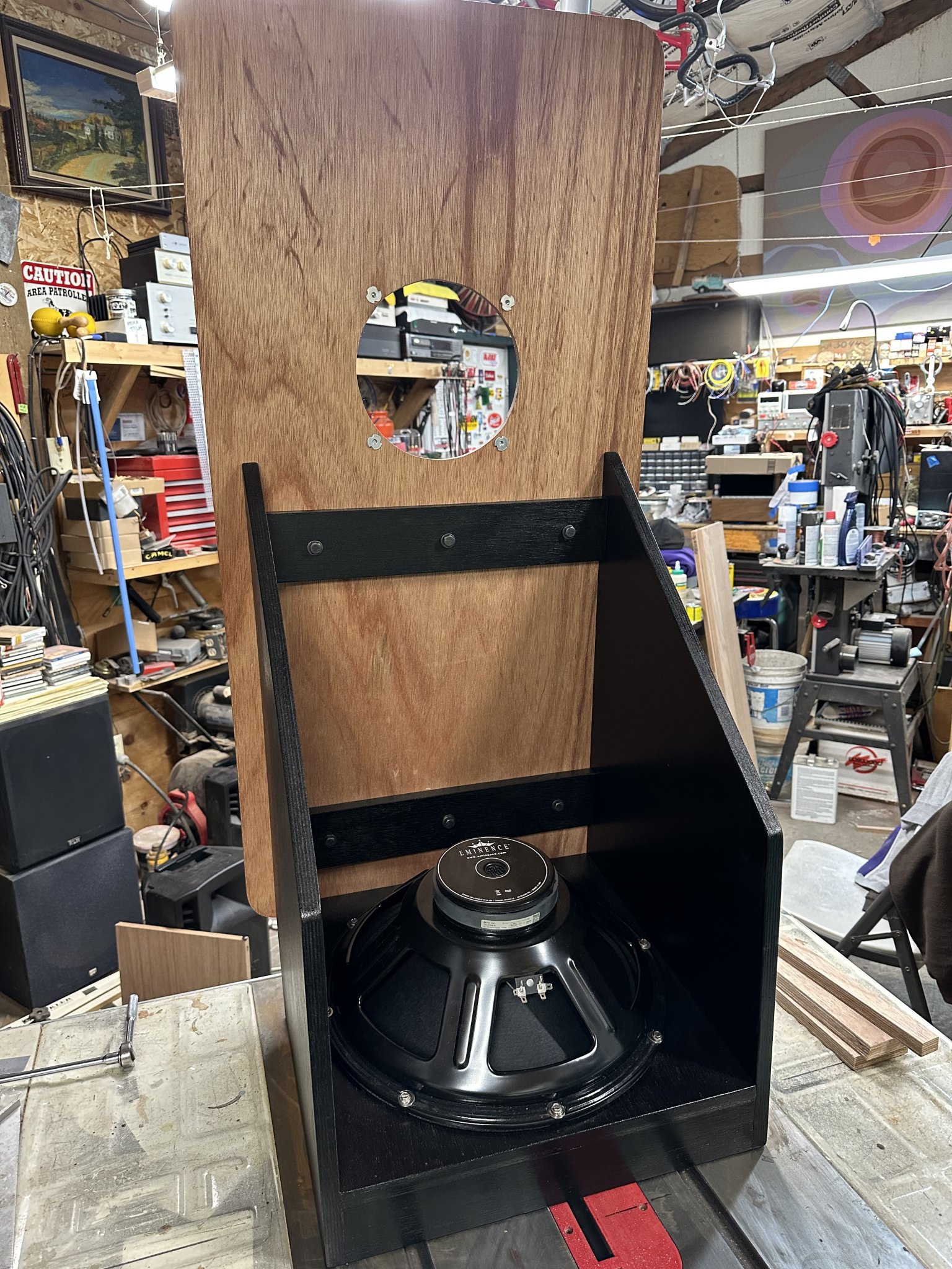

Any reason this couldn’t be done with an 18” woofer?……since I have a pair lying around…..no use wasting em
No reason that I can think of. You'll need to widen the wings enough to accommodate their size. Doing so might require widening the baffle a little in order to attach the wings.Any reason this couldn’t be done with an 18” woofer?……since I have a pair lying around…..no use wasting em
Make sure to take pictures and post them so we can see!

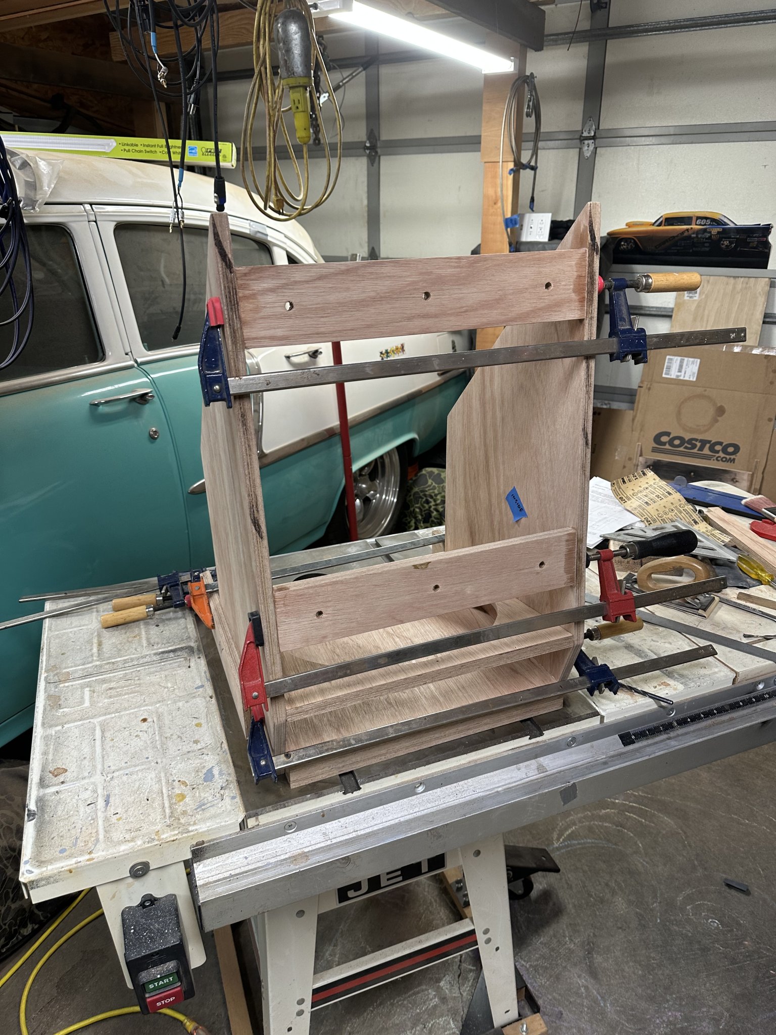

Nice shop! No wonder you're so fast building these. They're looking good. Is the '56 in running condition?Progress
Just proportion the original drawing to fit your 18”Any reason this couldn’t be done with an 18” woofer?……since I have a pair lying around…..no use wasting em

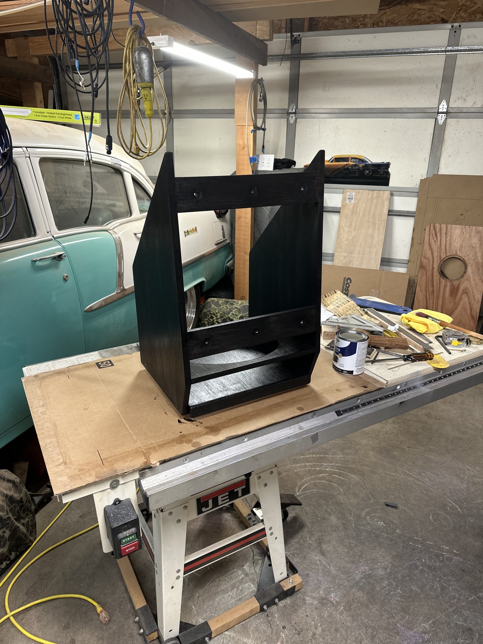

what woofer in the end you put in ?This weekend I'll assemble mine. Maybe a dual colour finish...
Remarkable resemblance between our speakers and our shop areas...
Yes, I think SB Bianco 15OB350, but I'll aso try my Eminence Delta beforewhat woofer in the end you put in ?
