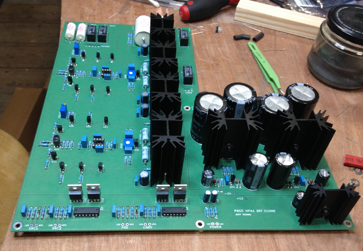

I built up my power-on-set and power-on-clear logic into SPICE, and it did what I thought it should do.
So I built it up on the breadboard (again), and it worked there too.
But on the real PCB the CLR line was being held high, and one of the flip-flops was getting hot. 3 of the flip-flops are wired identically, so the odds pointed to trouble with the one that was getting hot rather than a design or layout error.
Of course the flip-flop is in a 14-pin package whereas the IRF610 it's driving is in a 3, so the 610 came out first. No joy.
Next out came the flip-flop. (And the capacitor next to it after a close encounter with the soldering iron.) The CLR line now came down nicely after startup, and the other flip-flops started working correctly. In went a new flip-flop, IRF610 and capacitor, and everything is ducky.
It's pretty humid in Ireland and I'm pretty careful about grounding myself, so I doubt it was static. Might I have overheated it when soldering? (The part in question is a CMOS CD4013.)

CD4000 series logic is reasonably well engineered for ESD hardness so I suspect either (a) you had bad luck and got a dead part right out of the tube; or else (b) your circuit has a connection error which destroyed the chip. If you install a DIP socket you can cycle through three or four brand new, fresh, virgin chips. This will tell you whether that one original part was dead, or whether your PCB itself is the culprit.

You mentioned that "everything is working fine through several power-cycles. So there could still be some edge condition". In my experience, those little glass passivated didoes could go faulty, but only just, the consequence of which would manifest in the way you described the problem. To detect a dogy diode, it was necessary to lift one end off the PCB, hence my suggestion.
But if it's all good then Bob's your uncle.
