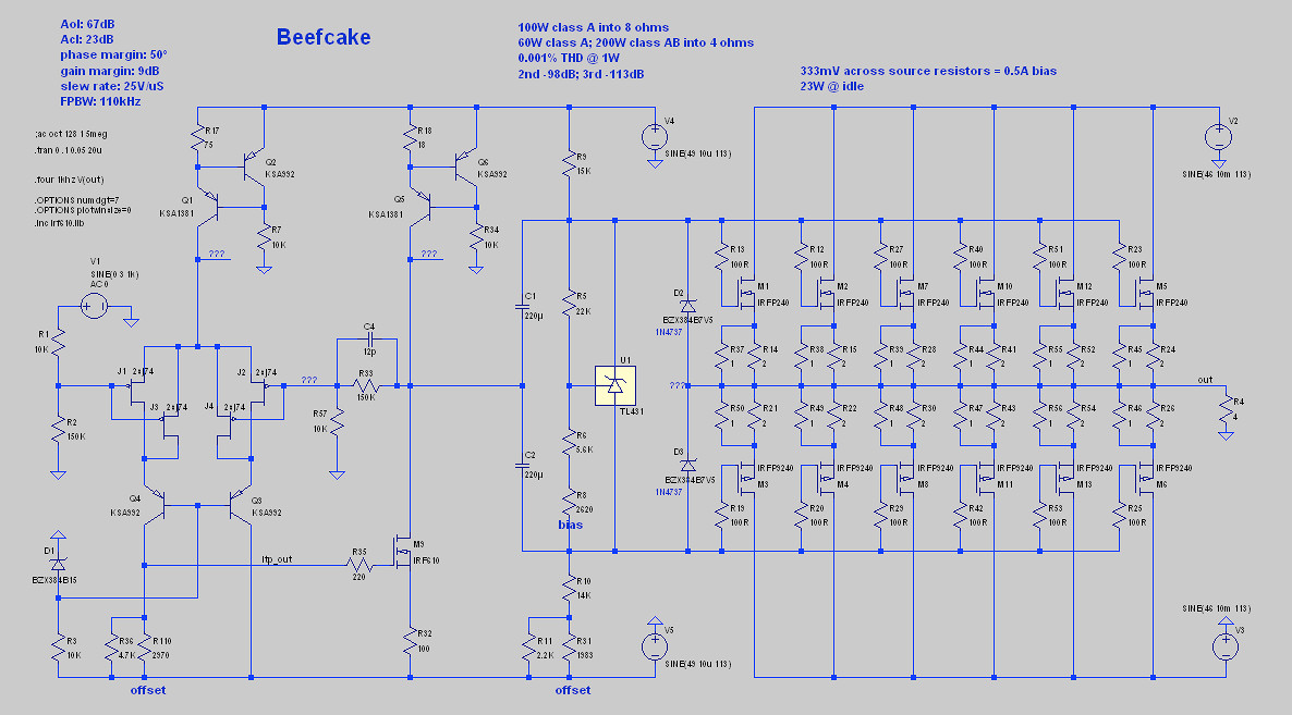

@Hikari1, will do. It was built to feed a pair of these:
attachment.php
But as I don't have the Beefcakes built yet I might compare it to the pre-amp section of my Rogue Cronus Magnum....
Jeff.

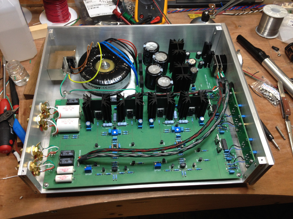

So here's my clone of the HPA-1.
BIG CAVEAT: This is based on Jam's descriptions earlier in the thread, hints from others, and some long hours studying not-quite-good-enough photos to discern connections and resistor values. Also, I'm an amateur in the analog domain, so while I now comprehend most of this circuit at a basic level, I certainly don't understand it well enough to know whether or not I got things wrong.
I'll post the Kicad files and/or Gerbers once I find out if it works or not.
Oh, and if you see issues with the design, please tell me! While I've already started building, I've got enough hours in the casework that I can do another board if necessary. 😉
Jeff.
Were these ever posted Jeff? I thought I had seen them, but can't find them now...
Thanks Jeff. That is a large board 🙂
What specs did you use when you ran yours? Given the size of these, my initial thought had been 2mm board thickness with 2 oz. copper.

Very nice work on this and on your build, BTW.
