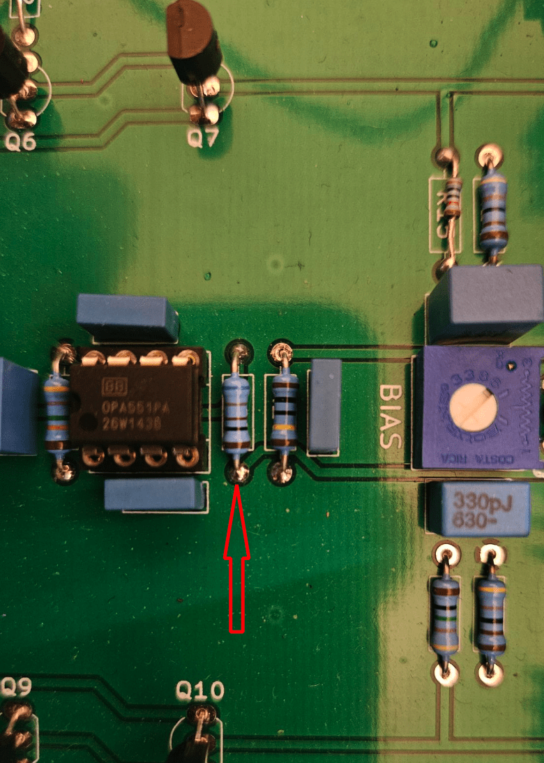

I believe the current mirrors and the feedback resistor control the gain. So double-check the resistor values R13 and R14, and R27.
Will do, and I will report back.

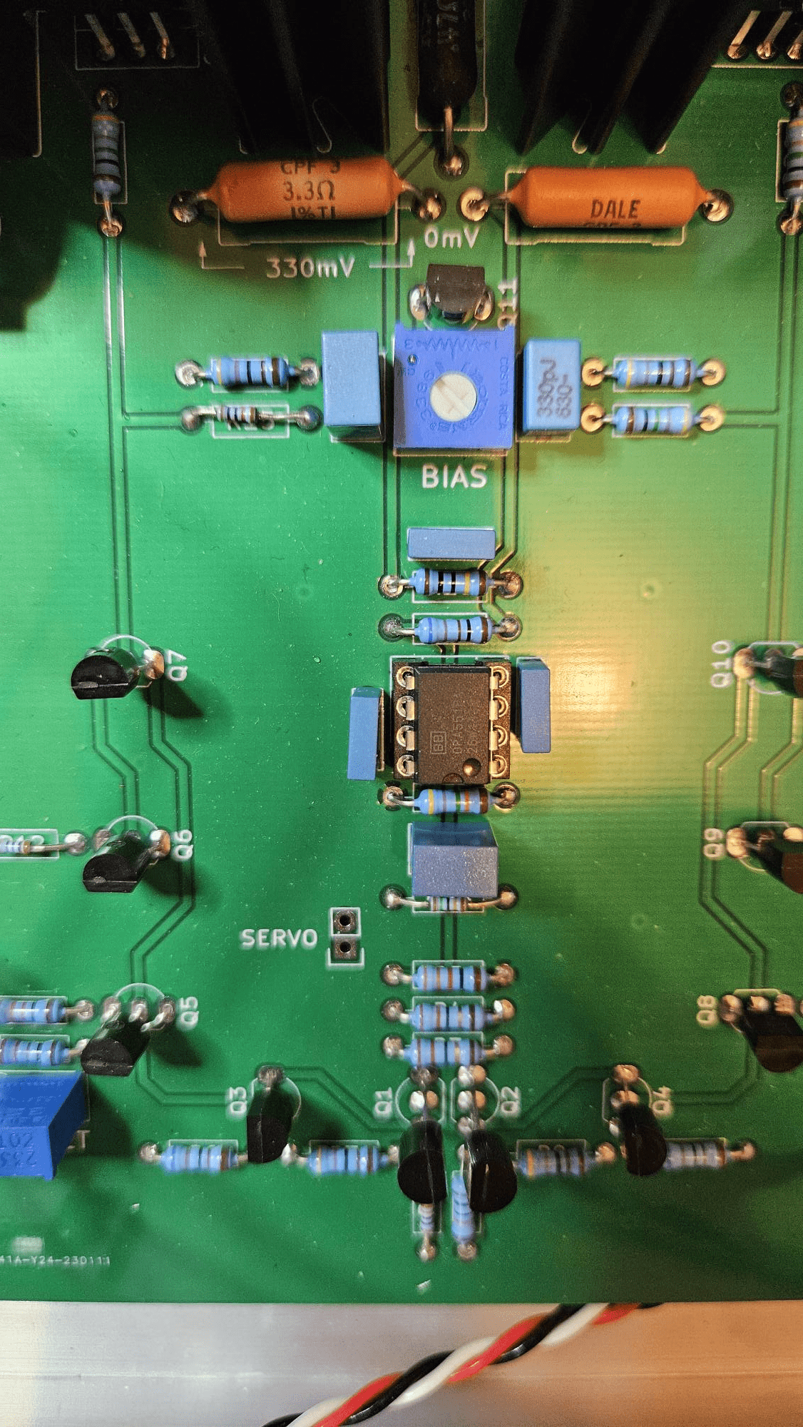

Did you zero the offset with the OPAMP out of the circuit? (There's a jumper for that in the later schematic; in the earlier one you have to remove the OPAMP from its socket.). If the circuit is out-of-balance and the OPAMP is working hard to bring the offset back down, that might affect the gain? (I'm not sure here.)
I did not try that, yet.

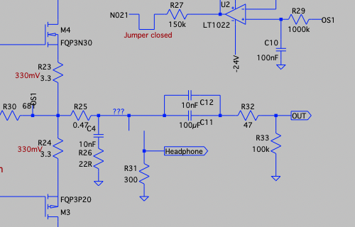

Did you make for a try a direct connection after the 0R47 at the output to your headphone, hoping that no relay grounds your output?
With 223R you get 0.8V out when you put 0.5V in, according to Spice simulation.
Maybe your low value is due to the parallel servo? Disable the servo jumper and look if you get 680R for R27 then.
my 680R measures also as 223R, so this cannot be the reason, no matter if the jumper is closed or open.
