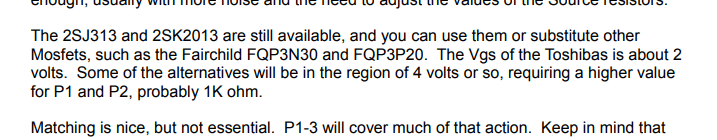

Not sure how important this is, but I noticed that the measured Vgs(th)-voltage for my FQ's is higher than for e.g. IRF610s and therefore much higher than for the 2SK/2SJs. Based on what I have previously seen for e.g. the BA3FE-design, this might be worth looking into in case it requires other parts being adjusted if you don't use the FQs.
Gate turn on is 4V for FQP and 2V for 2SK/2SJ - this is mentioned in Pa's BA-3 document
IRF part is 2-4V so is closer to FQP than 2SK/2SJ

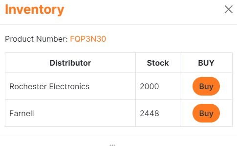

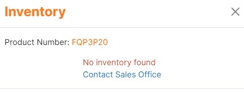

Who can help ?
I need 2 pieces of Mosfets FQP3P20 and FQP3N30, which I can't get in Spain.
Thanks Michael.
Thanks Michael.

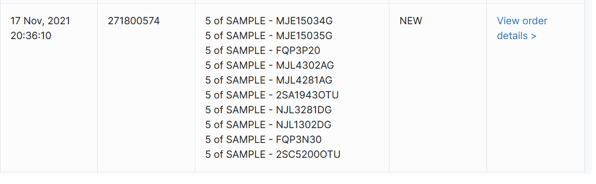

@michaelbehrendt I can actually help you with that. I am going to put in an order myself for the FQP parts as well as the KSA992/KSC1845 - PM me and I will provide you with some information 🙂
https://www.onsemi.com/products/discrete-power-modules/mosfets/FQP3P20Who can help ?
Thanks Michael.

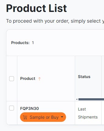

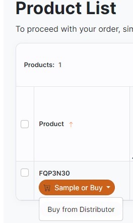

https://www.onsemi.com/products/discrete-power-modules/mosfets/FQP3N30
Buy as samples from ONSEMI.
