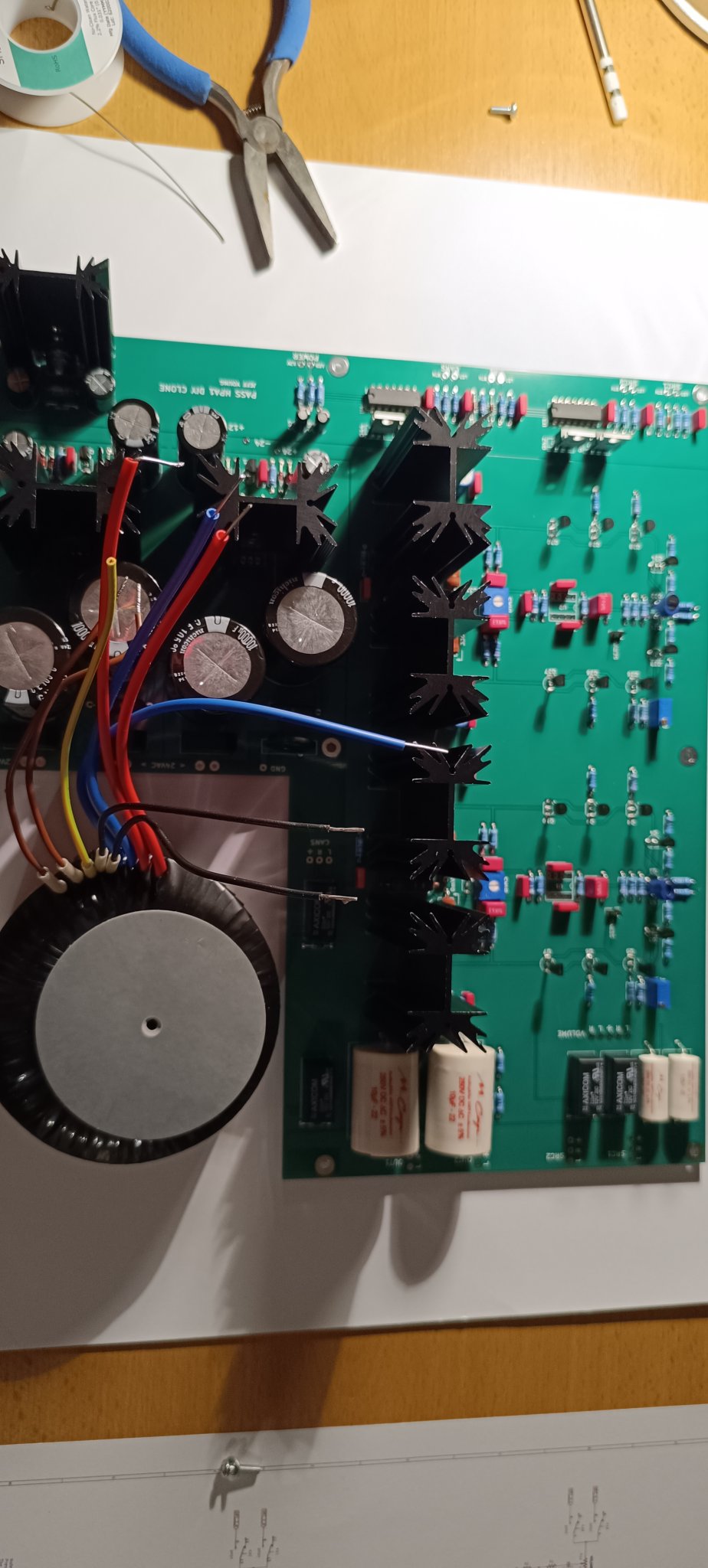

I'm also almost done, ...tomorrow I'll install the power transistors and I'll bother with soldering the Opa604 to the soic/dip adapter. I wanted to avoid the fake opa604 on eBay in dip8 version, as they are no longer produced and I bought the soic8 version.
Friends, I managed to successfully run and set up the HPA1 and without DC servo ofsett on an output up to 1mv.
IIRC the opamp is just a DC-servo, so you should be able to replace it with another high-voltage tolerant opamp like the OPA445 or the OPA551 which might be easier to find in the DIP package.

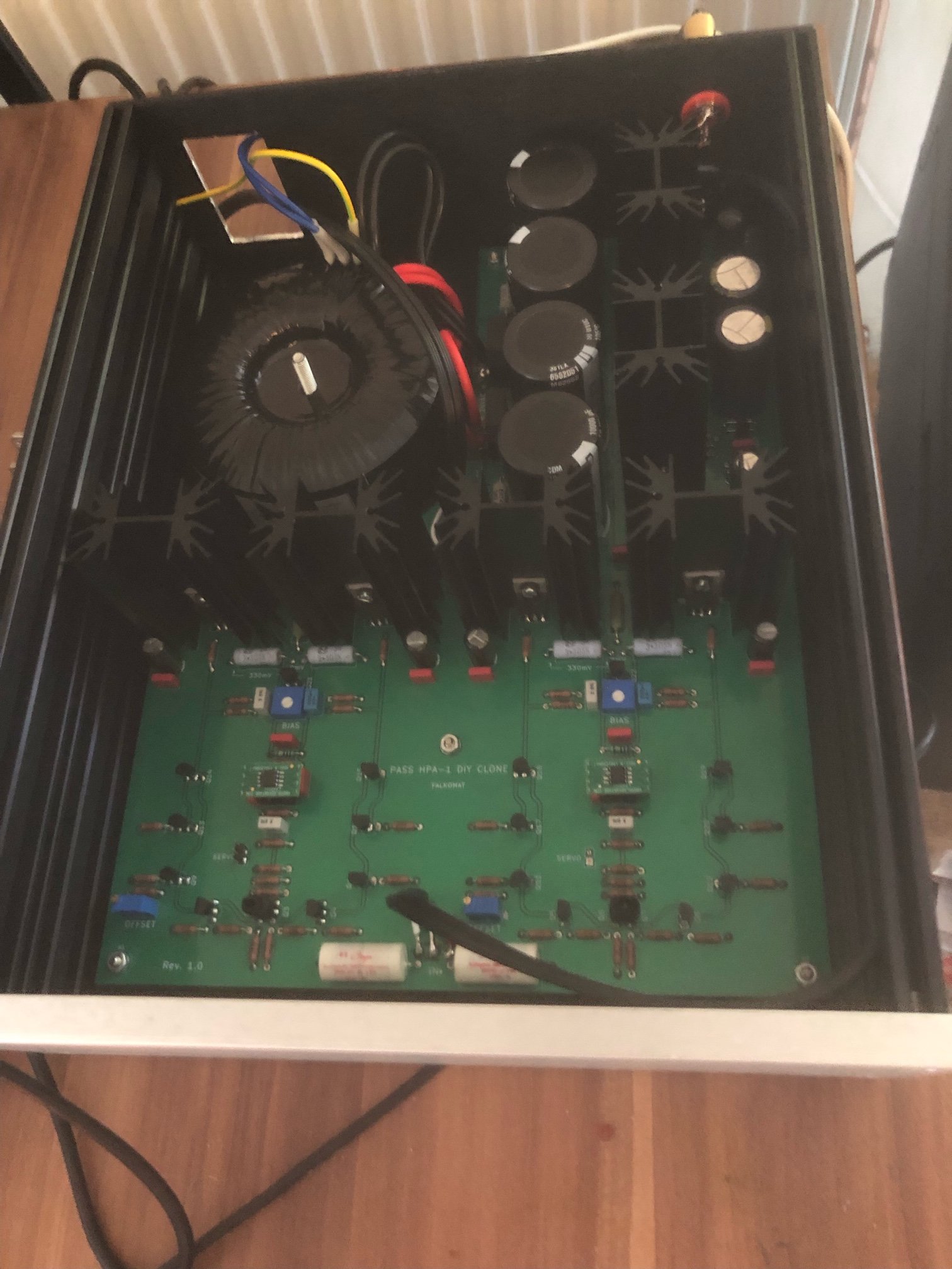

Hey guys,
I also finished my amp 🙂
But I have a short question to you. I use a transformer with 2* 25V and instead of
2SD2081/2SB1259 I use 2SD2014/2SB1257. There seems to be too much voltage drop on the darlingtons - I only get +/- 22,7V on the rails.
Bias is at 100mA
Is a mod needed using the 2SD2014/2SB1257?
Thanks in advance!
P.S. It sounds very nice so far!

Hi HRDSTL,
can I ask you a question?
Which Darlingtons did you use in the power supply regulation - 2SD2081/2SB1259 or 2SD2014/2SB1257 and which voltage do you have on the +/- rails?
Edit: I can see on you video that it is around 23,5V!

2SD2014/2SB1257 (23,5V)Hi HRDSTL,

Thanks all,
I thinkI used the wrong zener diode...I used 1N5252B.
Which zener did you use? BTX85...?
BZX55B24 but I think, the specific type should not be that important ?
They are rated from 22.8 to 25.2V.
Maybe that explains the discrepancy.
Hello,
A quick update on my progress:
As for the operation, the OFFSET is less than 1mV, and the BIAS is at 330mV. The amplifier sounds wonderful.
Have a great day!
Jérôme
- Due to a small issue with the toroidy, I changed the voltage to a 2x26V transformer.
- There is a 0.5V offset on the -24V rail, which is strange because there is only a 0.1V offset on the zener. I replaced the zener on the -24V rail, and now it's perfect with only 0.08V offset.
- However, I'm only getting 23.4V on the rail with 35V at the input of the 2SD2014/2SB1257 transistors. Can someone who has 24V on their rails let me know the measurement at this point?
Have a great day!
Jérôme
