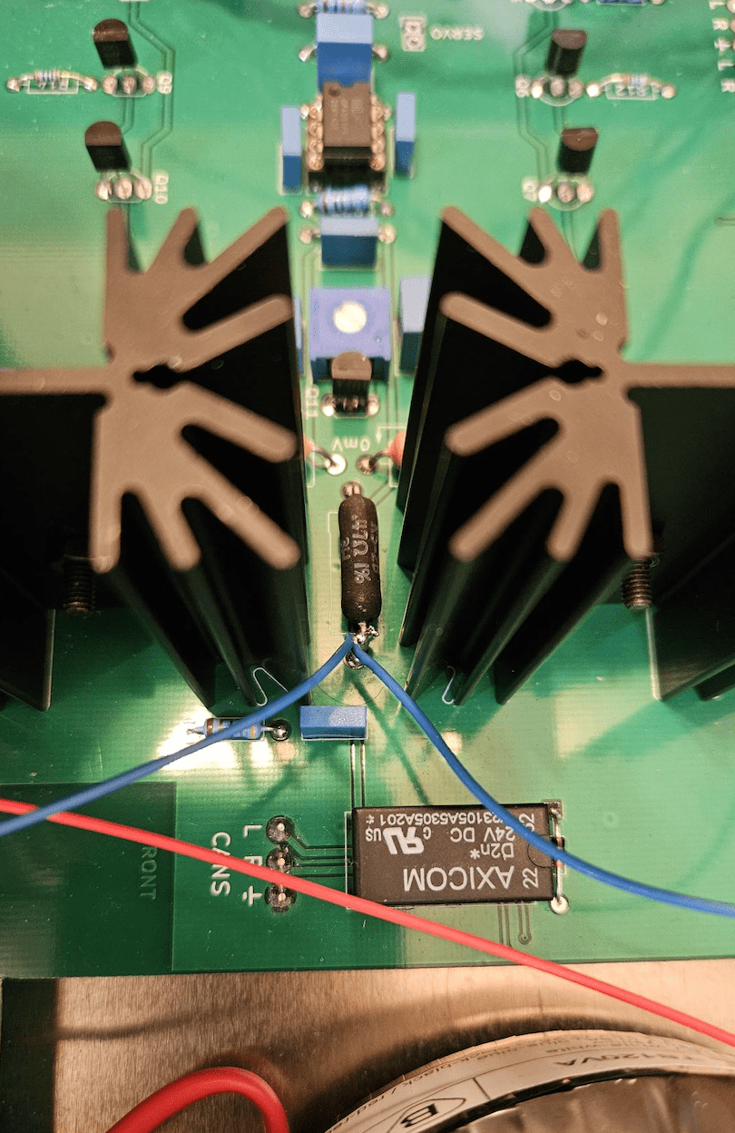

When you lift the right leg of the 0R47 you avoid the relays....and could measure if there is enough juice,
but the 10nF and 47R are no more connected ......
That's a relief!my 680R measures also as 223R, so this cannot be the reason, no matter if the jumper is closed or open.
Any other way to measure that, without a sound card and REW?You cannot give in with a sound card and the REW app a defined voltage in and look what you get out?
My relay is not working, so I bypass it as follows: (the blue wire connects directly to the headphone jack)Meanwhile I would look if not your relays do something funny. If I were you I would isolate the output from the relays and look if I get there a good voltage.
The 2nd blue wire connect to the caps in front of the pre-amp out...
ANY help from anyone is welcome 🙏At any case funny, maybe someone can come in and help too...
VERY likely it is unique to me. I used 24V relays by mistake, and I believe it is the root cause for all the issues I am having 😢I have to ask, I have not built the HPA-1 yet and want to check if the current problem is universal och unique to @Zachik ?
I see, the BOM doesn't state which relays and the rail is 24V. What should be used instead, 25V ?
I see in Jeff's (and others) builds - the relay is 12V part. Not 24V.I see, the BOM doesn't state which relays and the rail is 24V. What should be used instead, 25V ?
Thanks @JeffYoung and @generg for all your suggestions and help!!! 🙏I think @generg may be on to something: cut the 0R47 resistor lead under the blue wires soldered to it and pull it up a little so that end is connected only to the blue wires. (Your relay may be grounding the signal after the fact.)
I will try that and report back... hopefully tonight (depends on work schedule).

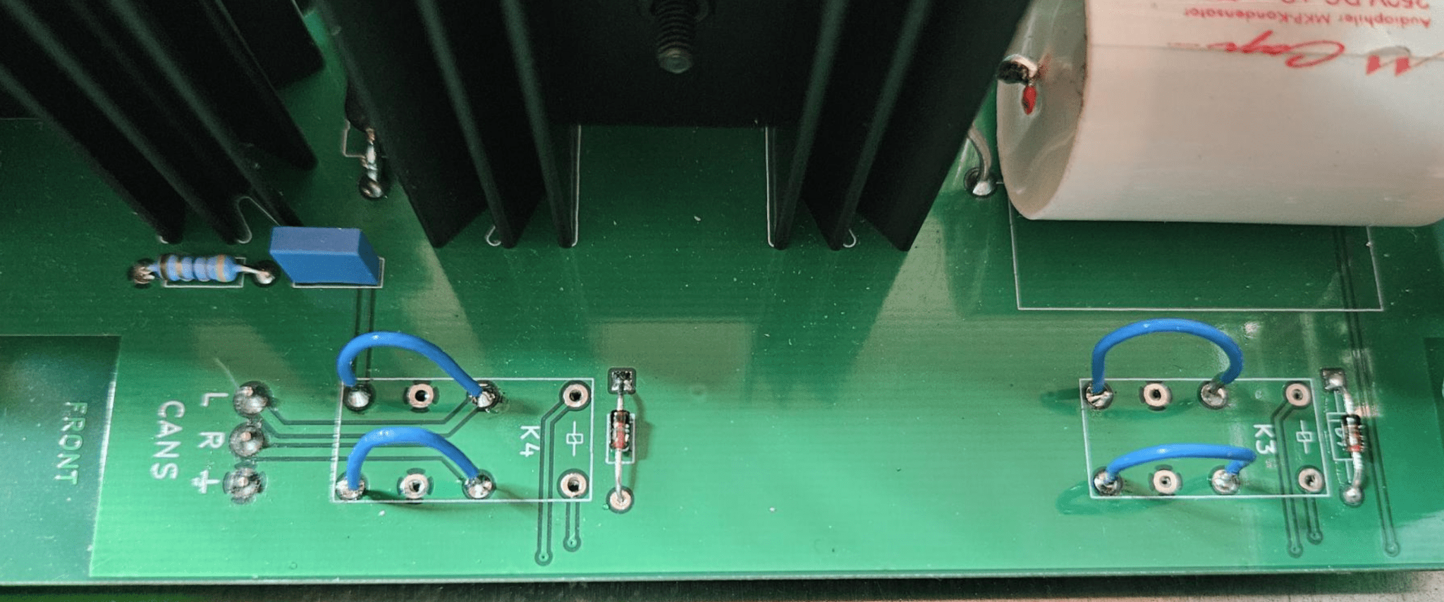

- I managed to remove the relays for headphones and preamp outputs, and added a rework as shown in the photo below.
- As a result - the rework of connecting R23 to headphone jack, is not needed and was removed. No lifting R23 lead, so no compromise to the Zobel network! 🙂
