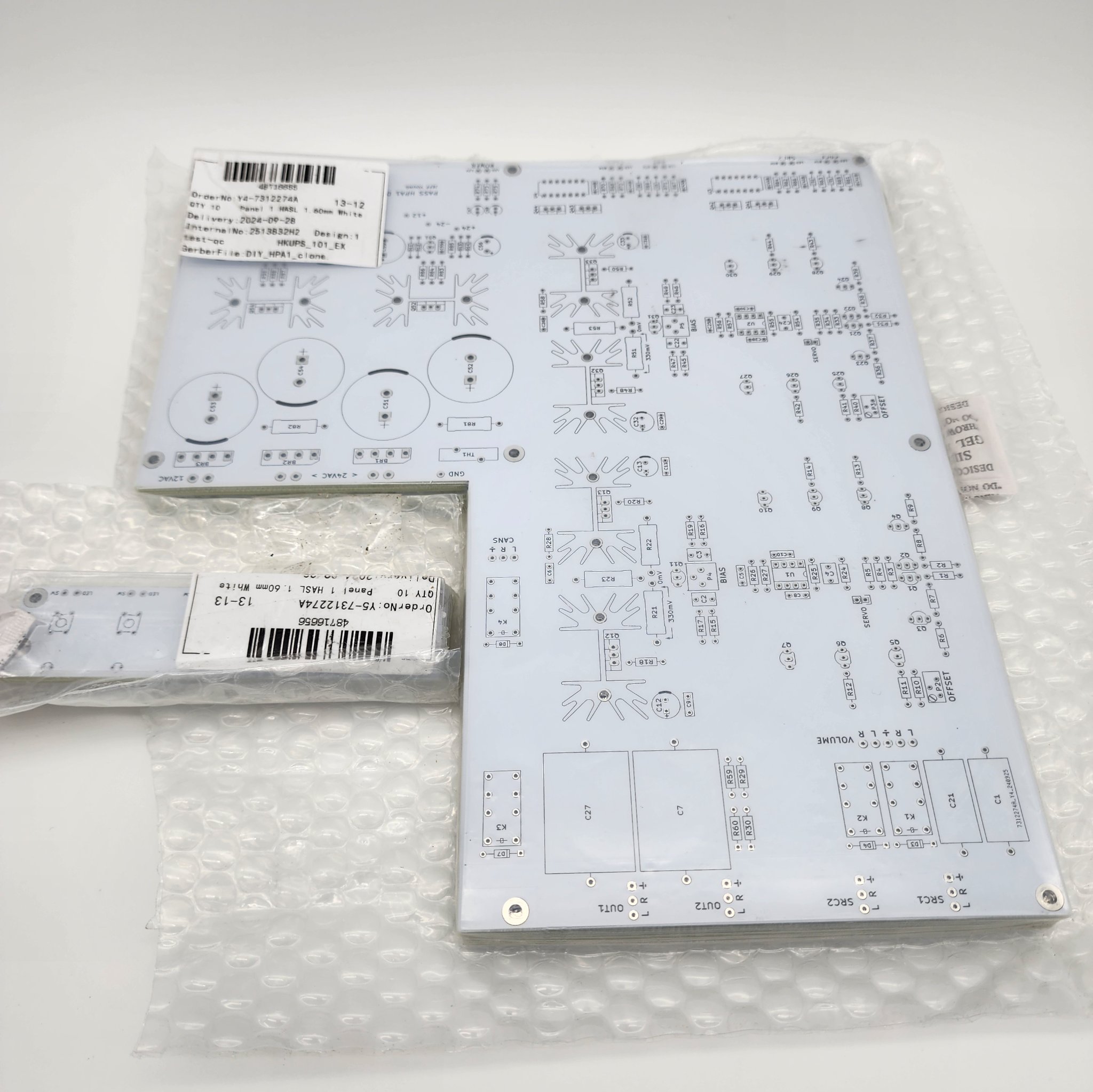

I have an extra 5 quantity HPA-1 boards, with button boards on hand from JLCPCB that I plan to offer up for sale. I also have the now difficult to find FQP3N30/FQP3P20 on hand along with the replacement for the unobtainable darlingtons (TIP122/TIP127) noted above on hand to include to help builders get past the hard to find parts. I will eventually post these up in the Swap Meet for sale, but if anyone wants to reserve one, just PM me. Total cost with the included parts (2qty pairs FQP3N30/FQP3P20 + 1qty pair TIP122/TIP127) should be $25 plus shipping. Due to the size of the boards, shipping within US should be reasonable, but I suspect international shipping will be kinda high.
EDIT - I can also likely provide the heat sinks if that helps, but I'm still working on confirming if I have the correct parts on hand.
