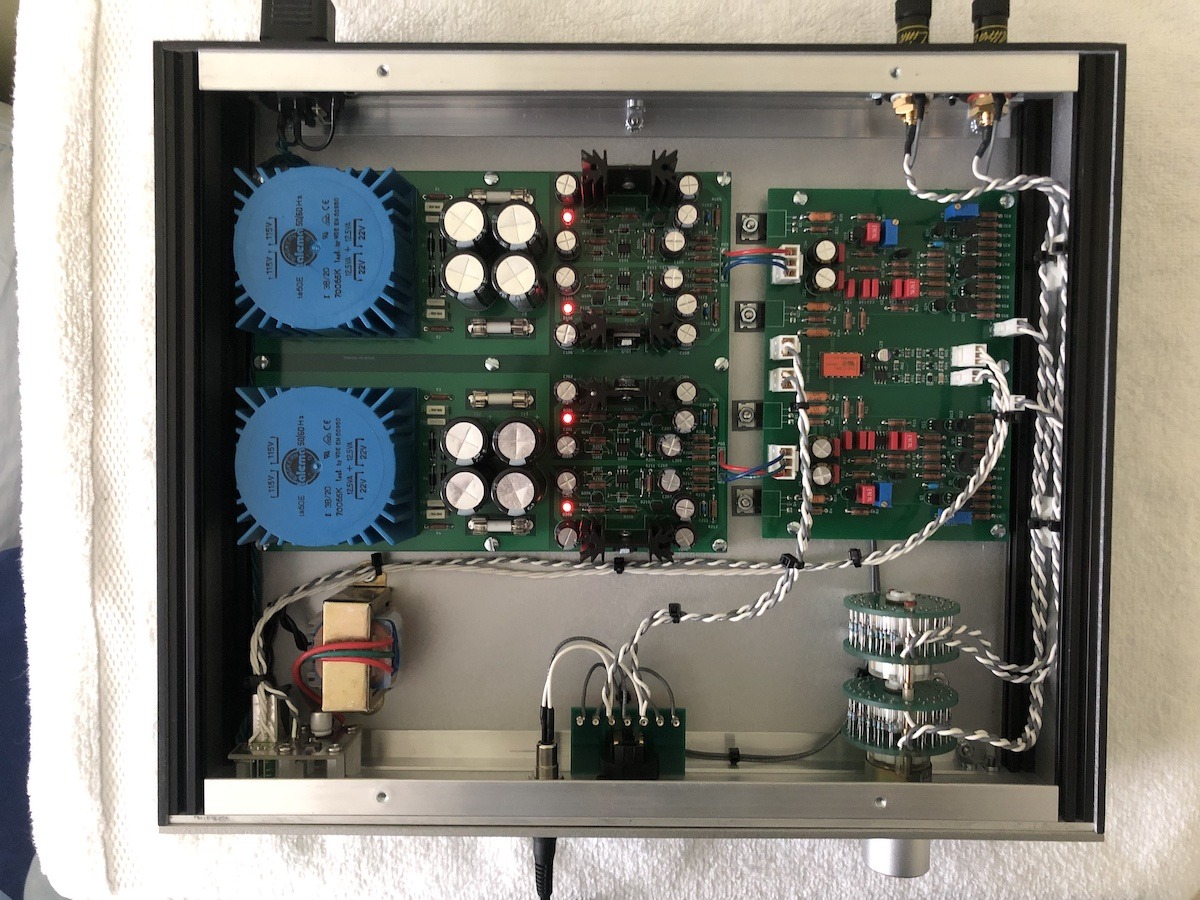

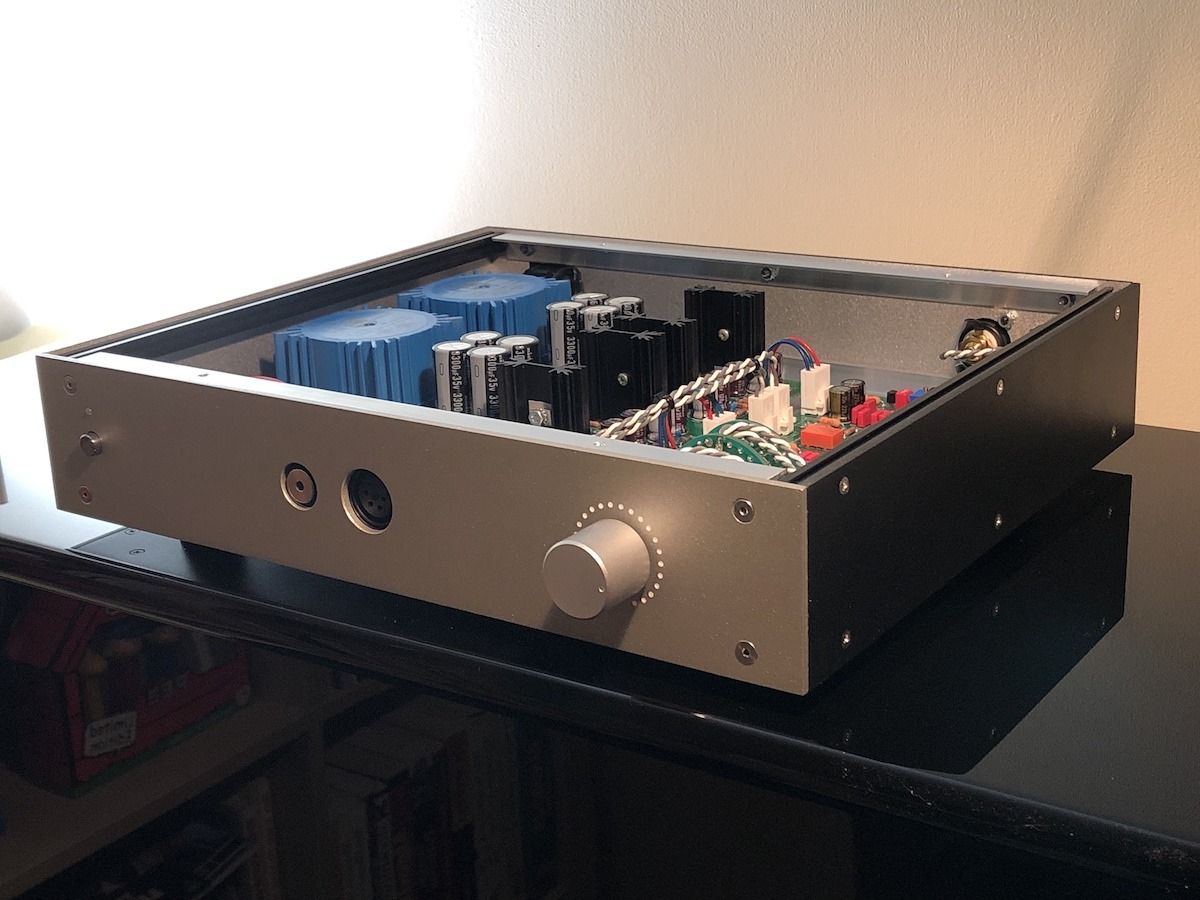

This is an older picture. I ended up with a 20K EIZZ attenuator from China which I rebuilt for 20K Ohms using Vishay RN50 metal films in place of the not-so-great sounding carbon films that came stock. I think it's more appropriate to use the lower-value attenuator given the 100K bias resistor at the input. There are more details of my build on the Headphone Systems subforum.
The amplifier sounds pretty good, but isn't the last word in transparency or neutrality, IMHO. Granted, I didn't use the official power supply and have caught criticism for that. I'm skeptical because the Super Regulator is a fine design and works great in my other projects. I have no idea how this thing compares to other clones, or a real HPA-1. I would say it has a "different" sound which may or may not appeal to you depending on what you're looking for. It's quite listenable and not at all the disaster described on that audio "science" satire forum. Otherwise, I've decided it's best not to try too hard at playing golden-ear games because someone will always take exception, no matter what you say.

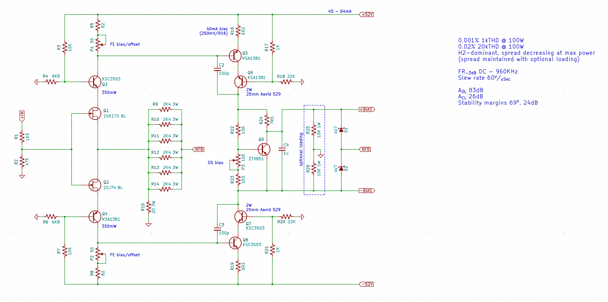

First a big caveat: I'm a complete amateur.For kicks, I removed the 4.7K load resistors from the driver and the 330pF compensation capacitors.
However, when designing Jam Jar I also did some experimenting with artificial loads on the drivers (in SPICE; I haven't built it yet). My conclusion was that the load resistors kept the H2/H3 ratio as the amp approaches full power; without them the H3 increases faster than the H2.
Based on this I designed the CFA front-end for Jam Jar with optional loading so I could experiment. Haven't built it yet though....
Increasing the feedback tightens up the sound and makes the amplifier play more like a typical hi-fi unit. Whether that's a good thing depends on your taste, I guess. My HPA-1 clone didn't blow me away with its brilliance, but you could always blame that on my implementation. I have no agenda or allegiances here. Having listened to the amplifier in its stock form, it was an obvious experiment to try this change. I will probably put the resistors back in, but choose values to give an intermediate level of feedback. With the 4.7K resistors in there as specified, I thought there was a little too much "color" for my liking. FYI, FWIW, and YMMV.
