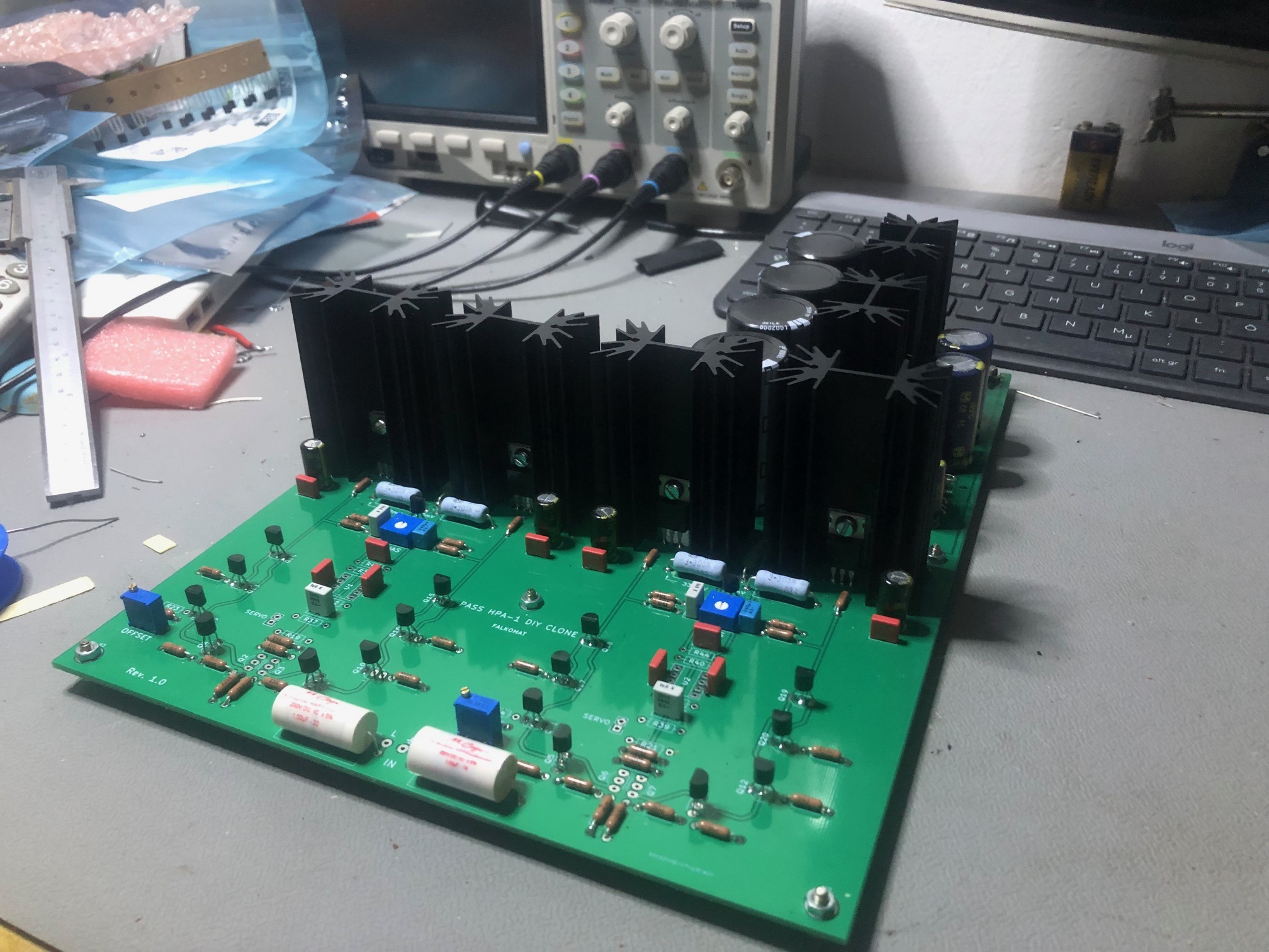

Today most important parts arrived, pcb are also on their way, ...
I didn't find anywhere even in the BOM what type of heatsinks to order (Jeff pcb) 🙁

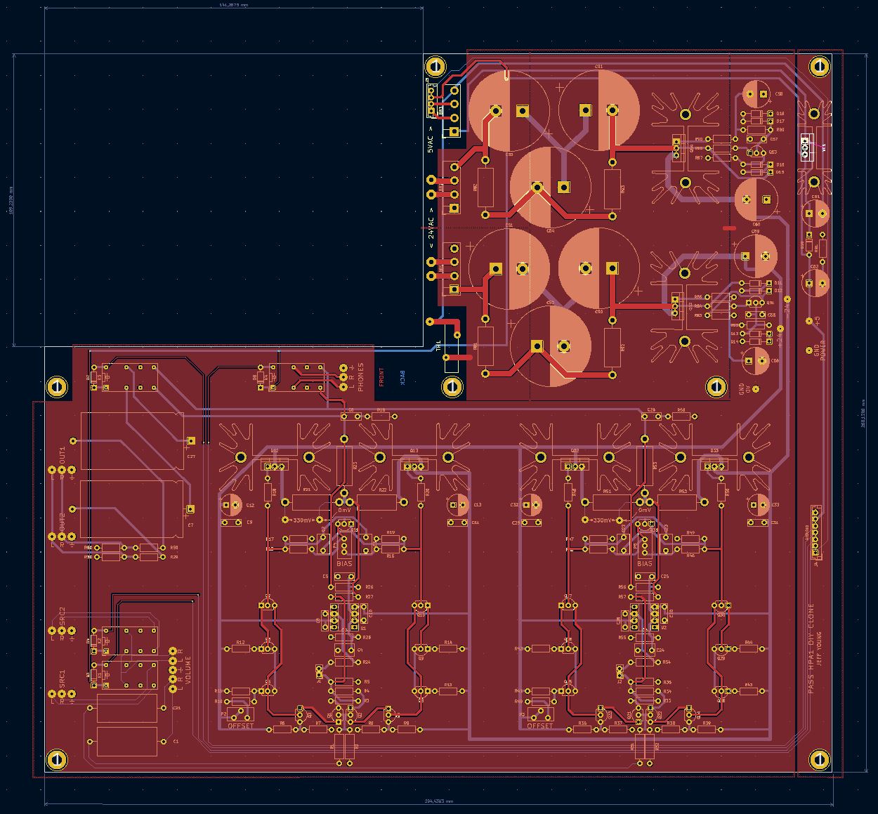

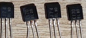

Hello everyone,
After building the WHAMMY, "NOIR," and an F6, I would like to create the HPA-1 Jeff version.
It will be equipped with 2SK170/2SJ74 for the JFETs, KSA992/KSC1845 for the BJTs, and FQP3N30/FQP3P20 for the MOSFET

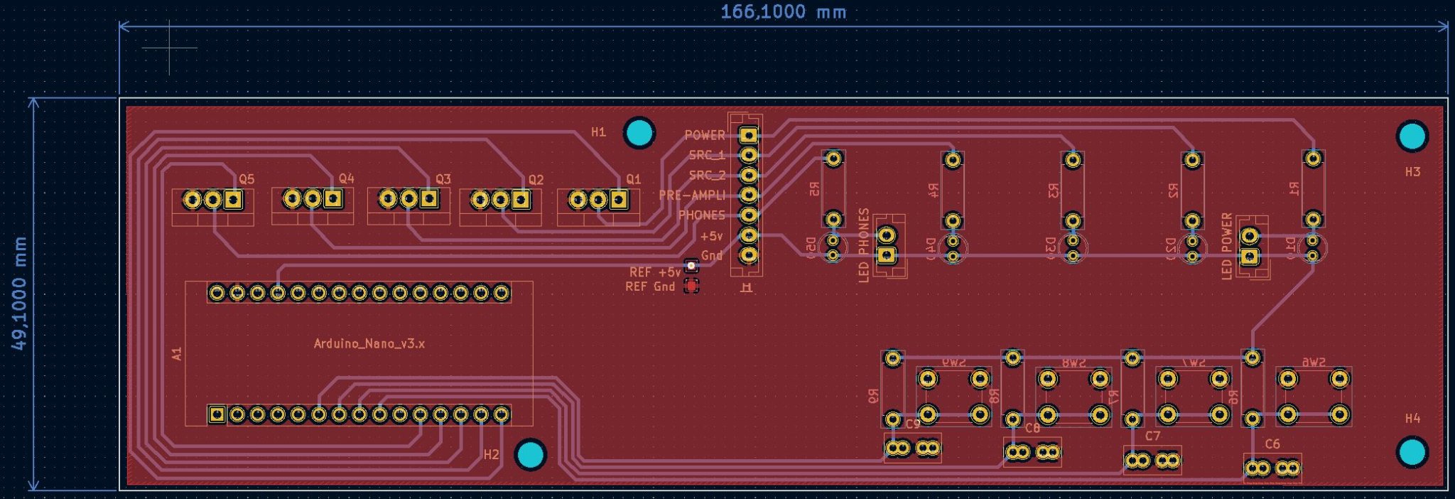

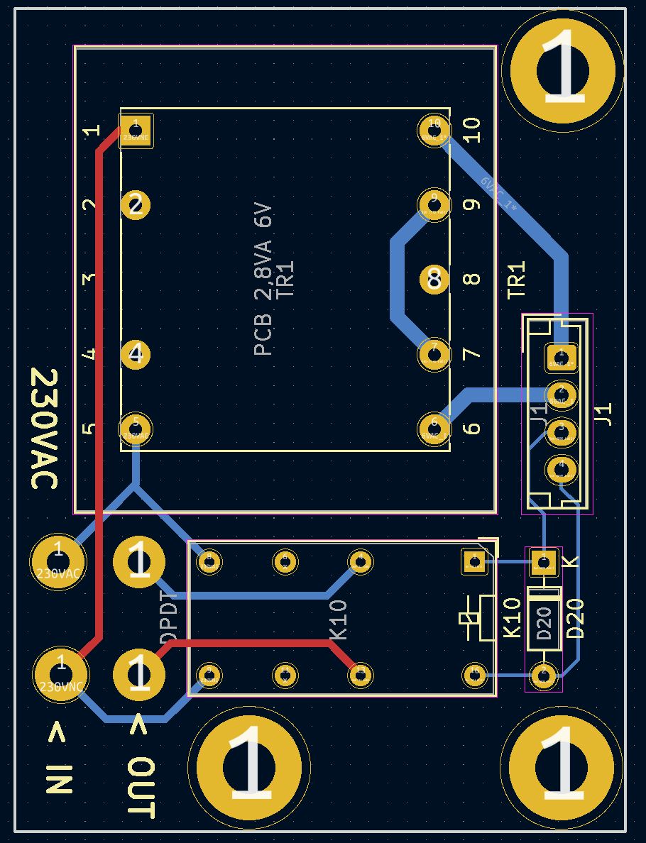

I have taken the latest schematic (as far as I know), kept the main architecture, and made changes only to the power supply by switching to a CRCRC configuration. The 5V will be separated, and the relay control (power/inputs/outputs) will be managed by an ARDUINO.
I have revised the PCB layout and added a few test points. Do you have any comments or improvements to suggest?

You might want more clearance on the 230V lines. While IPC2221 says 0.4mm is enough with a conformal coating, there's no solder mask on the IN/OUT pads, so I'd want more around those. I usually just use 2mm since my designs aren't that dense and I can afford the space.
You may need a bit bigger transformer with the CRCRC PSU, depending on what values you're using for C and R.
Thank you for the feedback, Jeff.
I will correct the traces and the IN/OUT pads.
Regarding the filter, I will keep the 40,000uF by using 3x6800uF capacitors. I don't want to affect the bass frequencies. As for the resistors, I will calculate them using the formula 1/CW with a cutoff at 50Hz, which gives me a value of 0.47 ohms.
Unless I'm mistaken, currently with 2.2 ohms, the cutoff frequency is around 7Hz. Is it necessary to go that low?
The transformer will be a Toroidy 120VA 2x24V.
Have a nice day, Jérôme

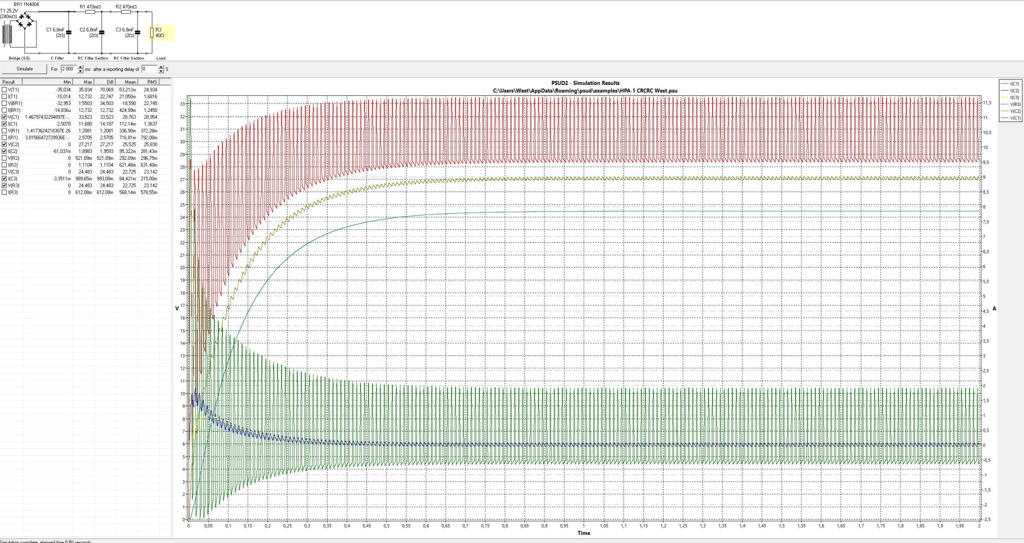

I wasn't familiar with PSUD2, but it's really useful.
I simulated my power supply with a 40 ohms load for a current of 600mA.
I obtained a current of 2A in the first capacitor section, and my UKTs can handle up to 2.5A.
My output voltage is 24.5V, A bit tight?
