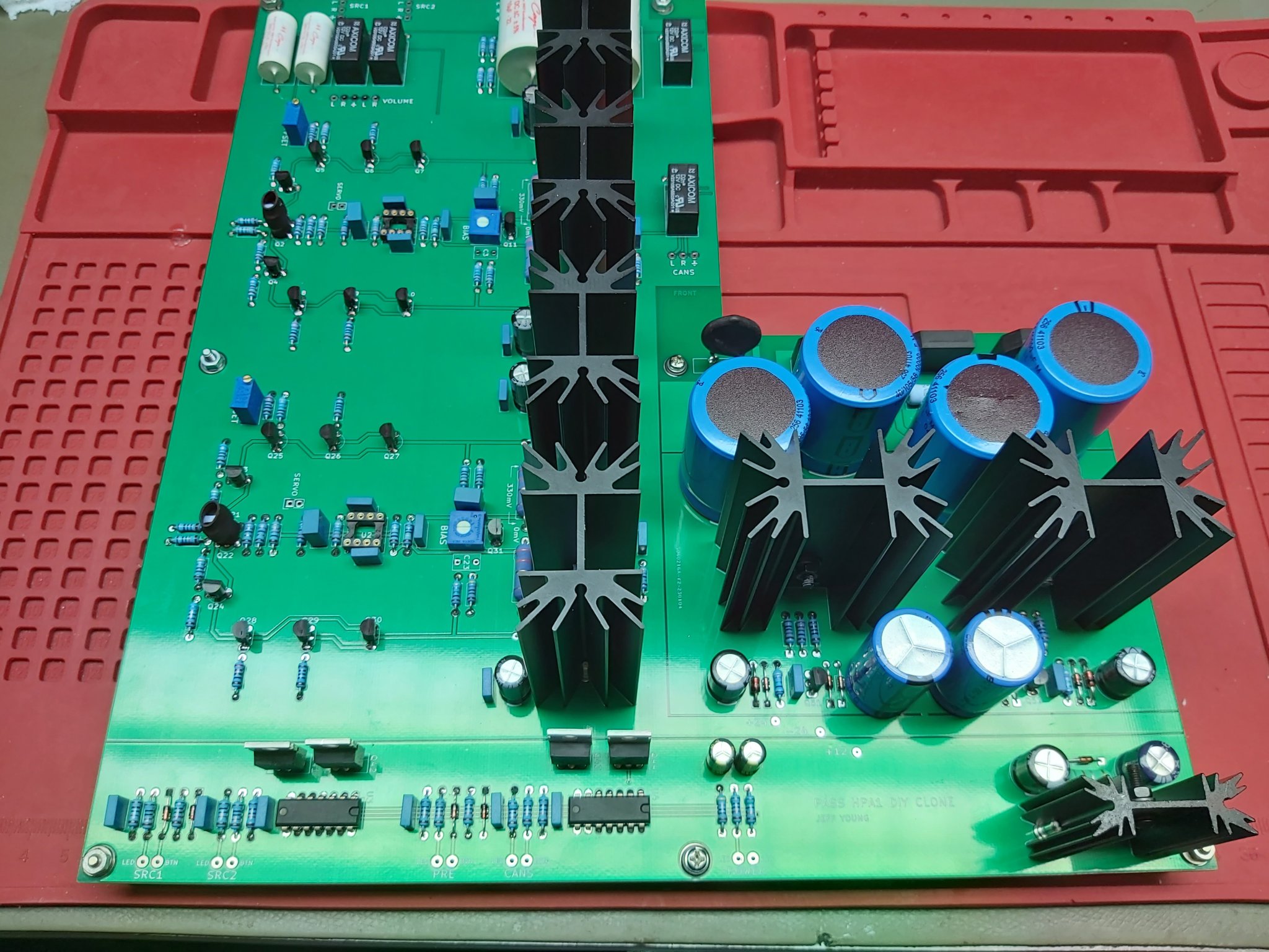

Regarding transistors and heatsinks, It depends if the transistor has exposed metal and if the heatsinks are connected to anything else such as ground that would cause a short circuit. Safe thing to do is to use insulators and heat sink compound to mount the power transistors.

IIRC the Sanken darlingtons in the PSU are fully encapsulated and so don't need isolation from the heatsinks.
The Fairchild outputs are not and so I would isolate them. (I used mica because I'm old-school.)

I been having this dummy question is it normal to use those thermal paste/grease with insulation pad?IIRC the Sanken darlingtons in the PSU are fully encapsulated and so don't need isolation from the heatsinks.
It depends on the type of pad. Definitely with mica. Not necessary with Keratherm. Others will vary.

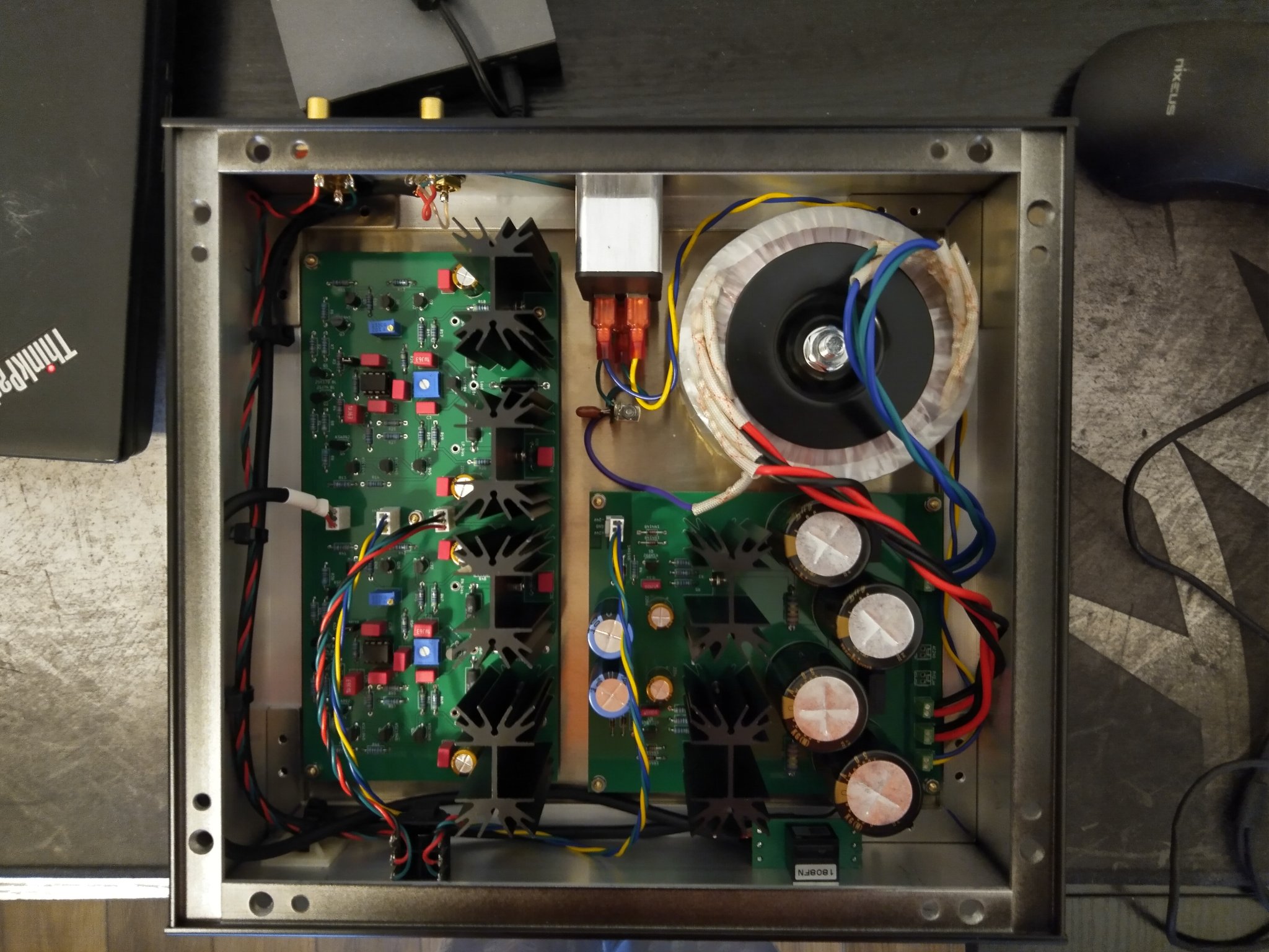

I'm at adjustment stage now, and wonder what level of DC at output should I expect to measure with and without the servo connected?
So far by adjusting the offset without servo in place I get DC down to about a few mV ~ 0.X mV (fluctuates a little over time), connecting the servo jumpers I measure again and the number doesn't seem to change - Does that mean the servo is not working for me?

I did remove all the user control stuff, relays and input/output coupling caps, at my own risk...
After trimming the balancing pot without servo connected the measured DC is still pretty low, a few mV at max, tho I don't know how things are like right when power is turned on. Probably a good reminder that I should have the headphone disconnected when flipping the switch
