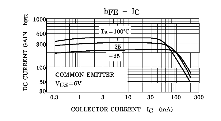

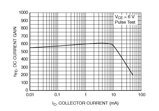

Instead I would like to understand more (for learning purposes). I have seen the high(er) voltage KSC1845 and KSA992 used in a number of designs and I wonder why I keep seeing them in +/-12V to +/-24V designs. I first encountered the 2SC2240/2SA970 in higher voltage power amplifiers where types like the 2SC1815/2SA1015 did not have high enough breakdown voltages/SOA.
Which one you rather have ?
Patrick

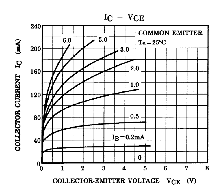

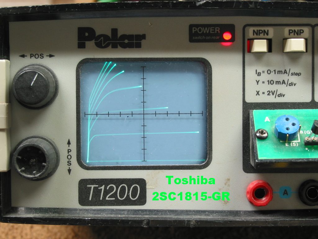

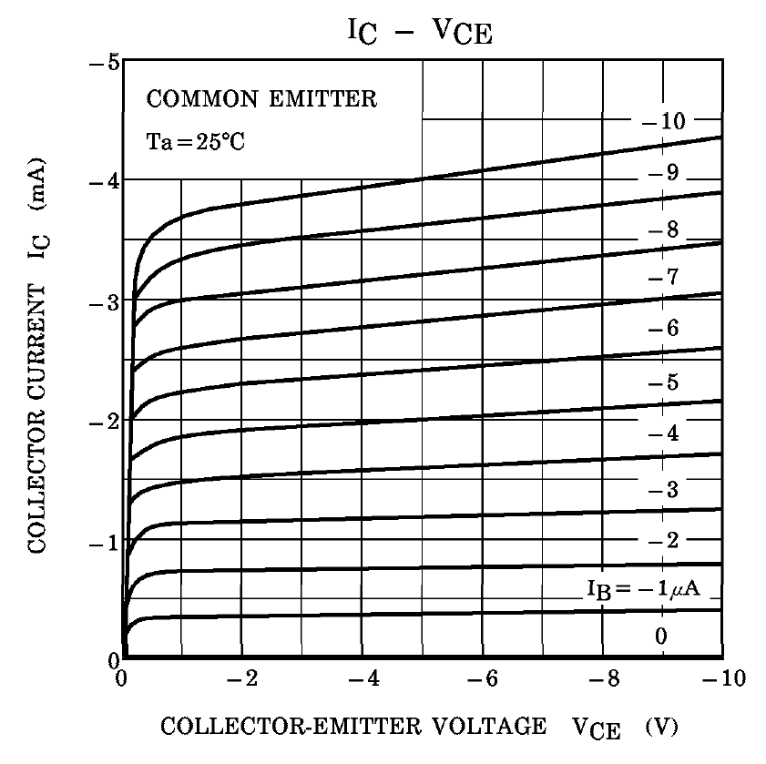

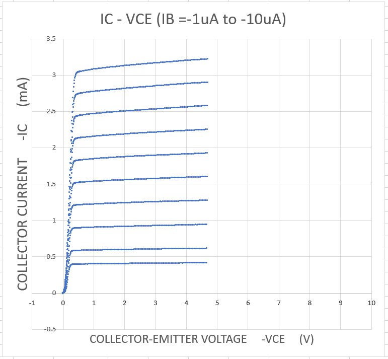

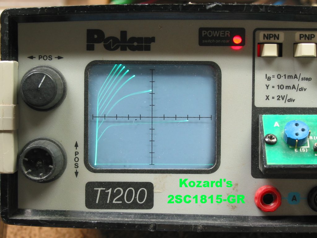

I don't know if this sounds ridiculous. However when I have looked at some transistors on a curve tracer and compared with the datasheet I get the feeling that the datasheet curves were almost hand drawn. Sometimes they look a little unrealistic or too good to be true (or too idealistic) on the datasheet and then the actual sample part on the curve tracer looks much more realistic.
I don't have the greatest examples at hand but I have attached a couple where the curve/curvature of the datasheet graphs looks more like it was hand drawn as opposed to being real measured data from a real transistor. (If you notice: Yes I do realize that one of the graphs shows a software bug for the first trace.)
First two attachments: 2SA970. Second two attachments: 2SC1815.
No, I am not saying that is more important. I was talking about the fact that some datasheets seem to have what look like hand drawn graphs. The examples (not the greatest, just what I had quickly at hand) show that. As a result I am not sure I believe the ruler flat hFE curve either. I have more work to do on my DIY curve tracer to extend the current and voltage range. After that I would indeed like to look at hFE vs Ic.

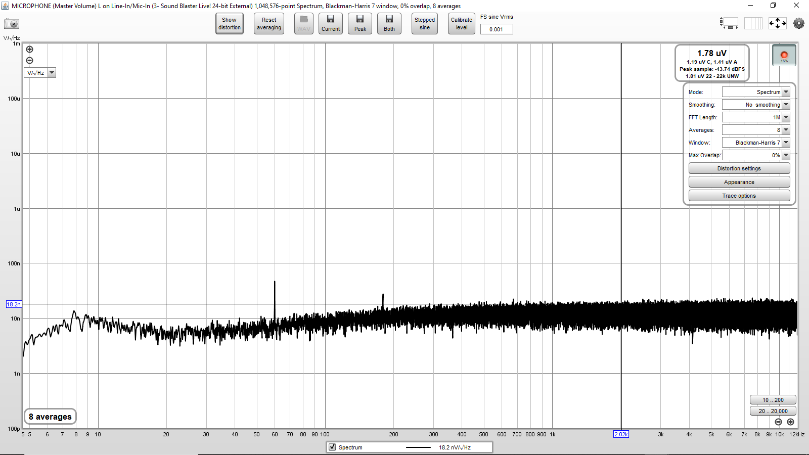

Not sure about the transformer. On my DAC I am using an external transformer from a small mixing console and then two stages of regulation (overkill) including one stage of the LM317/LM337 LF353 servo circuit.

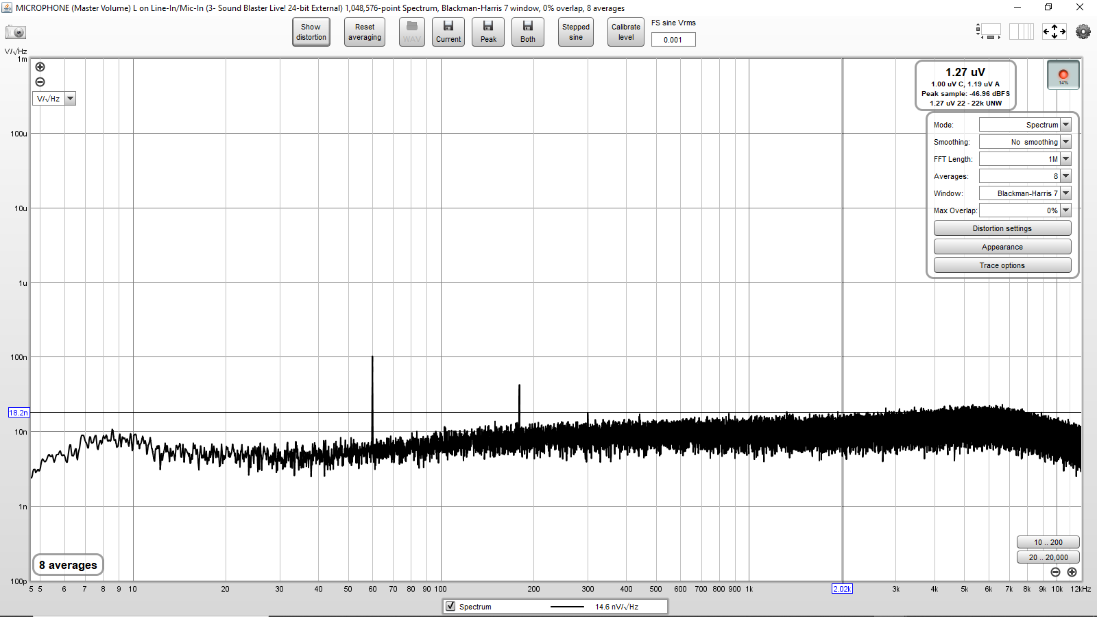

The noise measurements are not bad at all for the LF353 servo circuit. (Attached are measurements from two series LM317/LM337 supplies: Positive and Negative supply. The pre-regulator does not have the LF353, only the second regulator has the LF353. Do those measurements look good enough?)
If I make a PCB for the HPA1 power supply then I can put two regulators in series which would allow me to use one of my spare 150VA toroidal transformers. The voltage is a little high.
  • Neg Plain High Quality Components LM317 and LM337 First Cascaded with LF353 Servo LM317 LM337 Se.png
  • Pos Plain High Quality Components LM317 and LM337 First Cascaded with LF353 Servo LM317 LM337 Se.png
