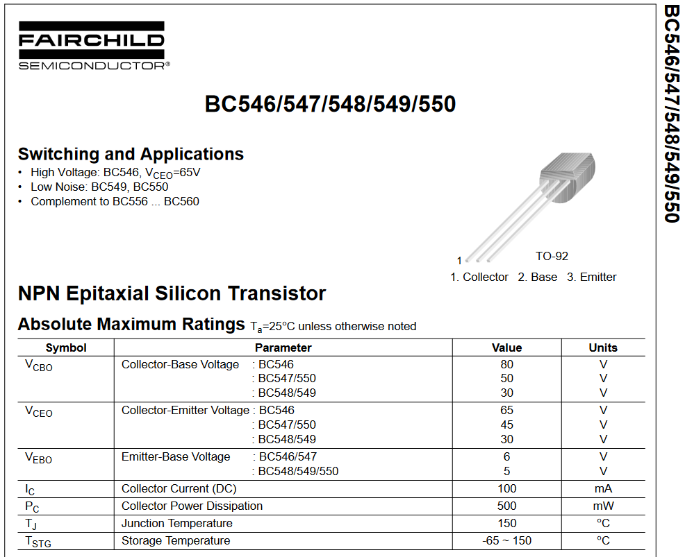

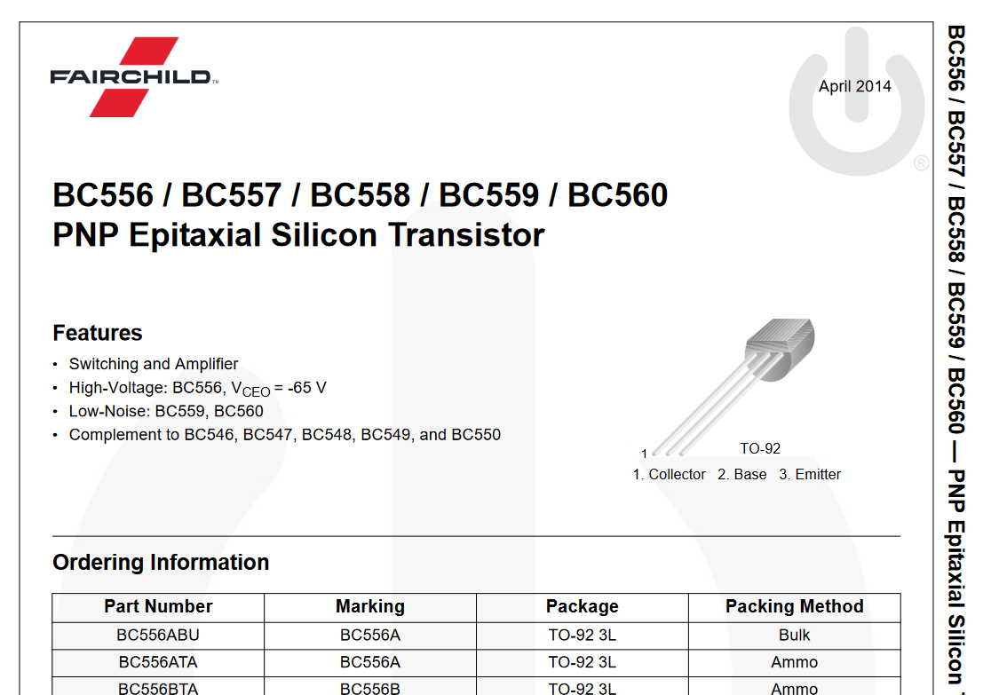

So to be more specific I have attached a screen shot of the first page Datasheet of the family of:
1. Fairchild BC546 547 548 549 550
2. Fairchild BC556 557 558 559 560
Now it is not the exact data that I want but the hFE versus current of the 560 seems to be very non-linear while the 556B & 556C is much better. (I wish I had more/better data to point to but this is what is quickly accessible. I wish the 556B and 556C data continued to higher currents.)

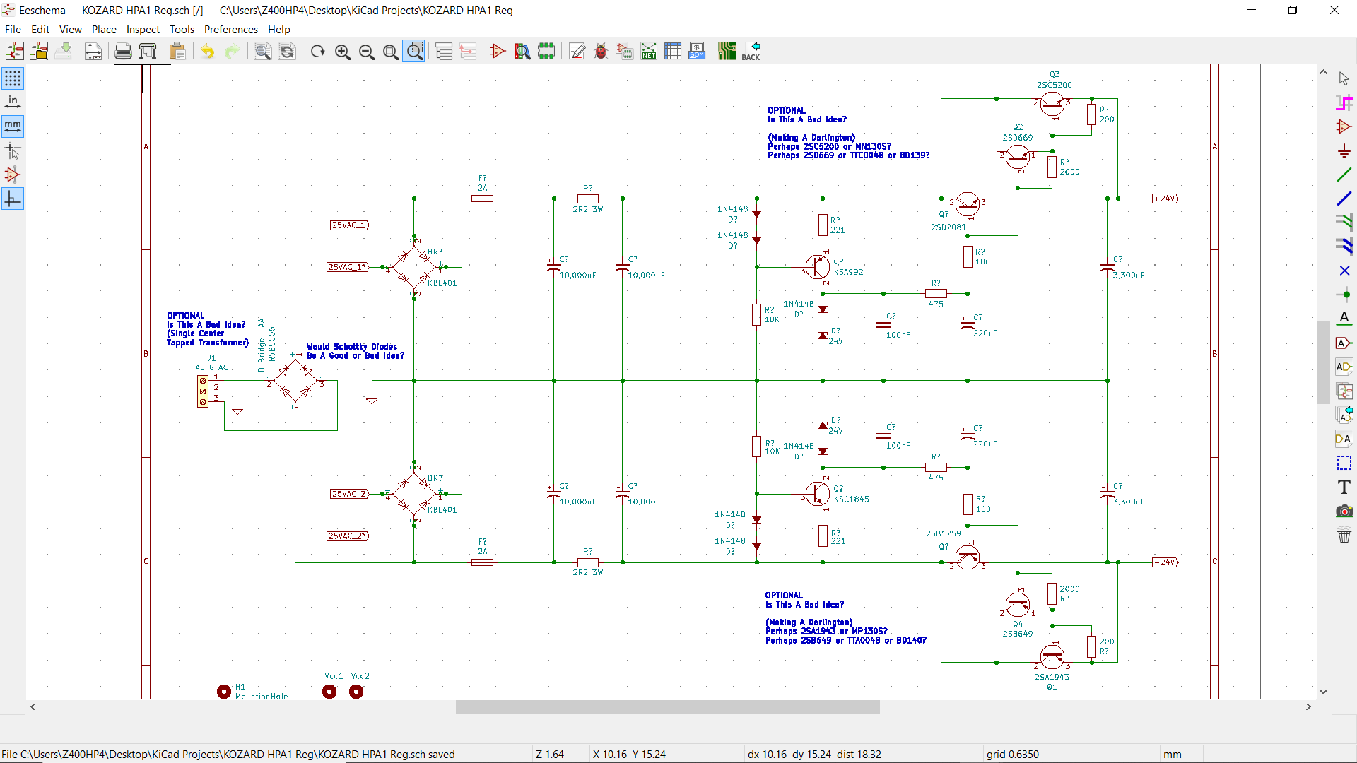

I am starting on the regulator for my HPA1 build. I used the online photos and Jeff's work as a starting point.
Purely due to available parts and necessary economy I was wondering if the following changes would be a bad idea. On one hand I hesitate to ask since I read that the HPA1 supply went through many revisions to get right. However I don't ask due to any desire to redesign. I ask only because I don't presently have dual secondary transformers or those specific Sanken Darlington transistors.
First, is it correct to assume that the Sanken Darlington's are a critical element of the design that should not be changed? If so I will endevour to obtain them. As a temporary measure what do you think of the following temporary substitutes?
1. Genuine disassembled Sanken D2390/B1560 from an old receiver.
2. Make a discrete Darlington using the 200 Ohm and 2k Ohm values from the Sanken 2SD2081 datasheet and Toshiba 2SC5200/2SA1943 or Sanken MN130S/MP130S and 2SD669/2SB649 or Toshiba TTC004B/TTA004B? (Schematic attached.)
Second, the transformer is a bit of an issue since ordering a custom transformer is out of the question. I presently have a 150VA toroid (surplus from an unknown audio manufacturer) and also a rather large 32VAC 370VA disassembled (Onkyo) EI core audio/receiver transformer. (Due to the higher voltage I have used a separate pre-regulator in the past.)
However both transformers are single secondary center tapped transformers.
For the future I could look at ordering something like an Antek dual secondary Toroid.
What sort of performance issues can result from changing the transformer type used?
I have attached my draft schematic from KiCad. I plan on making the regulator on a separate PCB so that I can try it with my other projects such as the op-amp supply for my DAC. Also a separate PCB greatly lowers the cost when I can fit it into the "special offer" size limits of the PCB manufacturers.

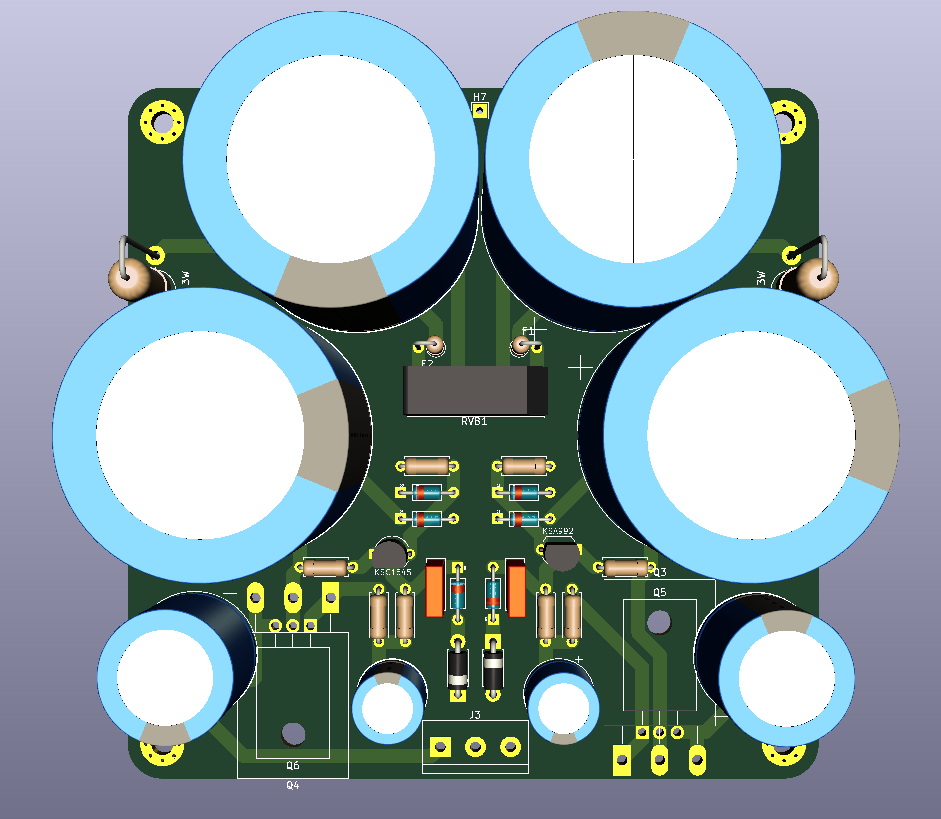

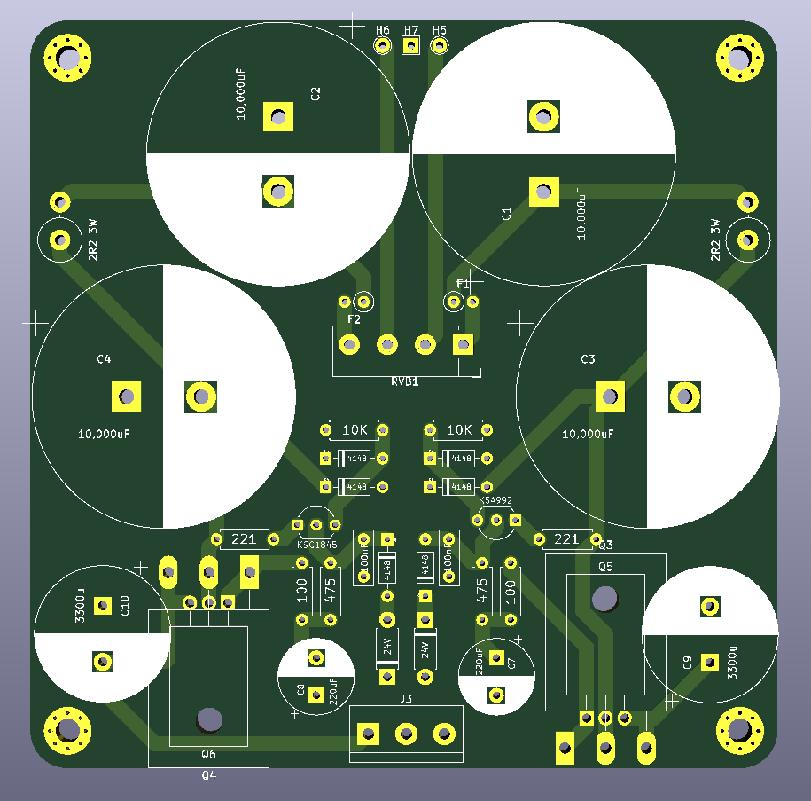

I have started to layout the HPA1 regulator. (My HPA1 amplifier boards have shipped and should arrive in a couple of weeks.)
One of my objectives is to fit it into the 10cm by 10cm $2 JLCPCB special offer so that everyone can enjoy the HPA1 regulator either with the HPA1 clone or with other circuits. (I plan to try it with my DAC to supply the I/V op-amps.)
Fitting it into 10cm by 10cm isn't easy. I kept 35mm snap-in capacitors since that is the most common footprint for 10,000uF 50V. But that is tough to get into 10cm by 10cm.
I intend to use all the same original components. The pass transistors are under the PCB (the aluminum chassis will be the heatsink). I am putting footprints for the original Sanken part numbers which are TO-220. However I am also putting a larger footprint since I will have left over PCB (5 for $2 at JLCPCB) and I may want to use this regulator for other projects in the future.
This is just a first draft/first parts placement. Please let me know how I can improve it and how I can learn more.

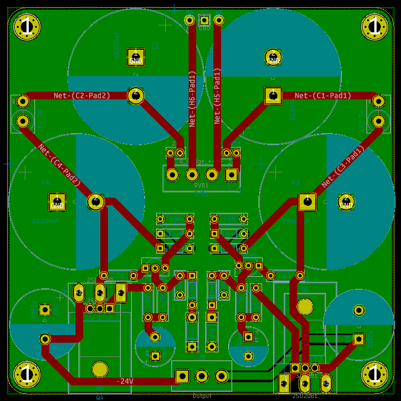

The caps *could* hang off the sides of the board a bit (a few mm?) leaving you with a bit more space.
I try to have all my electrolytics pointing one way on a board. Minimizes build errors.
Of course if you're really careful it doesn't matter -- but past experience has shown that I'm not. 😉

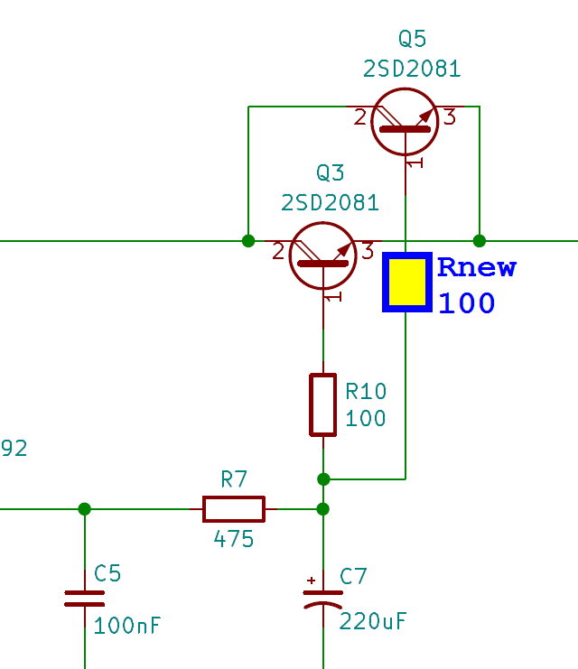

Best practice in discrete component circuit design is to add "ballast" resistors in series with every base, or every emitter, when transistors are connected in parallel. The Google search term is "current hogging" and I am not making this up.
_
_
Thanks Mark.
The two are not intended to be used in parallel. Instead they are "either/or". One is TO-220 case size and the other is TO-3P/TO-247 case size if someone has the larger case Darlington in their parts bin but not the TO-220. I intend to use the original TO-220 size but I will have some extra PCB left over. If I use a left over board for a different project I might only have TO-3P/TO-247 case size Darlington available/left in my stock. Hence the optional larger footprint on the PCB.
I will add notes to the schematic to make that clear.

I would emphasize what Jeff, A Jedi and Mark mentioned above about straightening up the cap orientation and such...
Adding to that, I would further suggest that the pcb copper area between C1 and C2 should be short, and continuous for the higher current charging pulses, (no other tracks between them), and move your KBL401 'block bridge' and the fuses to the outside edge so can add a heatsink if required and/or replace fuses (it's going to get hotter in the middle of the caps) - while doing that, move the 2R2 resistors away from the caps too (capacitors hate getting hot)
Unless your pcb is only ever going to be mounted vertically on the heatsink, the transistors Q3-Q6 options are also going to add heat to the pcb so you mignt consider moving these to the outside edge of the board even at the 'downside' of needing more chassis space.
... my 2 cents
... my 2 cents

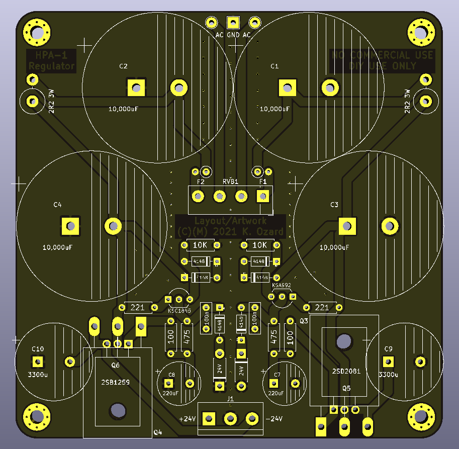

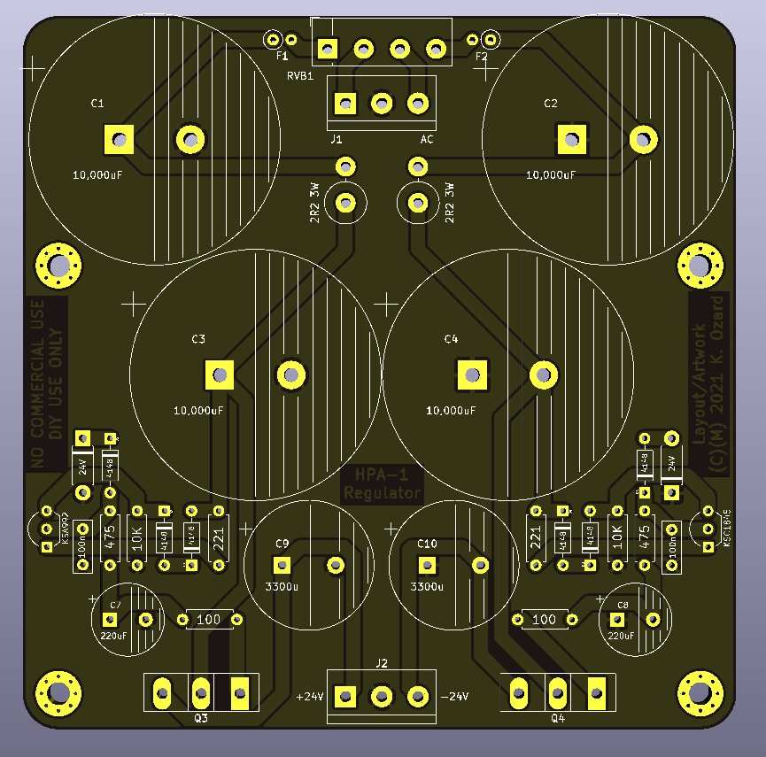

The intention is for me to mount the 10cm x 10cm HPA-1 and the 10cm x 10cm HPA-1 Regulator in a 20.3cm by 14.5cm aluminum chassis where the floor chassis is the heatsink. Thus the space is very tight. The way the chassis is made each half is like a 20.3cm by 21.3cm aluminum heatsink. (The 21.3cm side is U shaped.) I think that is a good size for the required dissipation.
I have attached draft version 0.2 where I have rotated the capacitors and adjusted a few other things. Later today I will see if I can find a way to move the bridge and/or the pass transistors. The fuses are likely to be something like 1A polyfuse. The HPA-1 Class A bias is 2x100mA. With about 10V across the pass transistors that is 2W dissipation for each of the pass transistors. The 2.2Ohm resistor in the CRC filter will see about 0.44V at 0.2A or about 88mW for a 3W resistor. I expect the surface temperature of the resistors will be low. I did move the resistors further away from the capacitors. I expect the surface temperature of the 4A bridge to be low at about 0.2A. However I will look at an alternative layout (if possible) later today to move that.

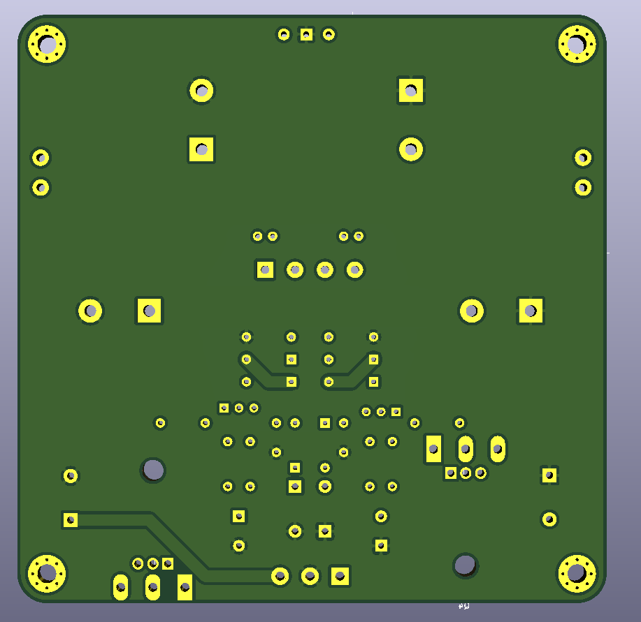

I also added ground pour to the top (it was already on the bottom). Is that a good or bad idea?

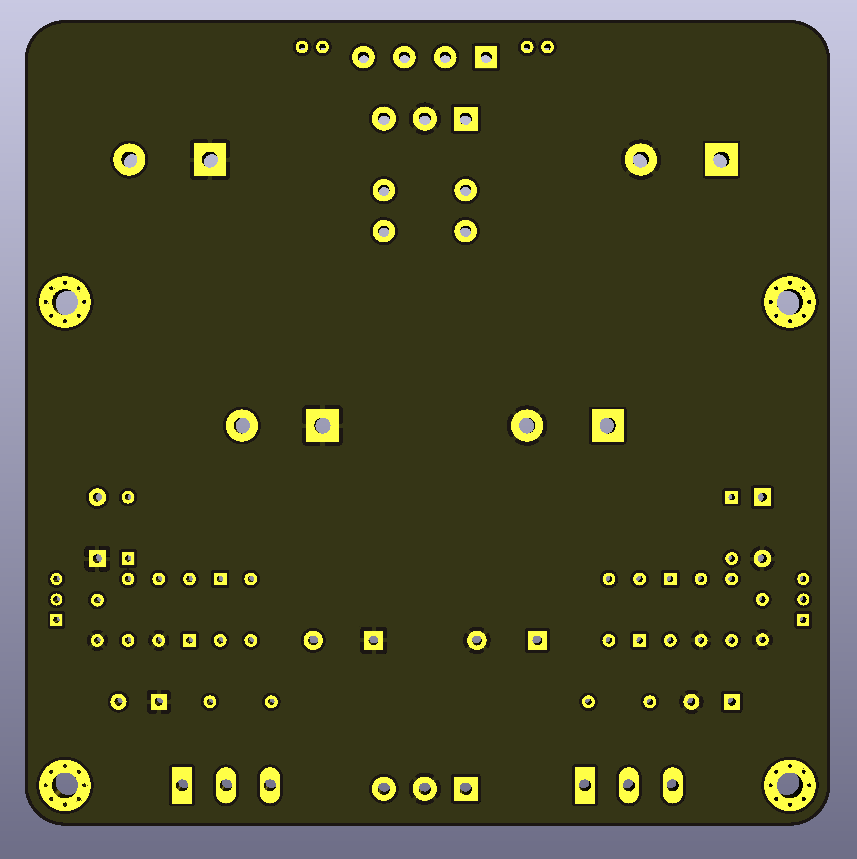

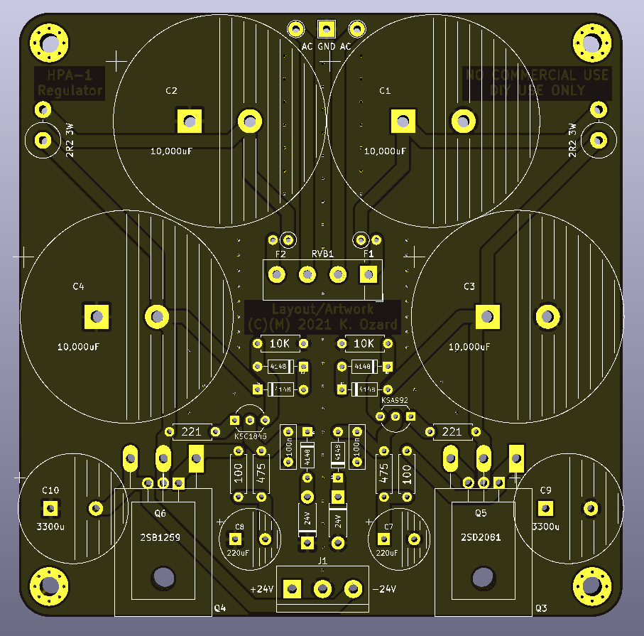

Worked on a draft version C (first images) and a draft version B.
Please make any suggestions for improvements. B might fit my chassis better. Version C incorporates more of the suggested changes.
