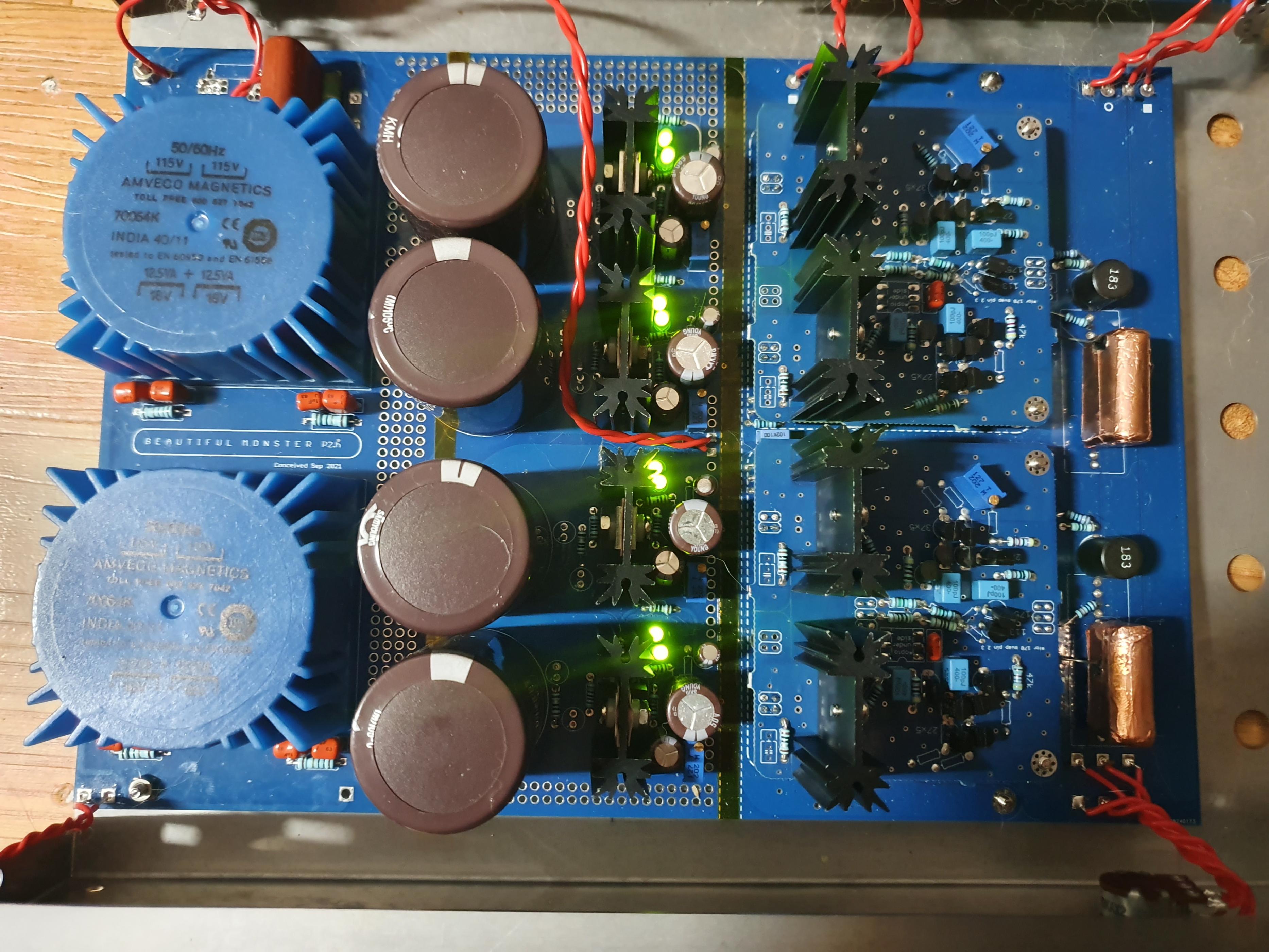

Could the outputs be bolted to a reasonable size aluminum chassis?
Is it about 2.4W each for the four output devices?
Hi Kozard,
That would be fine as long as the devices are properly insulated from the case and you use heatsink compound and or a silicon pad.
With 24v rails I would bias the amp for about 100 to 125 mA.

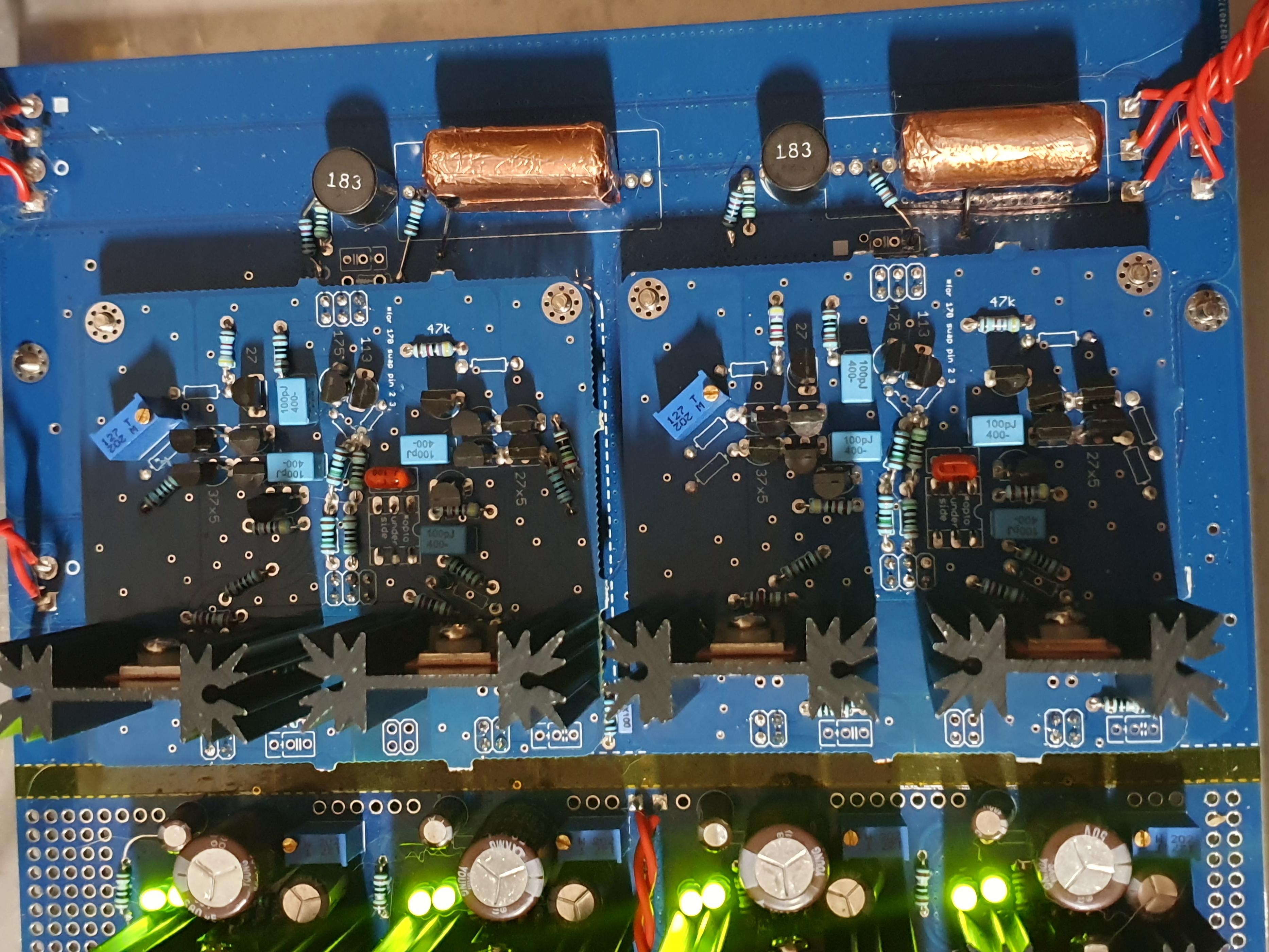

Heres my iteration of this wonderful circuit. Its for a dual mono modular preamp. I cascoded the mirrors with extra pair of bjts, all of em being bc337 327. The jfets are j113 175 and the mosfets 9610/610. Also i used the optcoupler bias circuit borrowed from the whammy headphone amp. I think for whatever extra distortion the optocoupler adds, the benefit of safely running higher bias is immense. Also added caps to drive transistors to slow them down a bit. Its probably not doing proper looking squarewaves anymore and instead rounding them off but the modules sound beautiful. Its a keeper for sure
Donovas,
Nice work. I must have take some work to get matched jfets . I would suggest
you try the j74 and k170 and compare results. The idss for the chosen devices was about 8mils but if you have higher values you can always adjust the mirror to compensate.

The FQP3N30 are back ordered at this time (Mouser). I was thinking of trying IRF9610 and IRF710 temporarily until I could get the FQP3N30 and FQP3P20. (From Digikey searches I am a bit worried that many FQP devices are being obsoleted.)
However when the IRF9610 arrived their Rdson and capacitance indicate that they are a much larger device (IRF9640 size) labeled as IRF9610. The IRF710 measure normally. The same order had IRF9610 and IRF9640. The IRF9640 were for a different project and the IRF9610 and IRF9640 measure exactly the same. That seller was ok in the past for other parts but you need to always watch out.
I have IRF9640 & IRF640 in my parts bin but I assume that the device size, Idss and capacitance are far too high for even temporary usage in the HPA-1?
My PCB have shipped so I should have them in about 3 weeks.
kozard,
The IR p-channel devices exhibit a non-linearity (well documented), and
even though this effect is less apparent when used as followers I would use the Fairchild devices if possible.
Temporarily the IR devices should work fine, there is enough current (18 mils) to drive the IR's. You might loose some hf response and have slightly higher distortion but no problem. Increase gate resistor values if you notice any instability.
