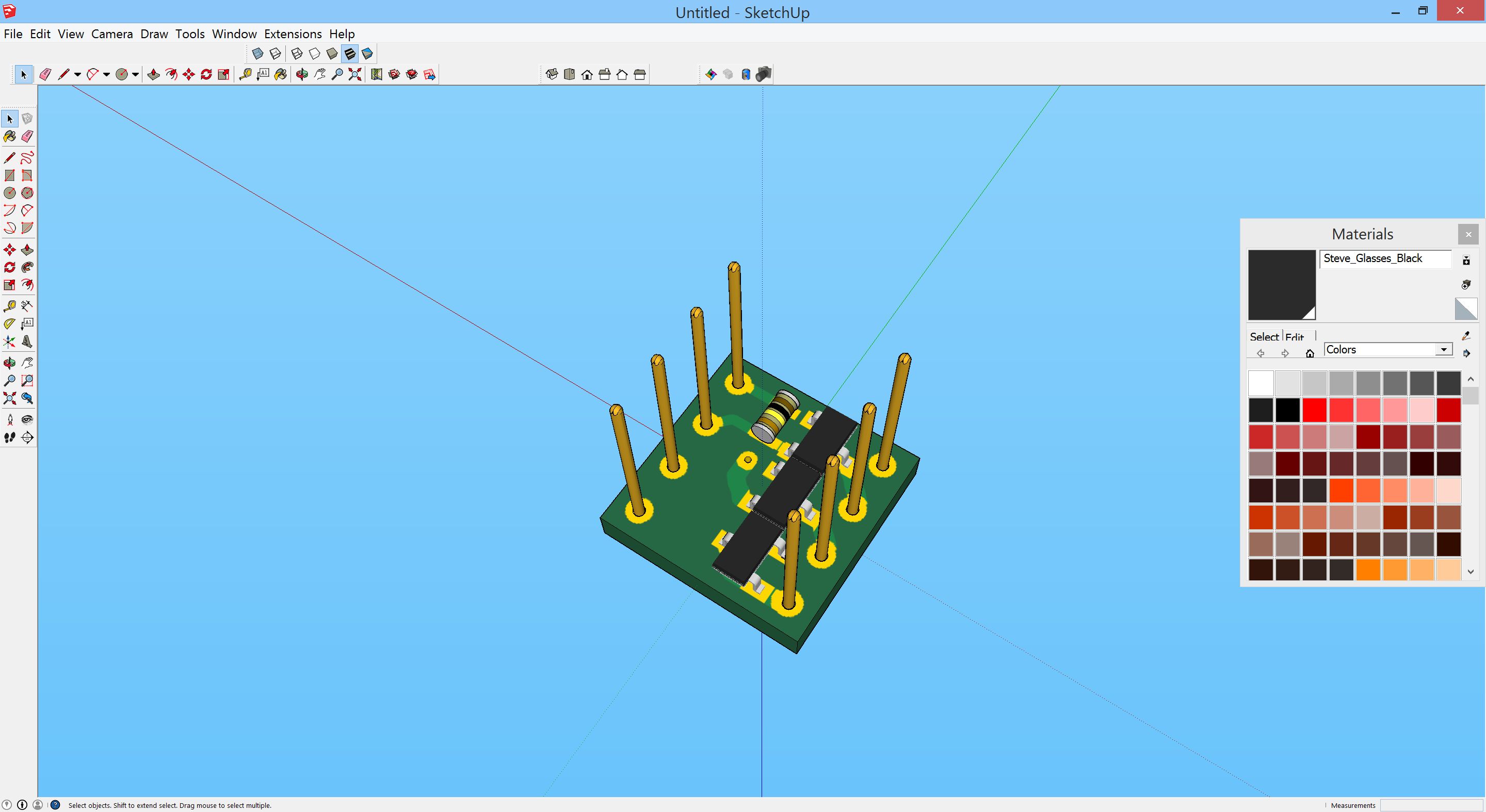

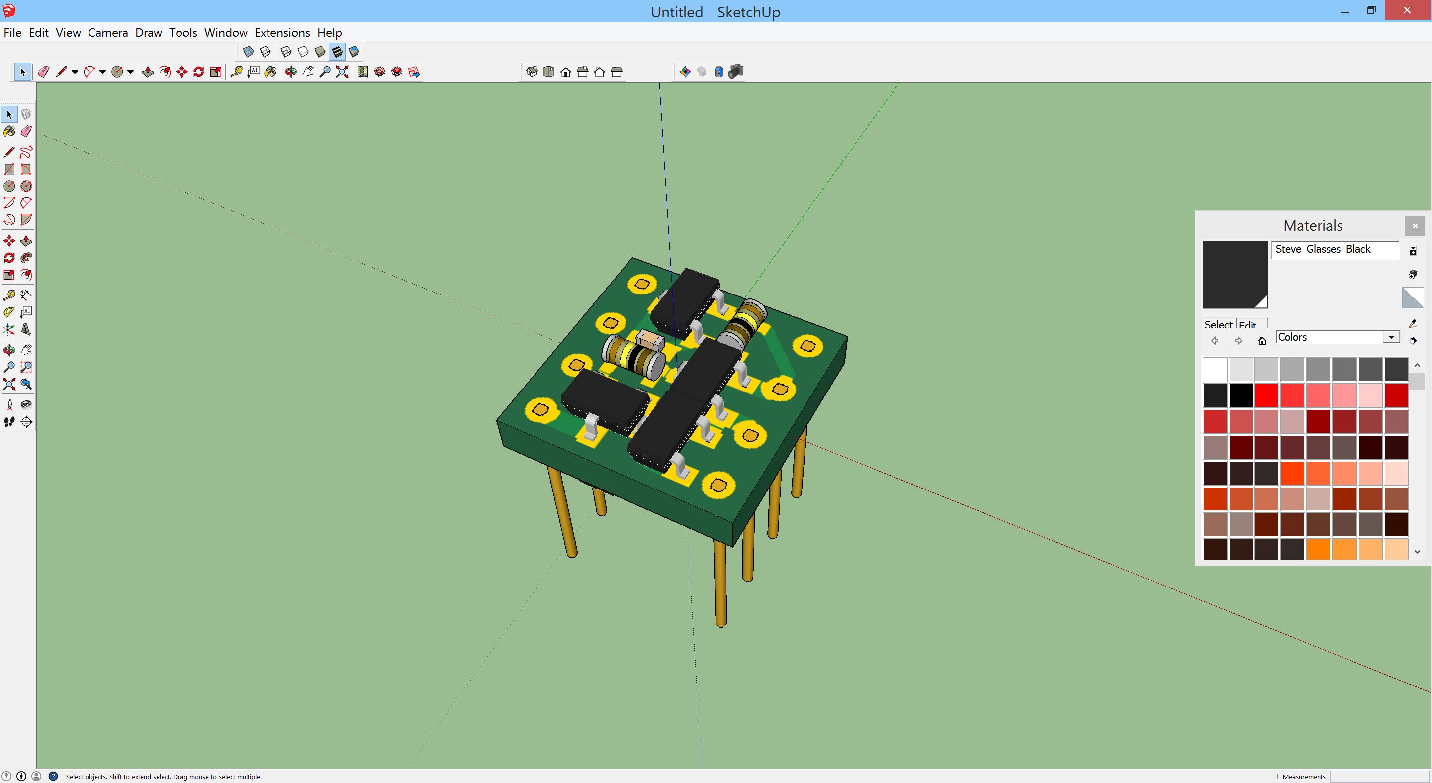

after seeing this topic i couldn't resist turning this in a DIP8 opamp:
Discrete Operational Amplifier
as its fully class A making it with smaller transistors limits the output current even worse.
I got a 7mA bias, so 1.5mA output is about the max, but it works, has the same pinout as an 741 and it was fun.
sorry about the soldering skills, had a bad day 🙂
http://img844.imageshack.us/img844/4522/dsc02197xc.jpg
http://img191.imageshack.us/img191/8581/dsc02199dl.jpg
resistors are 0603 and i used NXP BC857's, 2 transistors in a small sot666 package.

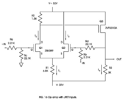

Please, show us a circuit of BF862 ?
If I have to do it again today, I would use 2SK209 / 2SK2145 instead.
BF862 has high gate leakage when Vds is >5V.
I still have no solution for the P-channel device, and also for the DC drift.
I would have gone for a LSJ74, but then they do not have them in SOT23.
Maybe you can try J175, but they are rather noisy.
Patrick
2SK2145 has no matching guarantee, though they track thermally better than 2x 2SK209.
Also the package can dissipate half the heat of a 2SK209.
For the first stage, the current is determined by the CRD, so the Idss of the JFET pair does not matter.
Perhaps it is worth trying J175 for 2nd stage.
Third stage current is a load / thermal consideration.
You can also make a CRD with 2SK209 using a suitable source resistor.
