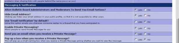

Thx Patrick,
I'll be patient. That BF862 GB never really took place, they guy who took over the executive part disappeared and was never seen again.
So luckily, there's no need to dig up a project with BF862 😉.
BTW: PMing you doesn't work, seems to be disabled.
Aaahh - I see
The classic PM system is generally disabled on this board, no matter what your settings are. "PM" on diya means sending an email through the forum, so you have to disable the "Hide Email Address" option.

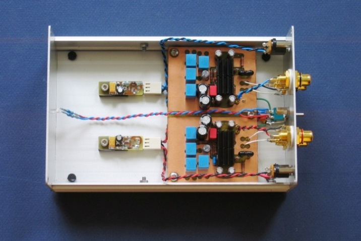

Buffer-Filter-Buffer Phono for MC
After almost a year's delay, and a change of layout to add source degeneration, the discrete opamp phono is finally finished.
The opamps now use BF862s for N-devices only, with varying degrees of degeneration. Thermal drift is a small problem in a high-gain (40dB) buffer that I used for the phono circuit, so some form of DC servo is necessarily. I simply use a cap on the feedback leg to Gnd.
I could have trimmed for steady state by adding a trimmer between pins 7 & 8, but decided that a cap is better in that I do not need to wait for steady state. But for the purist using the opamp for gain of 10 or less, there is little problem achieving single-digit mV offsets.
The circuit used was what I am using currently, as the exercise was meant to compare opamps in a specific application. The input stage is a non-inverting amp with a gain of 100, followed by a purely passive RIAA filter, and then by another buffer with gain of 100. In the reference built, I am using AD797 for the input stage and OPA637 for the output.
This is just a scratch-built, using a simple aluminium casing I have lying around, without much attention to wiring, etc.
The result : a very obvious improvement to the AD797 / OPA637 combination, especially on clarity, female vocal, string instruments, and placement.
All in all, I am very satisfied with the results, and should encourage anyone to give it a trial.
Patrick
Patrick

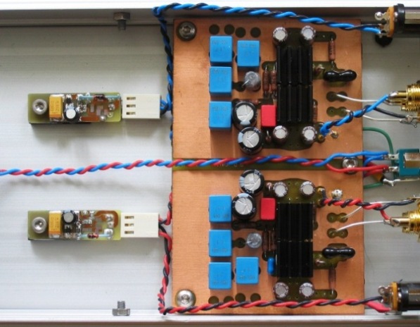

A close-up on the PCBs, showing a pair of 7812/7912 size and pin-compatible, low-noise-zener-based cap multipliers.
The external power supply is a wall-plug unit using 10VA toroidal Tx, BVV26C diodes, and a pair of 7818/7918 as pre-regs.
