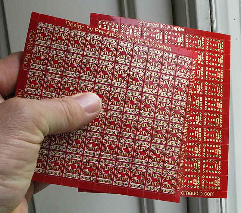

the first PCB I had made was this:
Not my design, but a little larger than the DIP-8. Open loop buffer designed by Sijosae, made to fit onto a DIP8. The layout was by "mono" at Head-Fi
I think quite a bit bigger than 10x10. Something like 16x16?
A 10x10 footprint would pack 4x TO-92 max, and perhaps has room left for 1 more resistor.
Still, good effort.
Patrick

12.7x15.2
As I said, I just took a layout and put it on PCB. Looking at the PCB now, I know what parts I could change to make it smaller. Half the parts could go SMT.
How about 13x27 for a full USB DAC? I have the board, but still have to build it to validate.
