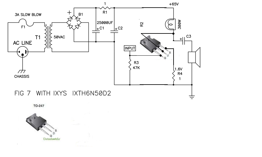

Well, I have studied the schematic and my board countless times and it is definitely wired correctly. R1 does not appear to be dead and measures 1 Ohm. I need to measure the voltage going to (and across?) the IXYS. Where is the best place to measure?

Hello ,
if the Mosfet is ok , across R4 should measure something like 1,6 or 1,8 Volt depending on the values of Vdd and the light bulb .
To test the mosfet , measure the resistance between gate and source , and viceversa , if it is something like infinite or Megaohm , it is ok .
Also , do not insert the lightbulb when the amp power supply is turned on .
Check also R4

Just to clarify, the resistance between G & S is taken with the power off.
"do not insert lightbulb", you mean R2 or lightbulb safety lead?

To test the the Mosfet , at least the Gate must be disconnected from the circuit .Just to clarify, the resistance between G & S is taken with the power off.
Rob.
For the second q ,I mean R2 . Still I don't know what the lighbulb safety lead really is ... or what is its use in this contest .

OK. I have measured between G&S with the chip disconnected from the circuit. I have measured the resistance (Ohms) and I am getting no reading at the highest setting
(20M)
(20M)
That's good ! 🙂OK. I have measured between G&S with the chip disconnected from the circuit. I have measured the resistance (Ohms) and I am getting no reading at the highest setting
(20M)
That's good ! 🙂
OK. So waht do you think I should do next?😀
Check R4 ( use the big heatsinked one ) , rebuild the circuit from scratch . Since the mosfets are ok , there is not reason it'll not work . Check for currents in the actual circuit , also in the mains . Something should be wrong , and preventing the turn on of the amp.

I used the IXTH6N50DN for these boards. I will re-build them and see what happens. I also have some IXTH20N50 chips and may make up some boards for those as well.
