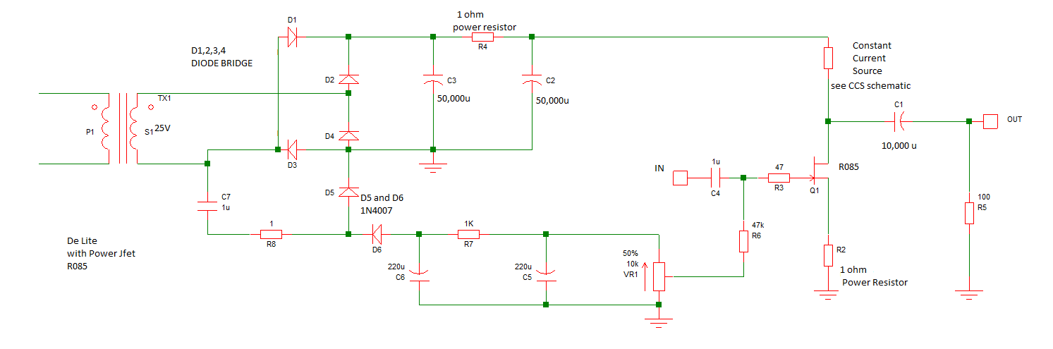

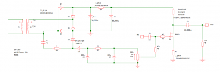

a new one , mainly becouse of the way the negative voltage has been apply from the original power supply, thank you Mr Pass for the ciruit . With lightbulb , with ccs of page 61 , or also a ccs with fixed current ( to be tested more ) where the -V at the gate decide just the Voltage operation of the circuit ( typical half -the rail ) and the current through the Jfet remains the same .
New Schematic with R085 Power Jfet
Here it is , that is how I built it , for the ligth bulb version there are obviously some modifications in the Power Supply .
I left to the current source to be drawn since there are various permutations for it .
Enjoy .

Cool, I am dumb - this version allows you to tap off the PS to get a negative voltage I presume, without another bench supply?
What have you settled on roughly for negative gate supply voltage?

Yes it does that .
The negative gate voltages varies , depending on the current source implementation , the voltages of VDD , and the current throug the Jfet .
Now with fixed CCS of 1,4 amps for example , VDD = 30 , Drain of the Jfet at 16 volts , the gate to ground voltage is - 3,5 volt

BTW- The negative supply doesn't need to be high current, correct? It only needs to be a fraction of the Drain current, yes, no, maybe so?

Little current , 1,3 mA
