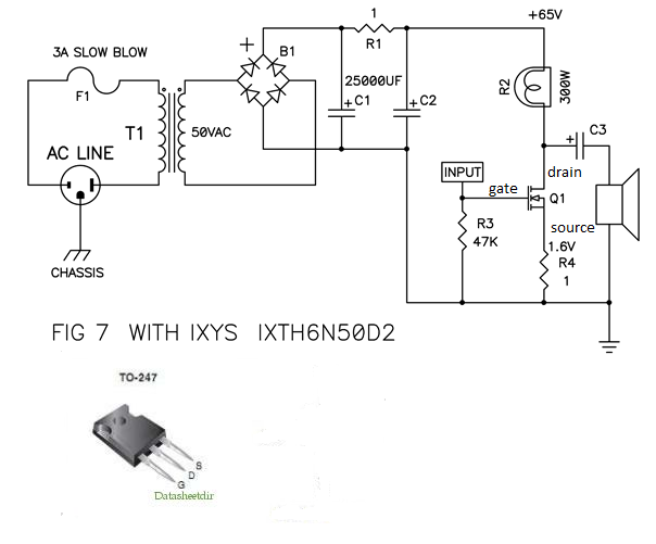

Next question. In the schematic in post 715, is the TAB of the IXYS shown by the solid line to the left of the 3 borken lines?

Hope this helps , the metal part in the back of the Transistor is connected to the Drain pin .
yes - and you must have insulator between metal part of transistor and heatsink
as insulator use ready made mica or silicone pads

Yes, that's what I thought. Thanks for the confirmation. So, I appear to have it wired correctly.
I am getting 82v to the bulb, but it doesn't light and the safety bulb mains lead glows brightly when I insert the bulb, suggesting a fault. Everything is ok until I fit the bulb. Bulbs are 300W - 130v.

The big 1 ohm resistor that stands for R4 ( 50 watt I guess ) is it connected to the chassis ground ?
The metal cased 1 ohm resistor is not wired up at present the PS is a CRC with some wirewound resistors. I was going to use these if the others got too hot.
OK , what is there for R4 ? I am using 30w metalfilm on heatsink
R4 is the wirewound resistor on the amp board with IXYS.
that is probably too small in power to be working well , or at all . Check it , it may be broken
OK. What does rating does Nelson suggest?
Can't remember right now , the circuit will need 10W min.

P=I^2 x R
if current is , say , 2A then - dissipation P= 2^2 x 1 = 4W
that calls for at least 10W resistor ; preferably heatsinked

I think there may be some confusion on the Gate & Source. What looks like an internal connection between the gate and source in the MOSFET graphic is NOT an external connection. The source pin should ONLY be connected to R4.
