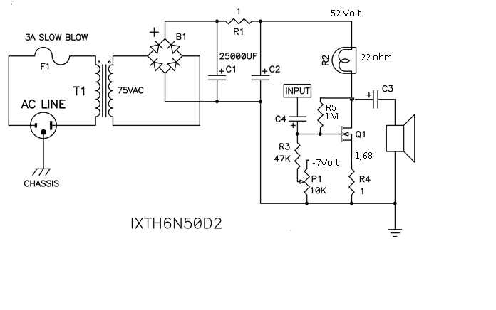

Below , in the attached schematic , I have another example of personal experiment , little feedback loop , negative voltages to set the working line .
During the listening I've found that carefully trimming p1 to obtain -Vgs = V on R4 the amp started to fly . While with differen values the sound is more boomy on the bass and less precise on the highs .
I wonder if this thing is effectively important or just the result of this particular implementation , considering also that my speakers are set up with a current source equalization .
(V at the drain of Q1 is 13,7 Volt.)

Stefanobilliani,
IS Q1 a R085, or the IXYS?
Also, is 1.68v over R4, or is that R?
I think your saying - measured vgs (measuring at gate and source) should be about the same voltage as measuring voltage across R4. (?)
Tea

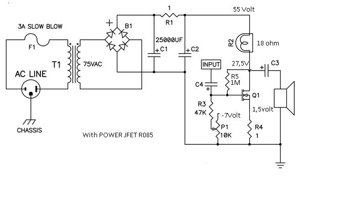

Yes in this example it is IXYS . I did something similar with the R085 .
Yes for second question : 1,68 is the voltage across R4 .
so Vgs ( wich is negative ) is trimmed for the same voltage across R4 .
I don't imagine why , but the fine tuning gives instantly better sound .
The R085 is ... different thing , sound much better musically ( the bass much more articulated , the midrange sweet non agressive , highs good )but <maybe> a bit less easy to live with ... ( and here also don't know why ).
I might probably investigate better on the audio source , since I have very good computer software handy .
... and of course , the main difference could be the light bulb , and the loading lines . Infact I found in the IXYS case the light bulb to be equivalent to 22 ohm ; different in the R085, it goes to 15 ohm ...
