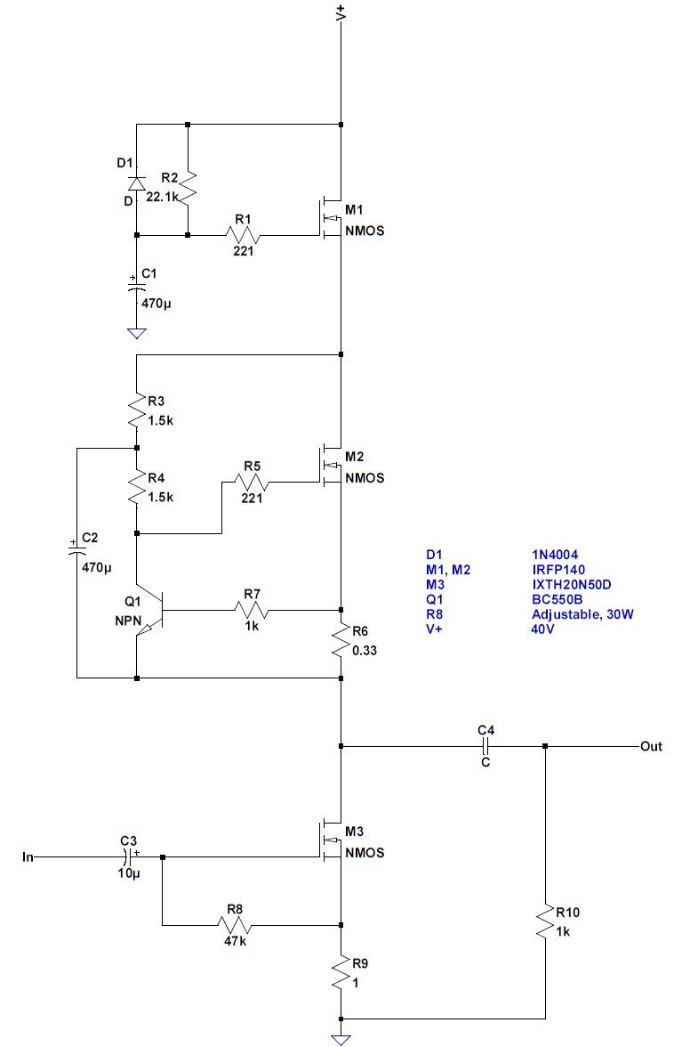

Stefano, I'm looking at that diagram and seeing how the drain voltage is set. But I'm getting about 20V at the drain any way. Hmmm... 🙁
You still think that your CCS is ok? 😉
Well, maybe not. Here is the schematic. I've used the parts at hand. Components that have different value compared to fig2. in ZV9 are: the two 470uF caps, the NPN transistor is BC550B and the MOSFETS are IRFP140. I think all substitutions are ok, but let me know if they are not.
The CCS current is controlled by the source resistor on the second MOSFET - R6 in my schematic. The NPN transistor develops 0.66V across it and so, a value of 0.33R means 2A current. This is what I had set it up as. Changing the value of the R6 should give me different currents.
I drew this up in LTSpice, so if you guys have models for the three transistors, that would be great.
I don't see any bias for the Fet. You need about +4v from
Gate to Source, often provided by a resistor from Drain
to Gate and divided by resistors from Gate to Ground.
The bottomost FET is the IXTH part and the top 2 are IRFP140. I thought just replacing the light bulb with a CCS would work and it won't need a special biasing arrangement - like used for the FET in Zen-lite. And I used the CCS from ZV9. Is there a simpler route or am I missing something obvious?
Thanks for help, Papa. Greatly appreciated, as always.
You need a method of balancing the currents of the two,
otherwise the Drain voltage will be either full + or full -.
The Lite bulb is a resistor, so it tends to self balance.
How about a resistor from the drain of M3 and a trimpot to ground, and disconnect R8 at the source end and connect it between the resistor and the trimpot.
Just like R14, P1 and R15 in the Zv9 schematic.
If the CCS draws more current than M3 then the drain voltage of M3 becomes to high, if it draws less it becomes to low.
