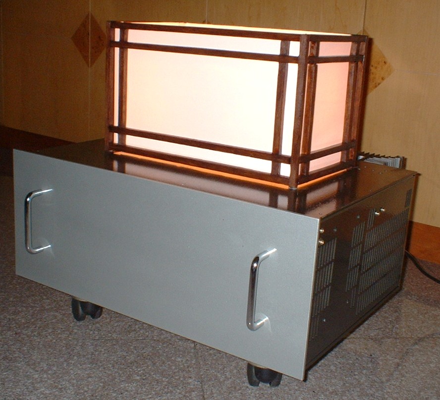

A diy Japanese Lantern sitting on top of the Jfet Delite Amplifier.

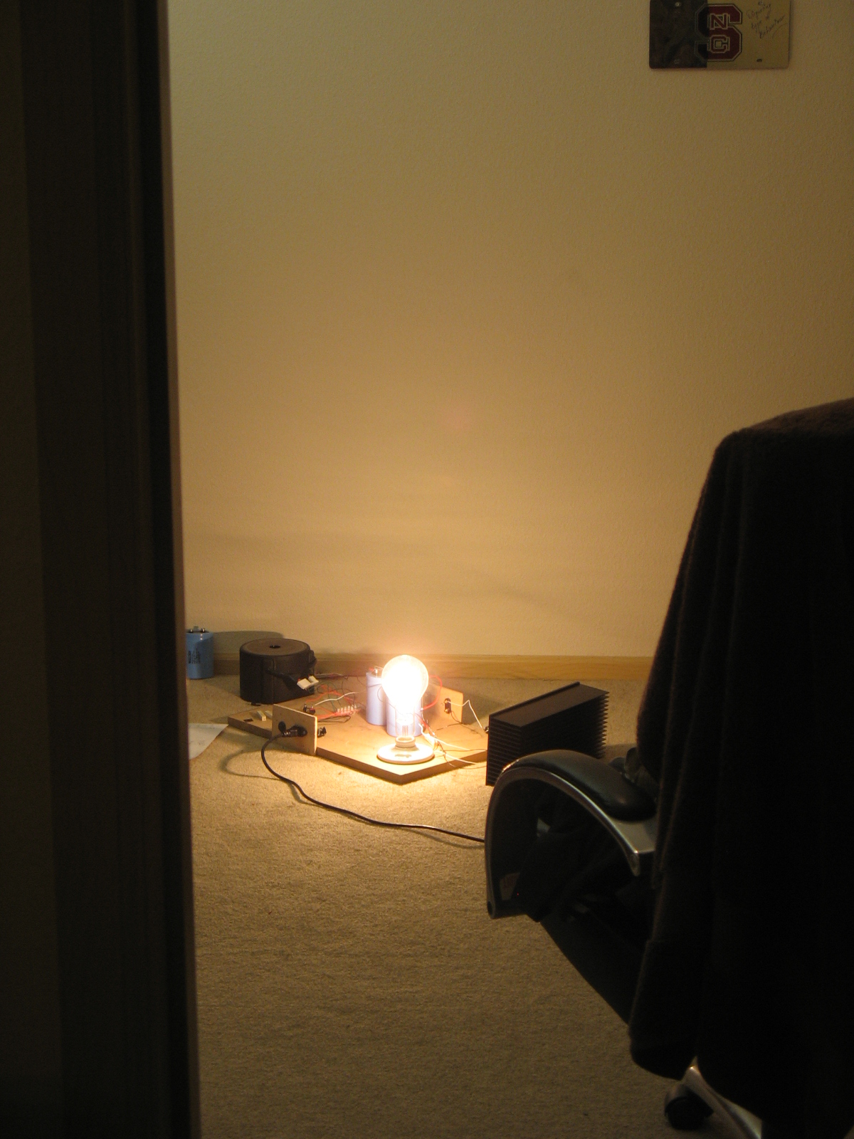

The De-lite lives. Nothing blew up the first time I turned it on. Not a bad sign.
But the voltages don't check out. First off, I'm getting 17 VDC on the output, despite using a 1000uf, 63V cap. The current draw is 2A, supply voltage 100V, approx 70V drop across bulb, and only 17 V on the drain of the FET. I'm using the IXTH20N50 part. Both the 1 ohm resistors are getting crazy hot, the heatsink is warm. The circuit is the one in Fig 5 on the article.
I'll be troubleshooting tomorrow. Any ideas?

Use 30w 1 ohm 1% resistor and heat sink them .

Thanks Juma and ZM. Yup, its working now. My first amp! Yay!! Its got the characteristic Class A midrange warmth. Although, I do hear a little distortion, especially on crescendos.
I have to say though, there is something about the whole "bulb" idea that is very beautiful. To look at that thing producing music and light at the same time is quite awesome. I had got a chipamp running for a few minutes some months ago, it sounded good, but it didn't make me happy like this one does. I feel like I understand this one much better and could probably fix it if something went wrong.
