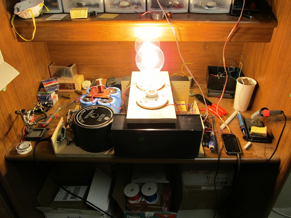

Hey guys,
I finished rebuilding my Delite. Attached are some pics. I've tried a CLC
supply with some random inductors that were lying around. It sounds
much much better with a CLC than a CRC.
After a really long time I was actually getting lost in the music rather
than listening for usual audiophile things. There is something about
single-ended feedback designs that renders our THD meters completely
useless. I have a MyRefC that checks all the boxes and has much lower
THD, but it is not even half as musical as the Delite.
It did sound 'soft' like others have expressed here... it seems to me that
the treble is rolled off. What would cause this? For the output cap, I have
a 1,500 uF Pany paralled with a 1uF no name.

In actual tests it is quite fast. It is important that you drive
it with a reasonably low source impedance - no volume
control pots feeding the input.

Got the xfrmr from a guy here.... generates 100 V and is perfect for this project.
I'm driving it directly from the CD player. It actually didn't sound soft on the test bench when driven from an iphone.

Ok... the drain voltage had dropped to 14V when I moved the
amp from the test bench to the listening room. To fix this, I used
the schematic from fig.10 in the Delite article to adjust the drain
voltage and readjusted it after half an hour.
This cured the rolled off treble. The edges are still rounded, but
that's probably the single-ended nature more than anything else.
