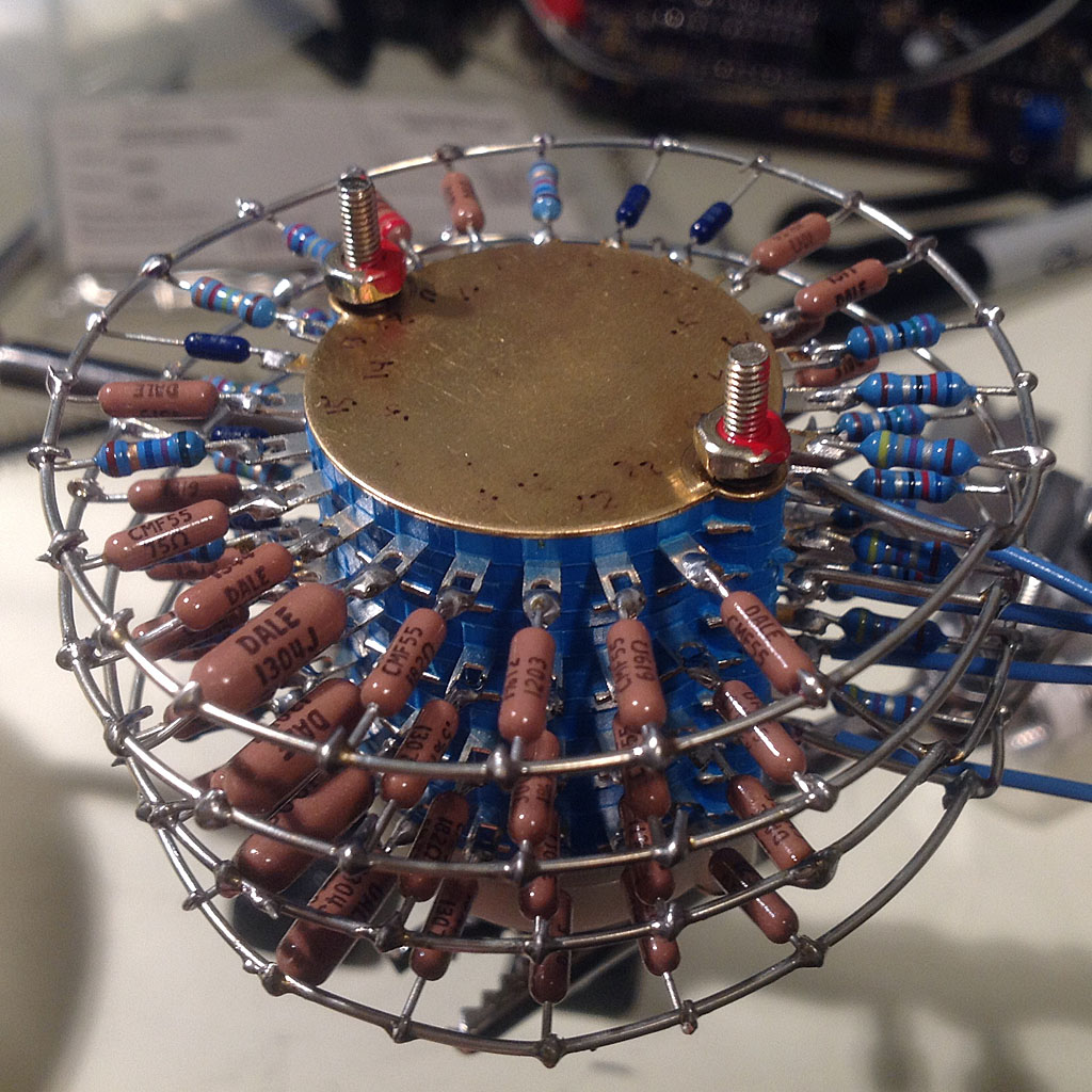

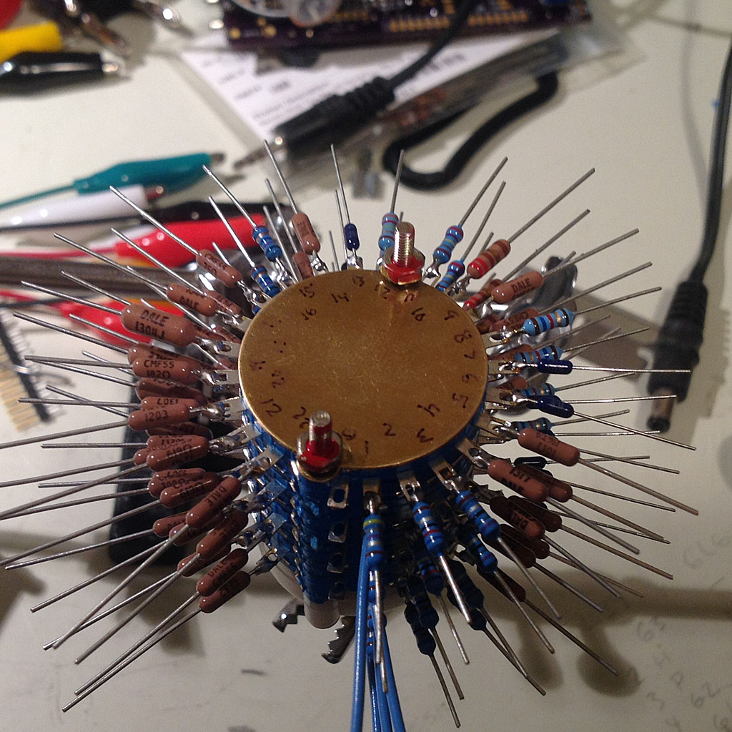

Stepped output attenuator for my 1.7. Such fun.
