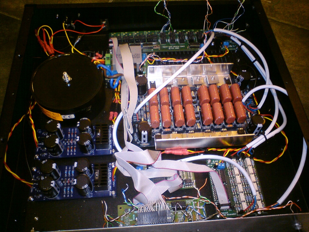

Im needing a balanced line-level output on the back of my preamp. This is important to me.
Ideally, this line out will be after the input switching and before the gain stage and volume control. This would enable source selecting but avoid unecessary gain or attenuation.
The purpose of this is line out is to patch my sources to my headphone amplifier for night time listening, and use the aleph as a source selector only, mute the speakers, and listen to headphones only.
I believe the attenuator im using has a mute funtion built in (joshua tree) ... Which would permit speaker muting, but im not sure if it is 100% muted. Im assuming it is at the bottom of the volume knob.
What would be the best way to wire this line out?
A) just split/tap the lines comming out of the input selector before they enter the gain boards and send each channel to a balanced out chassis connector directly. (Does splitting the line input have any possible drawbacks?)
B) insert a relay based switch in the line (instead of a tap) between the input board and the gain board, to allow selecting line out or pre out, or both. (Does adding another switch to the line in have any predictable negative inpact on sound quality?)

Imho I would run it like a pass trough.
All the inputs to the hinge of the relay, when the relay is off it goes to the 1.7.
On, it goes to a seprate set of xlr output.
By doing this you won't be changing the impedance the source see's.
Someone correct me if I'm wrong, but by tapping off it could half the input inpedance the source see's

Thats what i was suspecting... Im leaning towards option two because of that. By adding a switch i can select the destination of the signal and not just rely on volume knobs to mute either the headphone amp or the speakers.

Yah, I agree.
I did somthing like that for home theater.
I wanted to use the same amps for Fr/Fl that I would for lp quiet time spinning.
So I did 2 xlr and 2 rca in and a HT in rca.
Out I've got 1xlr 1rca and the pass trough rca.
I did the relays so if I turned off the 1.7 it would still pass the signal also 1 of the clicks on the input knob will also make it pass ht too.
I've got 10 total relays 2pole. 9 in the signal path.
Works like a charm! With test tones.... I haven't hooked it up to my HT yet but I know it passes audio like it should.
The 2 chan has been tested allot! Love it!

ive been there with the caps! trying to make them fit.
What did tou end up doing with the caps? Im thinking i might order a prototyping board and mount it above veterans board. I got the input caps on by wiring them over the sides with some left over leads clipped from some heavy resistors... It's the output ones that are a challenge.. id like to find something elegant if possible.
Did u use the same mkp4s as i?
I like the sounds of your aleph setup! Ive elected to copy your idea with the relay based gain selector... Just received some spst relays, a pair for each side. Those should wire in no problem. ill have to mount them off board but thats ok..
i did at first. i stacked them three on top of eachother on there side. then used solid wire for longer leads.
then i god some nice foil 30uf caps and stood them on end.

i did the gain selection on a daughter board, right off of the main. you know what, ill send you some pics. right now.

Im building the 1.7. It's coming along nicely too. About to start point to point wiring relays for the source selector... Its daunting... Gonna be a long night of work!
how did the voltage drop on the relays go?
