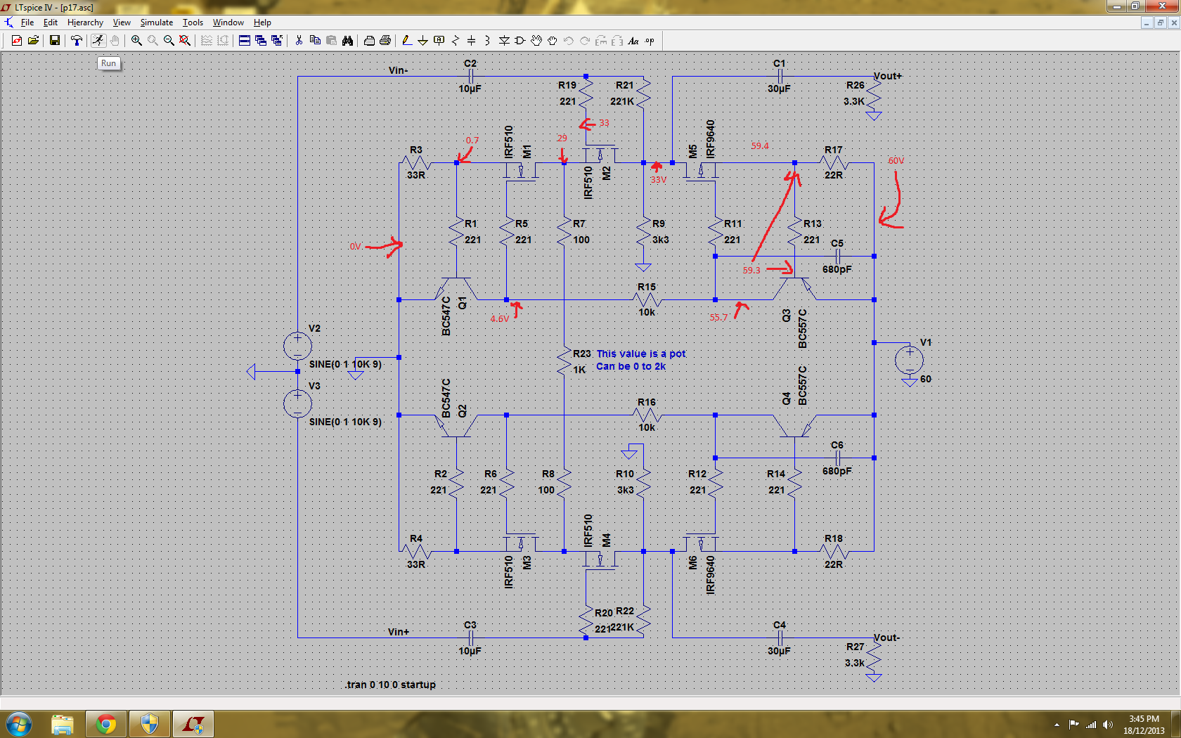

and if it would help I could sim the circuit and find the expected voltages at each node - would allow you to see where the fault lies.

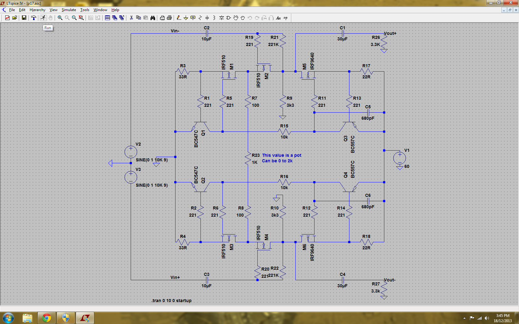

@Sakellogg - I'm a complete tyro. I started playing with LTspice because a few really interesting discussions took place around designs and I wanted to try and understand what was going on. As a self teaching tool it's been pretty good - but to answer your question, I have no frame of reference LTspice is pretty awesome (and free! FREE!) and you can do amazing stuff with it. Like feed a sim a music file, have it sim your amp playing it, and playback the wav file after the amps influence. I'd recommend it.
@FormosaWest I'll try to finish the sim tonight - hope it helps!

I reckon thats close enough. The mosfets in the sim are as close as I could find to 610/9610's and the circuit seems to work as expected. The numbering of components is completely different, so you'll need to work out which component is which by yourself. However if you look at the schematic I tried to draw it out roughly equivalent to the veteran schematic so it should be easy enough to work out.
If you sim the circuit (the wee running man symbol) and then mouse around the nodes, you'll get the voltage you should expect at each point.
Hope that helps!
Hope that helps!

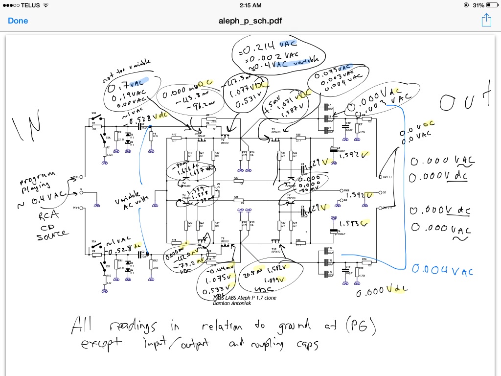

Ive probed some voltages for you to take a look at. Id love your thoughts. I hope you can see the picture. Im using a mac, so ill have to do some research about spice. Ive never used software like this since im very new to this hobby!

however, could you post the Drain to Source Vdc for each fet also? should be pin 2 and 3 or the tab and 3.
also, on the ztx's the collector to emitior Vdc too.
and here is why. ill do everything i can do to help but, im not the smartest dodo on the fourm, thats zenmod.
i need those readings in addtion to what you gave to start the trouble shooting and math i know. not to say someone more experenced wont see somthing i wont.
i dont mean to be a pain, just how my brain works.

OK, Sorry, I probably should have specified the preferred test procedure. Keep in mind I'm no expert either!
As a top line what we're looking for is the operating voltages of the pins of the mosfets. From this we should be able to work out the rest of what we might need to know.
First up, we don't need a signal initially - we're interested in the DC voltages at the pins. Ground the inputs - I usually just clip a clip lead between the input(s) and signal ground. Then get the DC voltage at each mosfet pin (be careful! don't bridge across the pins with the probe) and just give us those values.
Hope this helps!
Edit - sorry again, realized the pic was unclear, will remove and repost
Edit2 - fixed!
Hope this helps!
Edit2 - fixed!
Hope this helps!
Edit2 - fixed!
Thank you! Im definatly not getting the same values. Th epower supply is producing 60v but when its connected to the board it measures to 1.5v.

I just did a quick re-read of the thread and had a look at your gallery posts (nice btw), and I might just generally suggest a few things to check.
Before I start, I might just say that I'm both an amateur at this and tend to overthink problems, so I tend to try and eliminate as many other potential problems first...
Given you had a problem earlier with your power supply (and you appear to be reading 1.5V where you should be seeing 60V) I'd test your power supply(s) first. The p1.7 should draw about 70mA (I think - this data is from the sim), so a 1K resistor would be a close dummy load. Note that this is nearly 5W of dissipation through the resistor, so you'll want a fairly hefty resistor. The power supply should handle this fine and you should see 60V across the resistor. If not, the problem is 'upstream' of the P1.7 boards (ie psu boards, power connector, dodgy connection, transformers, switches etc).
After that, check the mosfets on the p1.7 for electrical isolation. check to see that the tabs of the mosfets are electrically isolated from the heatsink you have on them. Probing for resistance between tab and heatsink should show an open circuit.
Shorts and bad solders? Have a good look at your soldering for any inadvertent shorts/dry joins. I found a lot of the pads on vets boards were pretty close together under the mosfets and I bridged a few of em when I first soldered them up.
If all this seems ok, then we can look for component failures...

Nice work! I hope you get to the bottom of it.
Again FWIW, matching parts is pretty easy, and it's handy to have spares when this sort of thing happens, so buy em by the 25 or 50 and save a buck or two... And then you have ammunition for the next project!
With regards to parts, my board is almost entirely populated with ebaY components and I've only seen a few fakes so far, and these have been for unobtanium parts or for large power BJT's. I tend to have more issues between my ears than I do with parts 🙂 For fun I've ordered a few probable fakes and enjoyed the process of trying to work out what the hell they were.
Anywho, don't sweat the matching or providence of parts for now - and I don't believe the ZTX parts are needing matched anyway (FWIW I'm using BC550's and I believe any small signal transistor will do), and irf610's are cheap enough to not bother faking.
At power off, there is 0.61ma current draw. at power on there is 0.00ma current draw..
This is the same with a dummy load on the power supply.
Im so confused.
Im desperately hoping its the mosfets, but i dont understand circuitry like you folks..
Im so confused.
