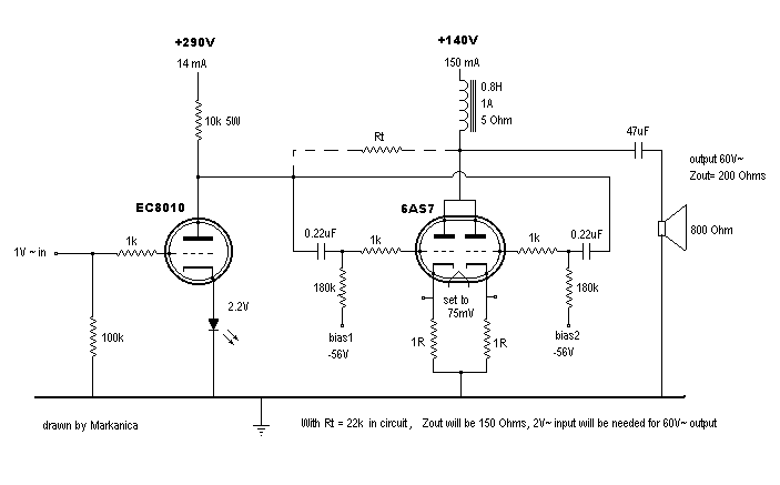

greetings all,
Yves and Alex thanks for your constructive replies,
Nice idea of using an SRPP here, but also I see the feedback resistor is returned to a lowish impedance, wich will fight the I to V conversion mechanism to a point. JB states in his article on partial feedback: "The key point is that the impedance looking into the convertor must be high, so as to give the grid the freedom of movement required to convert the incoming current to voltage."
This will probably better meet the required conditions of an I to V convertor. I want to try something like that as well.
Yeah, I see your point. I play with whatever I have on hand, so 6AS7 it will be for now.
In the current setup the drivertube EC8010 can supply the grid up to about 38V input, before distortion due to grid current starts. On its own, the driver can deliver well over 70 Volts!
The 6AS7 is biased at -56V, so more power can be had, but at a price. A much more complicated circuit, that can easily undo the magic that comes through as it is now! But I will know when I try.
Exploring possibilities of circuits is a big part of the fun here!
Thanks for your support . It's sometimes difficult to 'see' the workings of a circuit...so I will set it up and see how it goes.....
I'll post when I have a result...

Yvesm said:I've played too with various implementations of this design with more or less success.
Interresting results where obtained in using a somewhat classic SRPP configuration for the driver, feeding the grid of the output stage from the upper cathode and returning the feedback resistor to the plate of the lower anode.
The two cathode resistors of this SRPP may be made unequal, since the FB resistor adds current in the lower portion alone.
[/B]
Yvesm said:For now, it's what I plan to check using a penthode as driver and a -100v auxiliary supply.[/B]
Yvesm said:And ... euh ... the huge voltage drive needed by the 6AS7 complicates the problem more than a lot but I understand this choice is to cope with your speaker.
I beleive that the higest the Mu, the better for the power tube.
[/B]
audiousername said:Mark,
I think your schematic showing a cathode follower between the driver and the output valve, and a feedback loop from the anode of the output valve to the grid of the cathode follower would work. It's the only solution to the conflicting requirements of low output impedance for wide frequency response and high output impedance for high levels of local feedback I've seen. But now we're wrapping feedback around two stages instead of one, so we have to be careful about possible phase shifts and things because we have more components in the feedback loop.

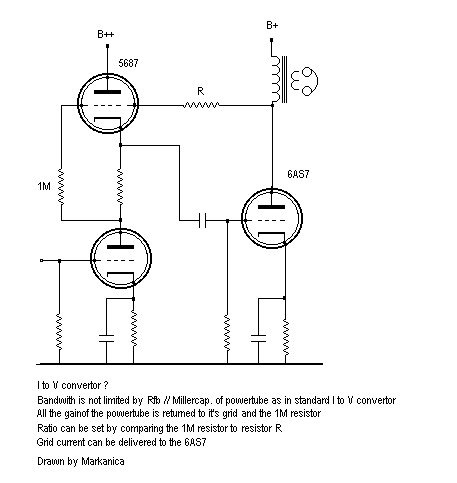

Hi All,
Yves, Alex and everyone else,
Can't stop thinking about alternative I to V convertors and since Yves started about SRPP I came up with another one... I'm not sure if it can work, but don't see anything against it
Sorry, I didn't do the math, never was good at that, altough I can read formulae... I mostly use my imagination...
Well, check it out and let hear what you think 😀 or

It's exactly what I've done ! With other tubes indeed 😉
Read back each world of my last post 🙂
Yves.
No need to smash me but I think_as a matter of fact I know_you can do much better than that in every single department:
Use an Aikido circuit for I/V conversion: you'll have much reduced cost, better PSRR, less distortion, no OPT to mess up the BW and

That whole AIKIDO stream of consciousness is a real gem, there is a LOT in there! Broskie strikes again.
Hi All,
Hi Yves,
So I did reinvent the wheel! 😀

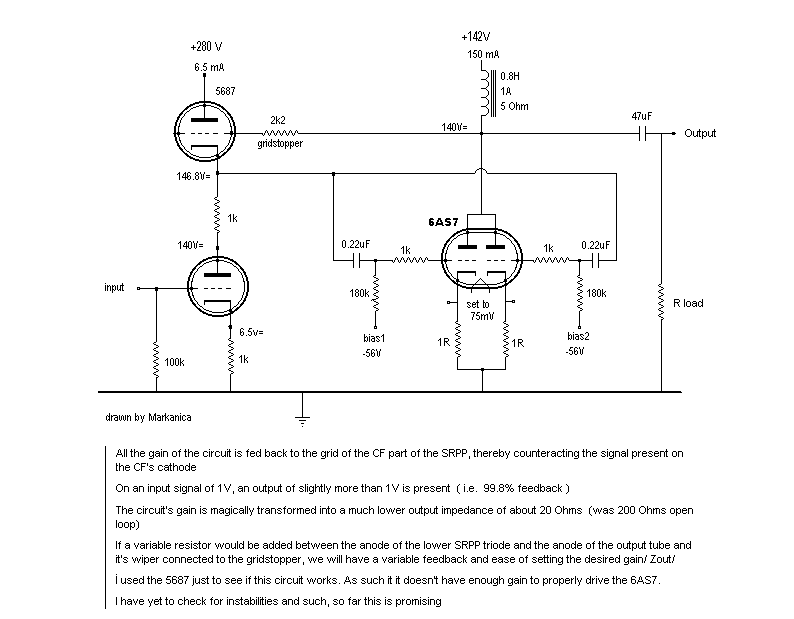

Actually what you wrote was the following:
'Interresting results where obtained in using a somewhat classic SRPP configuration for the driver, feeding the grid of the output stage from the upper cathode and returning the feedback resistor to the plate of the lower anode.'
Whereas I suggest to return the feedback resistor to the grid of the upper triode. You can check that in the image.
The difference is just a single connection but it makes a big difference in the workings of the circuit....
Of which I am really curious what it will do, or not do at all. But that's just me marvelling at my own 'inventions'
(or has this been done 50 years ago? 😉
I soldered it up tonight, spend some time getting oscillation out of the way. Oops, o..yeah, it's a grid with a 1Meg connected, quite sensitive. But haven't finished yet, still have to lift the 5687heater and it's getting late....
I'll get some more benchtime after tomorrow......

Hi Yves,

Hi Mark !
You'r right ! I didn't notice that the resistor from the lower grid to the upper plate was 1M 🙁 Looked too fast and beleived it was just a stopper, and this makes difference of course 🙄
Yves.
Yves.

Hi all,
Partial feedback to the grid of the CF part of a SRPP driver looks promising ! 😎
I checked today on the bench and it works just fine.
Have to see what its limitations are lateron.
See Att. image how I done it
Bye for now

Hi all,
Aleksander,
I wish you a quick recovery and good health.
I understand your objections, but still want to invite you to share knowhow, so all (me) can have a better understanding of what is going on in partial feedback circuits.
Hello Ian,
I looked over at the Turner website, and yes interesting stuff.
Seems to me that this guy knows what he is doing. I'll keep the link for reference, thanks.
I just lifted the heaters to 70V= and probably won't use mosfets as I killed too many of them just by touching...
As for penthodes, got some in the parts box and will try them if necessary, for now i'll stick to triodes....
I am exploring possibilities with partial feedback and make lots of mistakes on the way. I learn something each time, great!
The last mistake I made was to trust the readings of my DMM.
It can do AC readings, but at 1khz it already deviates. So I used a 400Hz inputsignal and assumed that would be ok.
The DMM reads an output of 1.04 V AC @400Hz, on an input of 1V exact.
This morning I repeated the measurement, but used a Tube AC Voltmeter. And got a reading of 100 mV output.
Back to the DMM again: 1.04 V
Took a reading again, both connected to input : 1V AC on both meters!
Both to output: 1.04V on the DMM and 0.1V on the Tube Voltmeter!
Checked the signal on the O-scope, looks ok.
Repeated the procedure again, now including the O-scope.
The O-scope confirms the readings i get from the Tube Voltmeter, the DMM is way off, but only at the output side. At the input side all readings confirm each other.......
Connected a cap between DMM and output to isolate DC (140V).....Yeah, that's it; now the DMM reads 104 mV AC
Learned something here!
Bye for now

Hello Ian,
Bye for now
